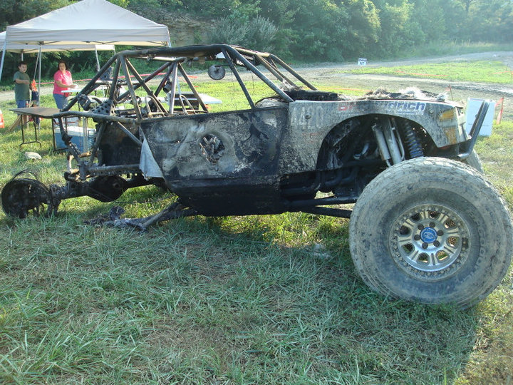

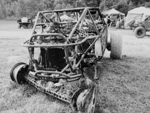

Stood on a mountainside and watched a $100k rig burn to this
BTW that was on a green... and the driver needed treatment for burns
Those back rims that are missing were aluminum and melted...

Those pictures are why I have started carrying two fire extinguishers... and not small ones either.

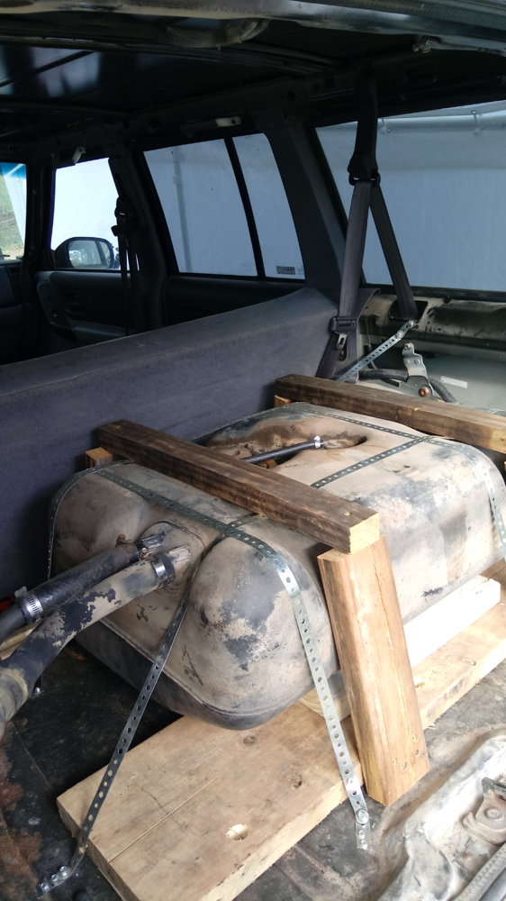

put a smaller Polly tank in. ...what the heck is that
This thread just took a wrong turn lol

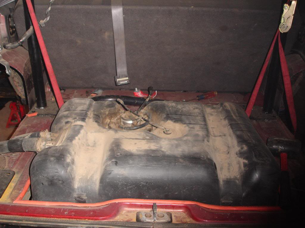

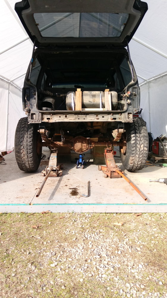

Well with as many straps as I'm putting on this tank, I think it will outlast anything else on the jeep. Putting 5metal straps..then one ratchet strap...then holding it in with framing...then build box around it
Space isn't an issue since I ditched the torpedo cannon!
Iirc we dumped 5 or 6 10lbers on that.
Fuel pump relay welded.
Every time fire went out the pump sprayed gas on it.

Okay put a smaller Polly tank in. No reason for a tank the size of a stock tank that you only use for wheeling. Save space. Easier to strap down. Stock tank isn't gonna be easy to secure properly, also won't be able to vent right so cab will fill with fumes.
I agree that a stock tank isnt going to be easy to secure. But I dont agree that a cell is safer than a tank when moved inside, if you secure the ports/vents properly. You haveto cap/route/vent the ports on a tank or cell securely either way. And, IMO, if you are putting it in a enclosed cab, it should have a cover/firewall. It really should have one, in an open cab/buggy, but fumes arent as bad with them.

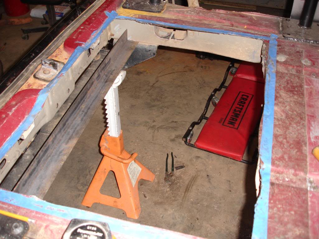

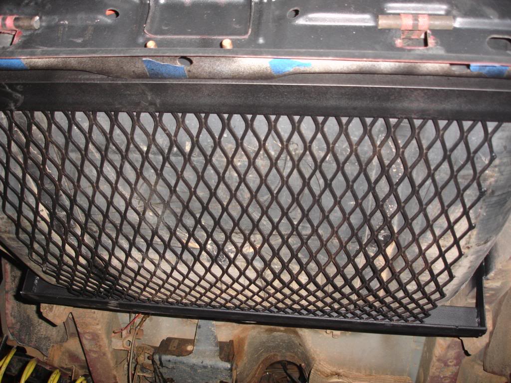

I would recess the tank into the floor to help support it. Similar to this:
Then build a metal box over top it.

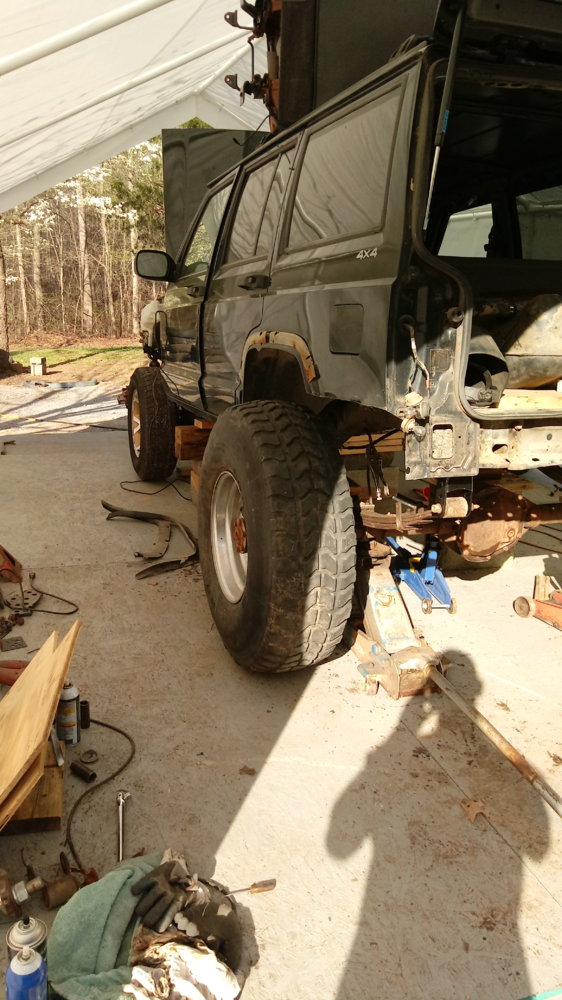

Ok got some work done this week...this sucks being so busy and taking a week to set one axle but its life...
Can anyone guesstimate the amount of lift by the looks of the rear. Fenders aren't trimmed yet and those are the 52"Chevy leafs...so far I like the stance and height seems good I guess...stable enough I hope with the wider axles than my last Xj...the gas tank is set for now until I figure out how I want to cover the whole section but its strapped in for sure
