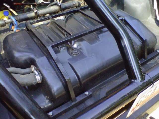

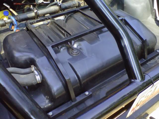

I'll add onto what @paradisePWoffrd mentioned. It's not "easy" to secure a tank but there's ways to do it and actually maximize storage.
This is how I did mine. Built an all metal fully caged clamping device that bolted to the floor. The structure as a whole could support my 175 lb ass so you know a cooler would be fine. Protected the tank, added much needed tie downs, added clearance underneath and has held up for almost a decade.

I'll add onto what @paradisePWoffrd mentioned. It's not "easy" to secure a tank but there's ways to do it and actually maximize storage. View attachment 244747
His I like a lot and its what I was thinking once I cut the roof and do full cage

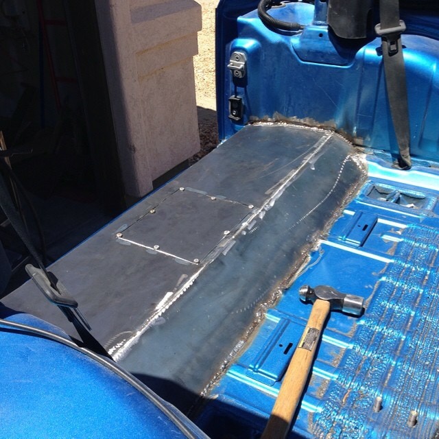

TJ tank doesn't fit in a JK, so I redid the floor. This cost maybe $20 in metal and bolts if that, and is a shit safer. Stop being lazy
this is really what I envisioned from the getgo is to cover the whole rear section with steel sheet like that or at least over the whole top of it and make a cutout like that to access the pump...thanks for the picture as I'm a visual learner mostly and that really helps me have the idea now of what I was thinking to do.:beer:
