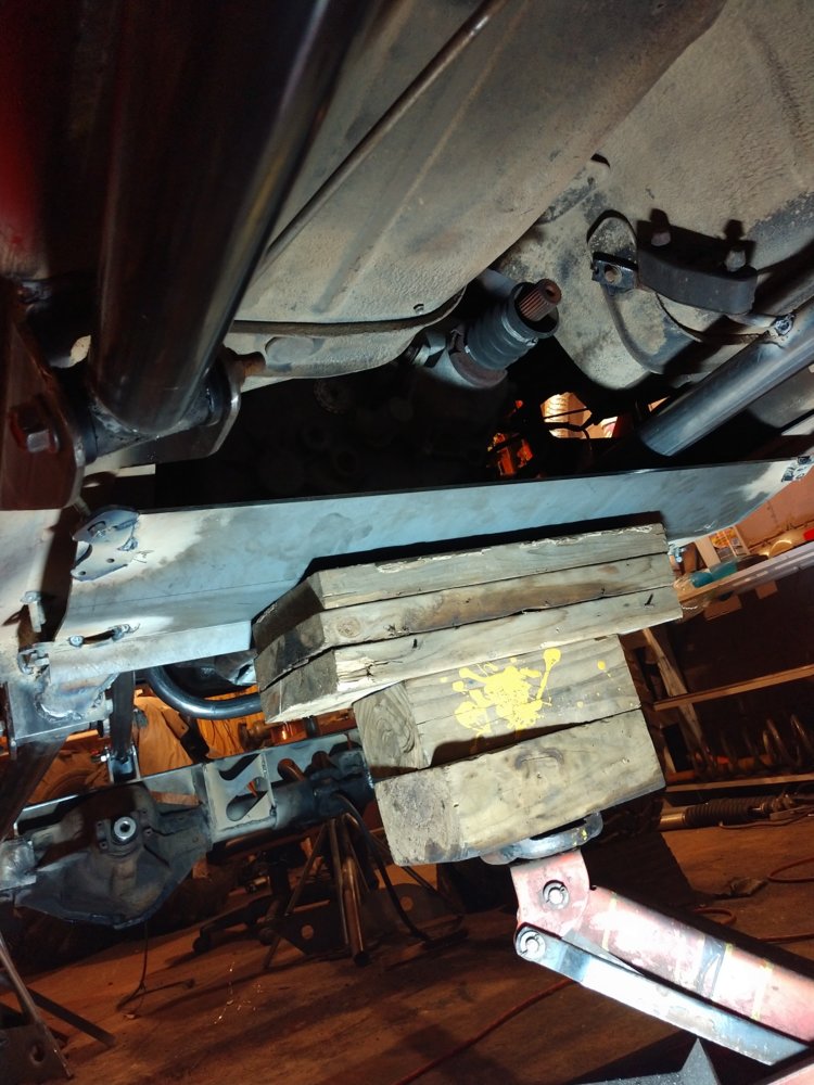

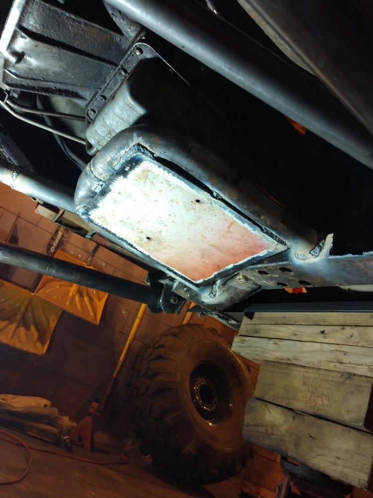

Well sitting low to the ground figured I better have some protection.. nice trans skid and big tcase...I actually made the big skid bolt on can you believe it

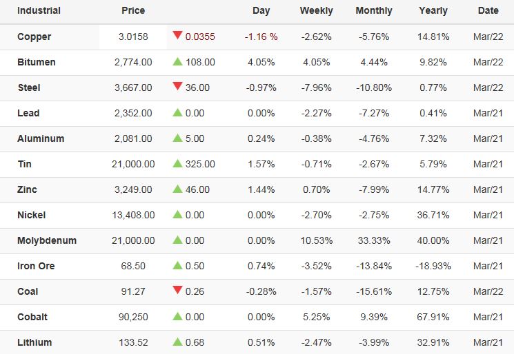

Well I might but it won't be Dom. If I do change it I'll go with 1.75 HREW. Soon I will measure every piece of cage and calculate weight. That I'm sure will help steer me in "a" direction lol. Price of steel just went up a lot according to the boss so Def not gonna be Dom but even HREW is pricey. We will see...

Well I might but it won't be Dom. If I do change it I'll go with 1.75 HREW. Soon I will measure every piece of cage and calculate weight. That I'm sure will help steer me in "a" direction lol. Price of Chinese steel just went up a lot according to the boss so Def not gonna be Dom but even HREW is pricey. We will see...

FIFY... :D
This was from today's stock reports.
