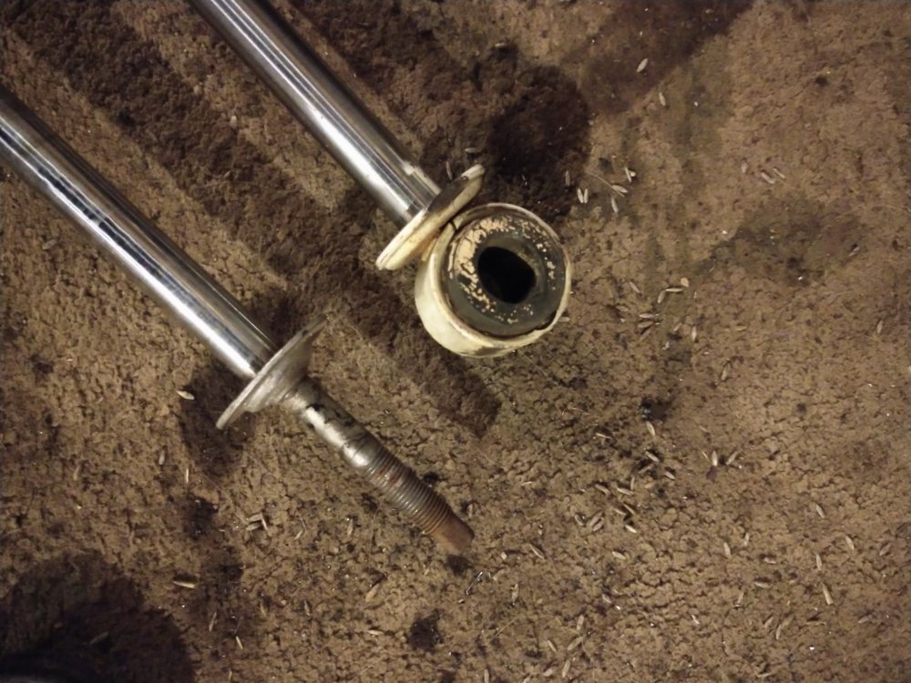

You need a much longer free length to use those shocks you have, or move the upper mount up.
Well, when you've got 580+ pounds of cage being the back 2/3 of the vehicle
Technically speaking it's only about 300lbs of extra weight from factory since it's completely gutted it's easy 250-300lbs of factory crap that got stripped out of it.
Is there any reason I can't cut eye off and weld a bolt to the top of the shock on top in picture to bolt it in factory location
