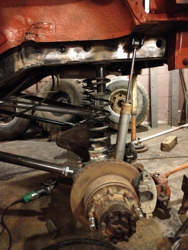

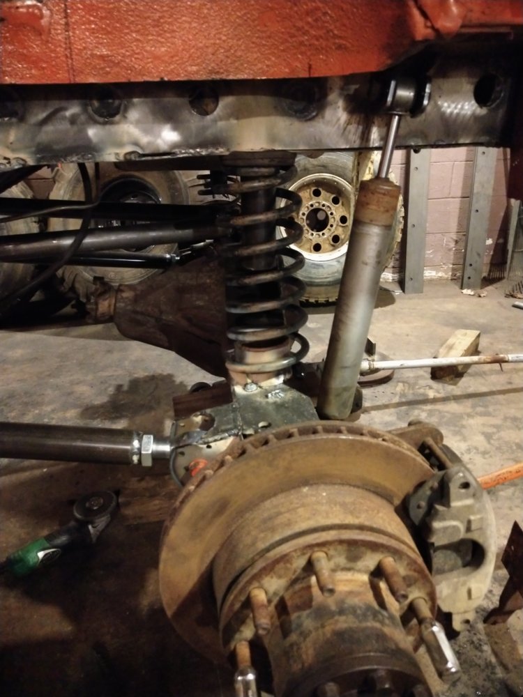

This is my full droop and at ride height...am I just being too obsessed now (doesn't look as compressed as I was thinking maybe?)

Just fucking run it and find out. You really need a taller free height spring so it'll stay seated at full droop, but give it a shot.

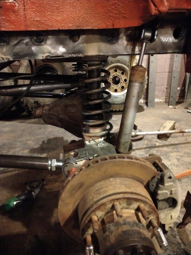

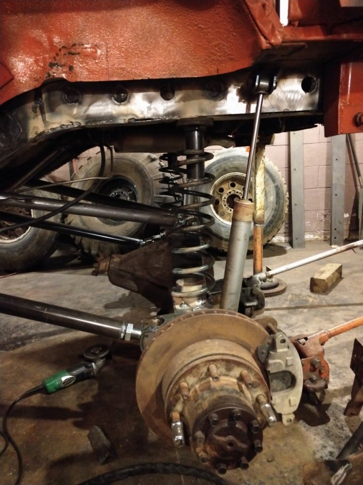

View attachment 265303 View attachment 265304
Don't know what you mean by "doesn't look as compressed," but it looks to me that your shocks are acting as your limiting straps while checking full droop. I'd disconnect those to check for binding. Checking travel for full bump/droop includes removing springs and shocks, and checking travel, both compressed and drooped, and articulating one side then the other. If your shocks are your limiters, I'd add a limiting strap in at each corner so you don't kill your shocks the first time out.
for now, will make some limiting straps too. Hoping to find/buy longer travel shocks as the 9" droop isn't enough for what I was wanting.
done it already when I first mounted springs, all was great. was really amazing how "free" moving the 4 link is/was (maybe cause of the Heims since I've always had bushings)
Looking at both pictures, and the position of the shock, my guess is you need more up travel to make the suspension work correctly. Maybe find a taller free height spring (as suggested) and move the upper shock mount higher. From what I have seen suspension that is closer to 50/50 up and down travel works better. Just a guess though....
i wanted that but unfortunately my lower links will only go up 3.75" before hitting frame which is fine with me. So I plan on getting shocks eventually and springs to have 3.5" up travel and 12-14 down, that's my goal.
