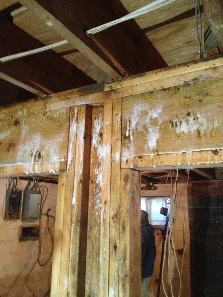

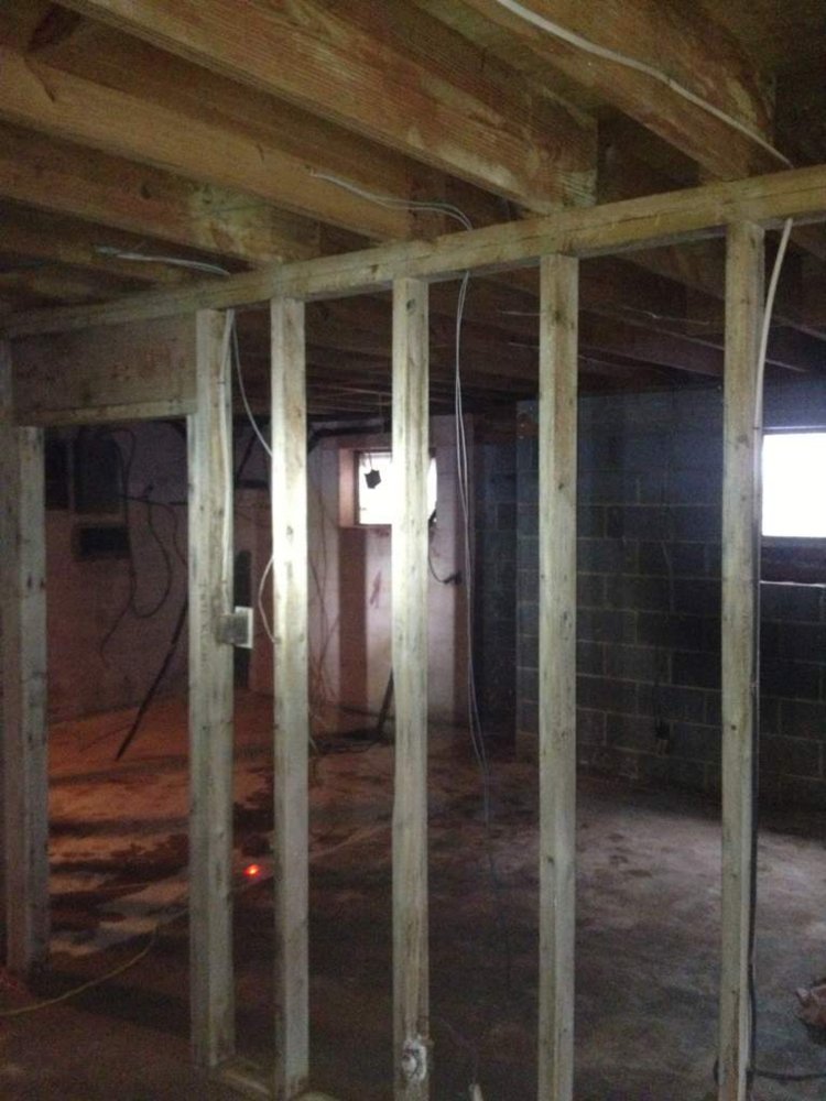

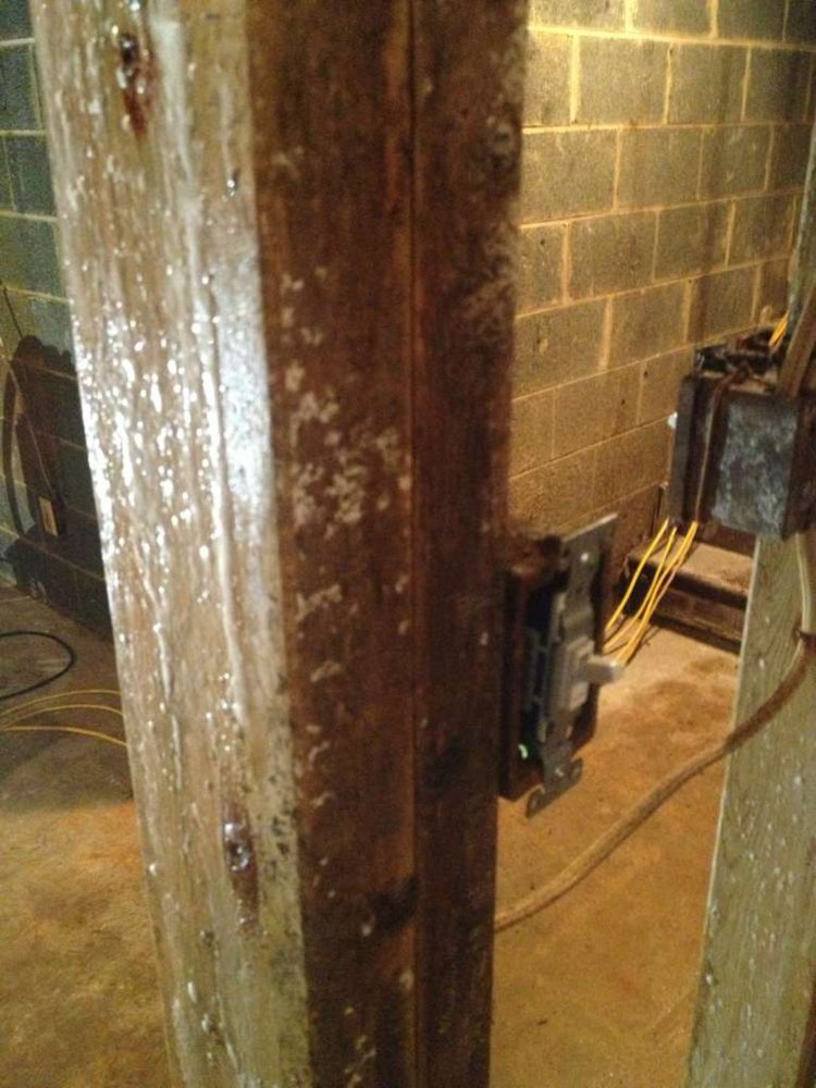

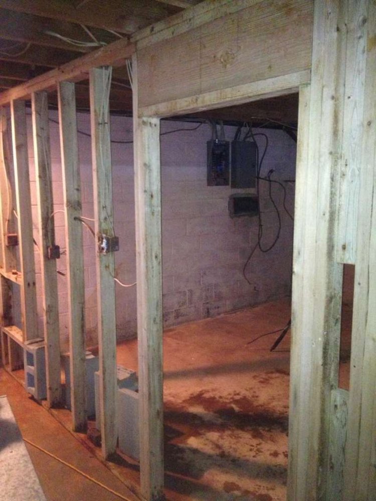

The floor joist are fine. We removed one wall due to rot. The studs on the wall seen in the pictures have mold, but no rot. They will be wire brushed and sprayed down with a very strong chemical we use. I personally would replace them. But my project manager did not agree with me in my original plans so we are doing it his way.

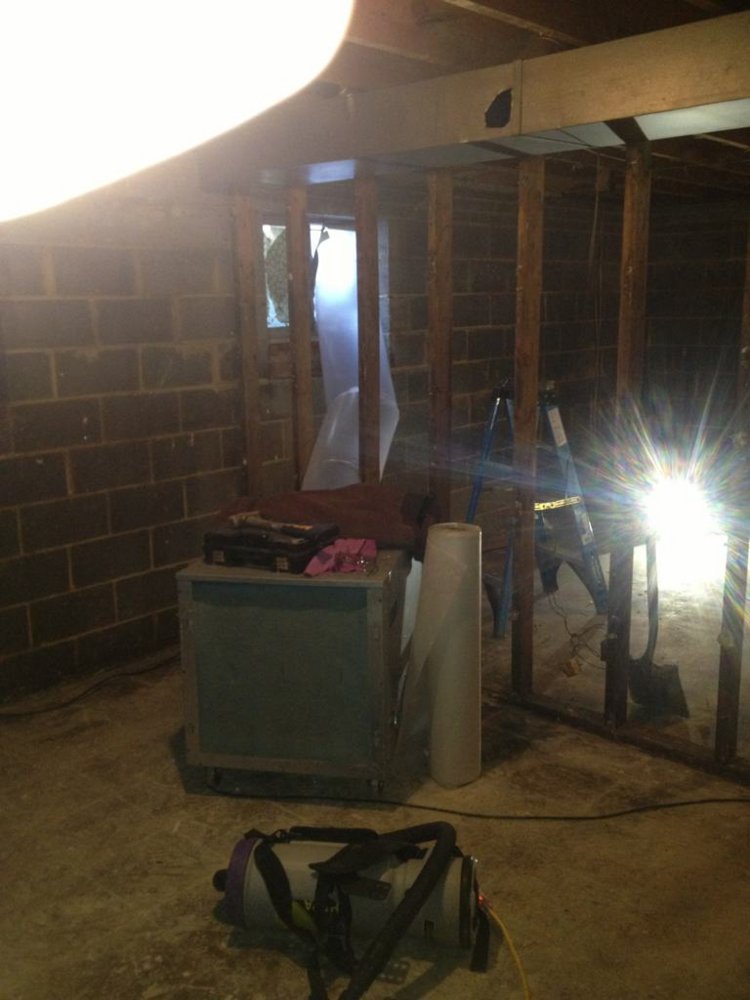

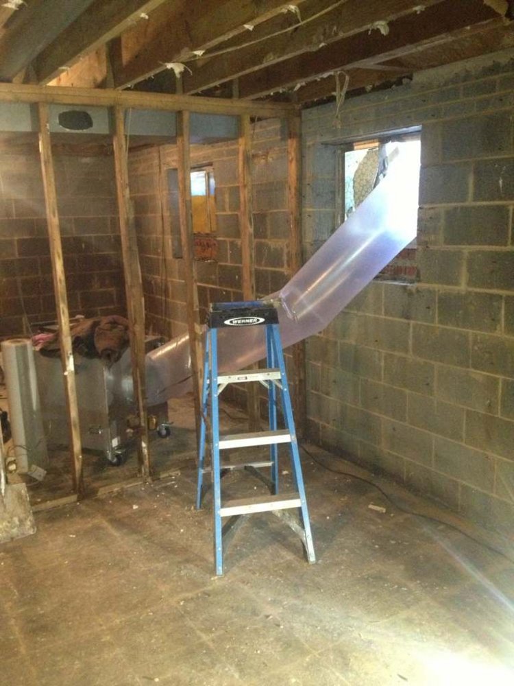

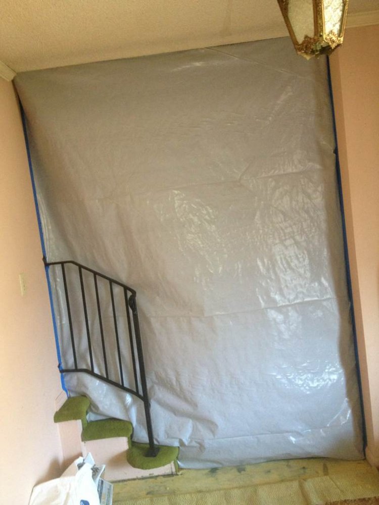

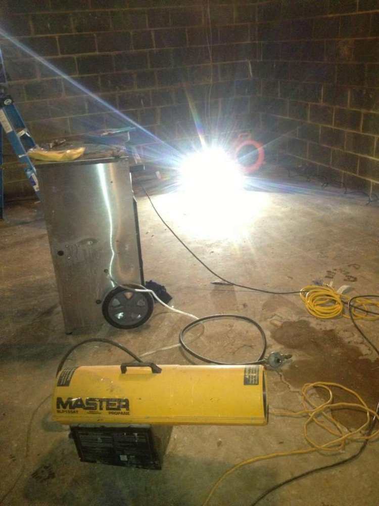

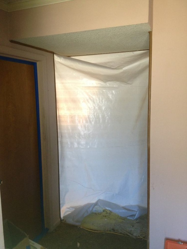

We have containment set up to separate the basement from the upstairs. We have an air scrubber down here that blows the air out the window. This puts the whole house under negative pressure to prevent contaminating the upstairs. But, there was already some surface mold upstairs due to high humidity levels from the water. So when we finish down here we will have to go upstairs and vacuum every square inch of the house and its contents, then wipe everything down with a damp rag soaked in an anti microbial solution. This was just determined this morning and will be separate from the original cost. That will be an additional $1500-$2000
Folks, please don't ignore a mold issue. It can get out of hand and very costly real quick like!
This is the 6mil plastic in place for containment.

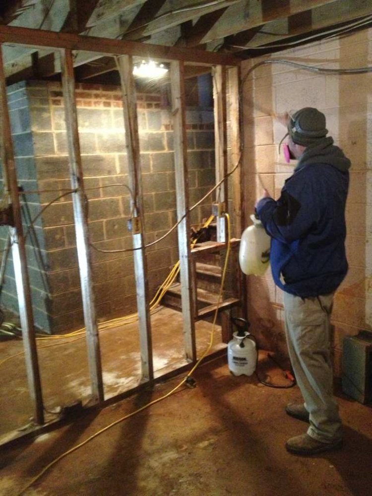

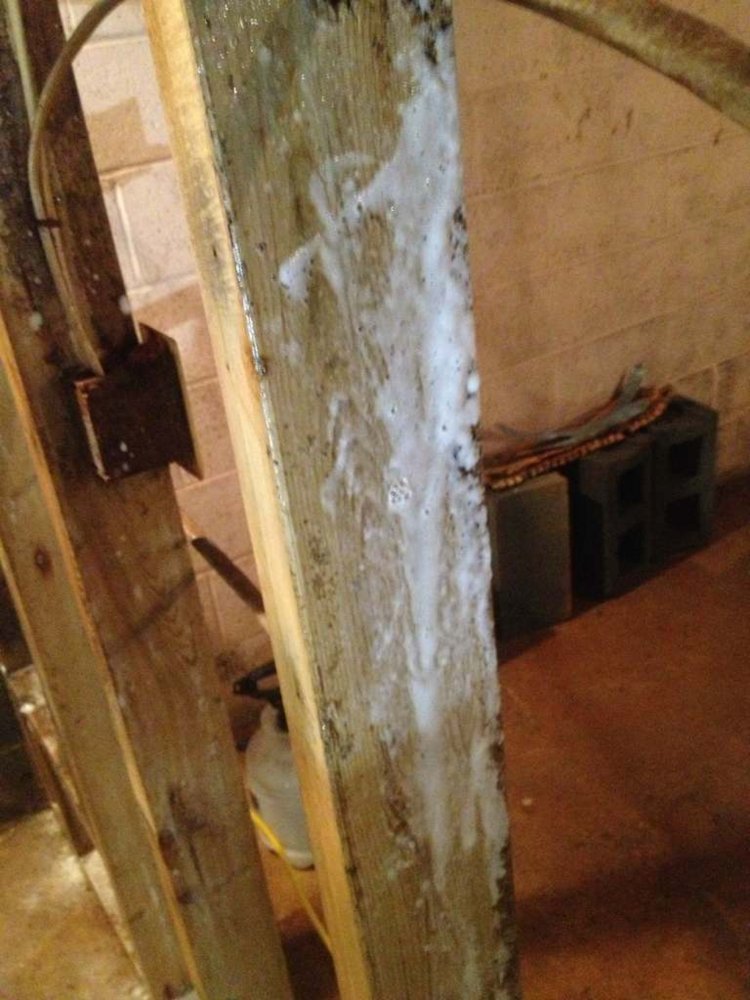

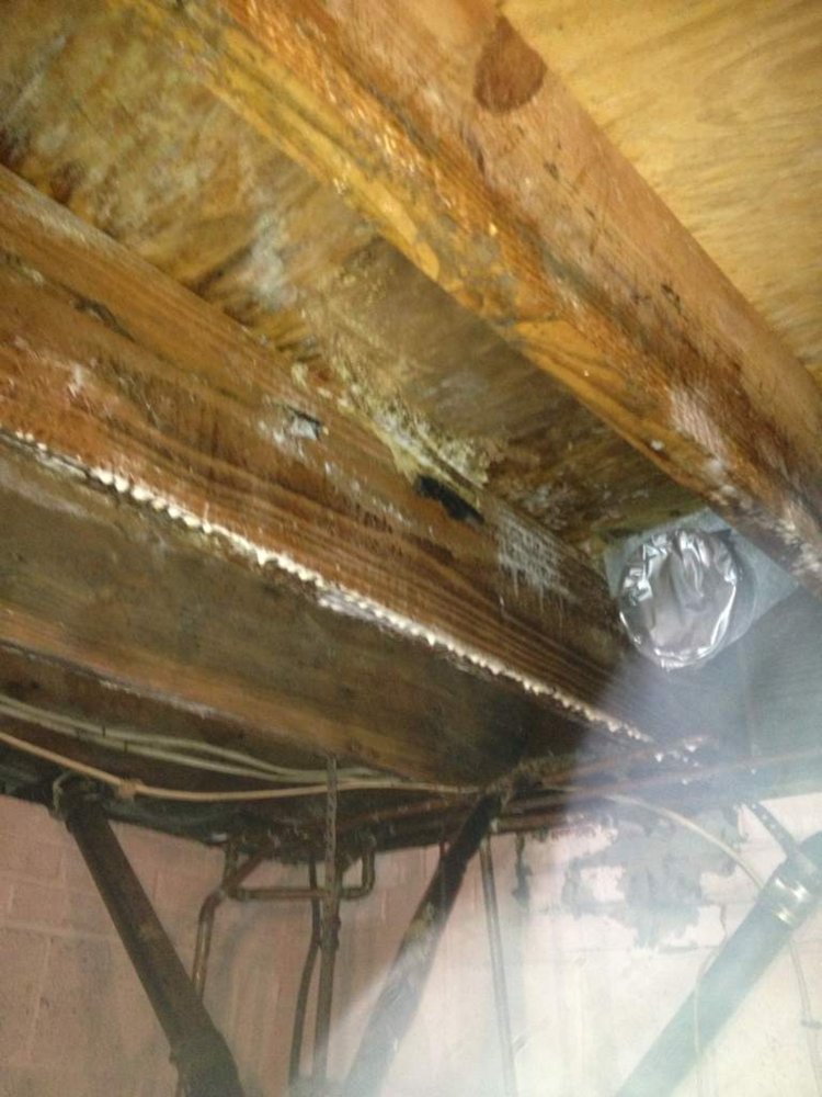

Started spraying our chemicals today. Everything is already looking much better. By Monday you won't even recognize the place.
This stuff foams up and eats away at the mold boiling it out of the structure. Then it drys and we vacuum it again. The apply the anti microbial solution that smells really good and clean.

Here is the finished basement after we dried it out and clean every inch. We had electrical issues so my pics are not that great. It was dry, clean and smelled great when we left. They have started remodeling now. I will follow up on this job in about a month.
