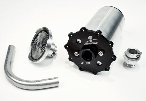

Does your cell have a bottom sump. Most guys have trouble pulling from the top of a bladder tank like this with an e2000 (I'm assuming that's the pump your talking about maybe)
on the pump issue...
Not sure of the cost but I found this. A universal in-tank pump unit
Those are nice but to add them to the required bladder cell would mean major cutting on the tank and the bladder. For an individual who's building the truck by himself it could work great but to keep my package price reasonable maybe not.
An inline pump should work fine to get fuel to the rail pump as long as it's rated to pull from the top. Plus they can be changed in a few minutes if they fail in a race. We just need to agree on one that is decent and readily available hopefully.
sorry for the late response. Yes custom built with a bottom sump. Yes on the part number. Just like what the brolite man posted except mine has no bladder since I built it from scratch. Full throttle hammer down and bouncing/ No hiccups or starvation, then again it is only a 2.9 liter V6 in mine!
Yea I'm guessing the e2000 would probably be adequate. My only concern is all the guys who hate it and have had nothing but trouble out of them (probably due to poor plumbing). I know guys who run them out the top just as we will in these trucks with no problems at all but sure as I use them it'll be my fault when they fail :) I'm just scared to pull out the top with one.
You can't get a bladder lined cell with a bottom sump and bottom mounted bungs??
