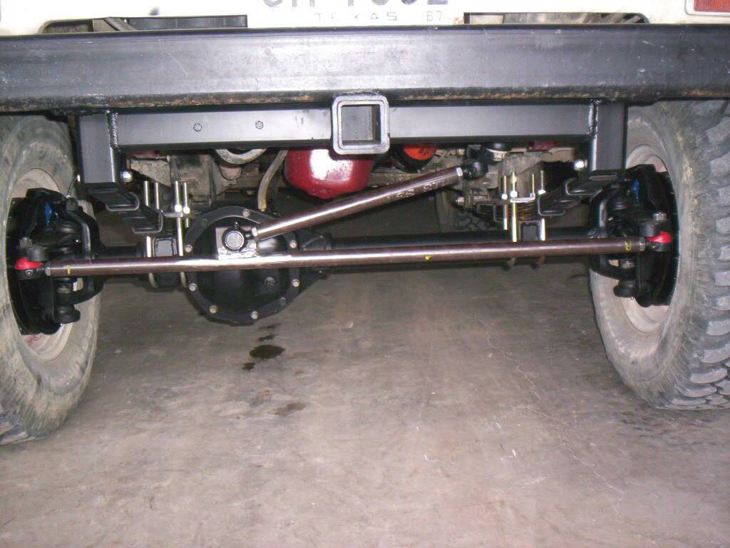

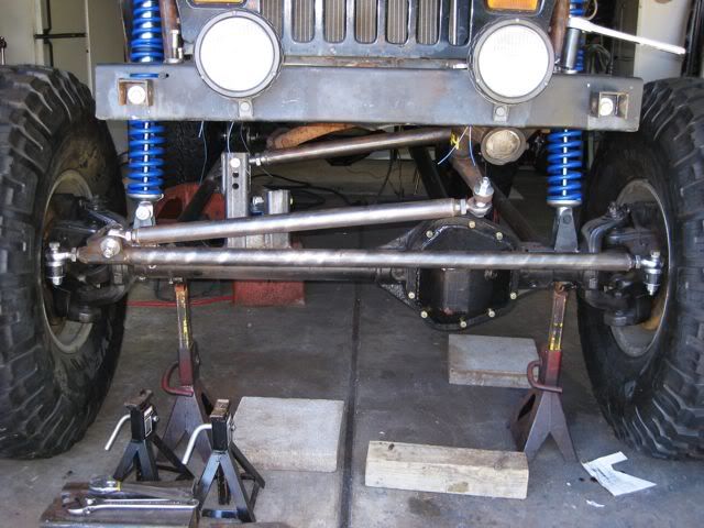

So this would be my other option of drag link ...the guy ran it on d60 balljoint with stock arms like mine and was his only option, 7/8heims on 40s...so should I go this route, should clear the leaf better, maybe won't go over as far...just a thought
Thoughts on above before I make something tomorrow..reading on his build, it lasted and held up well, locked on 40s

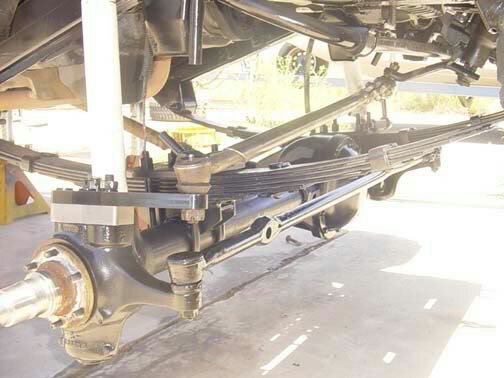

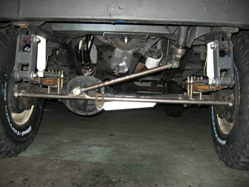

Also if you're going to compare set ups on steering, it's best to look at the same style suspension you're running. Maybe like these vvvv

Since you don't listen to what we suggest I say you get some gorilla tape and pvc pipe to make your steering out of.

Right we've been over this though ...see that's what I'm talking about. High steer arm is way too much for this stupid axle..same reason that guy didn't do it on the balljoint d60 so can we focus on what I'm working with..and u wonder why I don't listen..whose stubborn???

He has coilover he has the ability to package it that way. YOU HAVE LEAF SPRINGS YOU CAN NOT COMPARE LEAF SPRING SUSPENSION AND STEERING SET UP TO A LINKED SUSPENSION AND STEERING SET UP

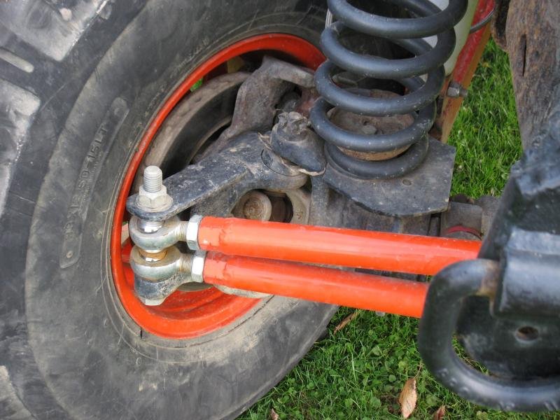

Anyways if you want some examples of how not to do you're steering here, some janky ass shit is right here vvv

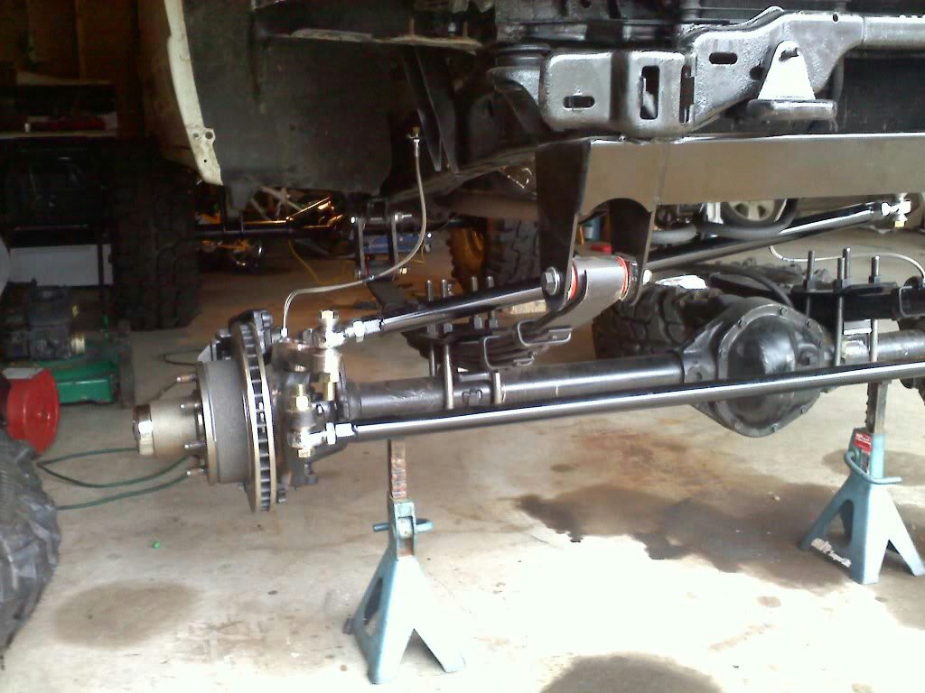

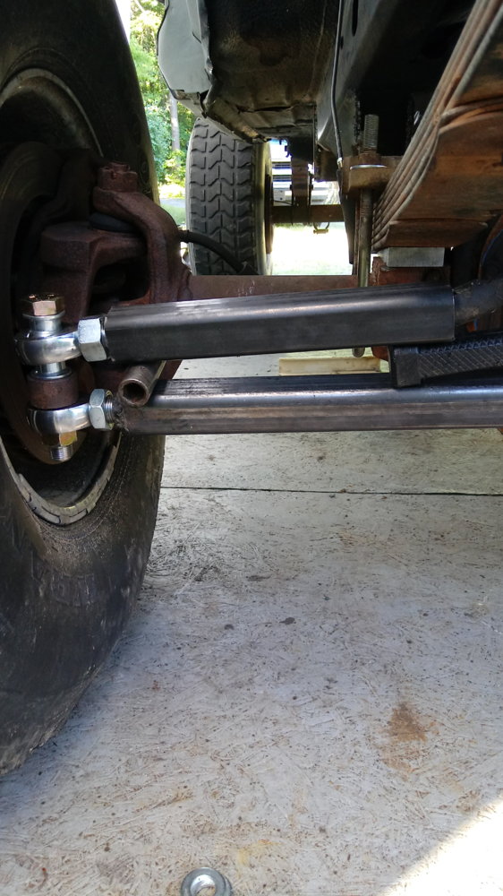

The 3rd picture is my idea or something similar. I get the first 2pics isn't right but the 3rd pic is close..will mock up my idea and post pic

I know this was a fail of a mockup now so were beyond that lol..figured that on page 1..will get pic shortly of new idea

I was referring to something like this:
How bout now..the piece will go past the leaf more to clear then turn up but this is general idea I had
Turn the bolt the other way do you won't hit the threads and fuck them up. Also I don't see any safety washers.
