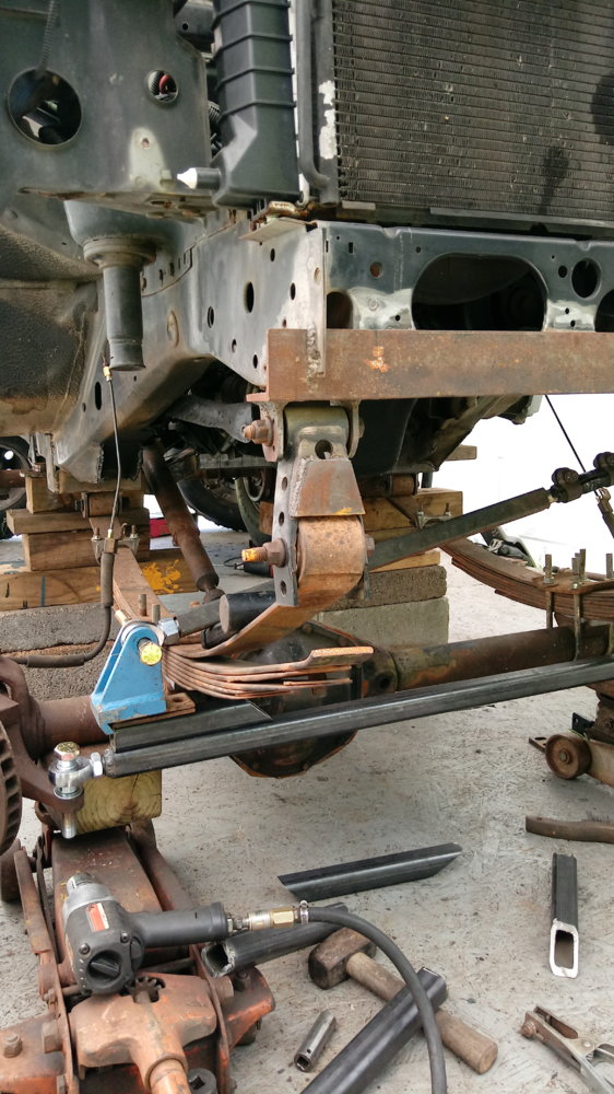

Does the pitman arm clear the spring when it's turned hard driver and stuffed on the driver side?
He has no track bar. So when he's playing hill killer and slides the passenger tire into the bank, the drag link takes the load.
Yes it clears and a track bar was in the plans for extra support when researching the "front leaf" build

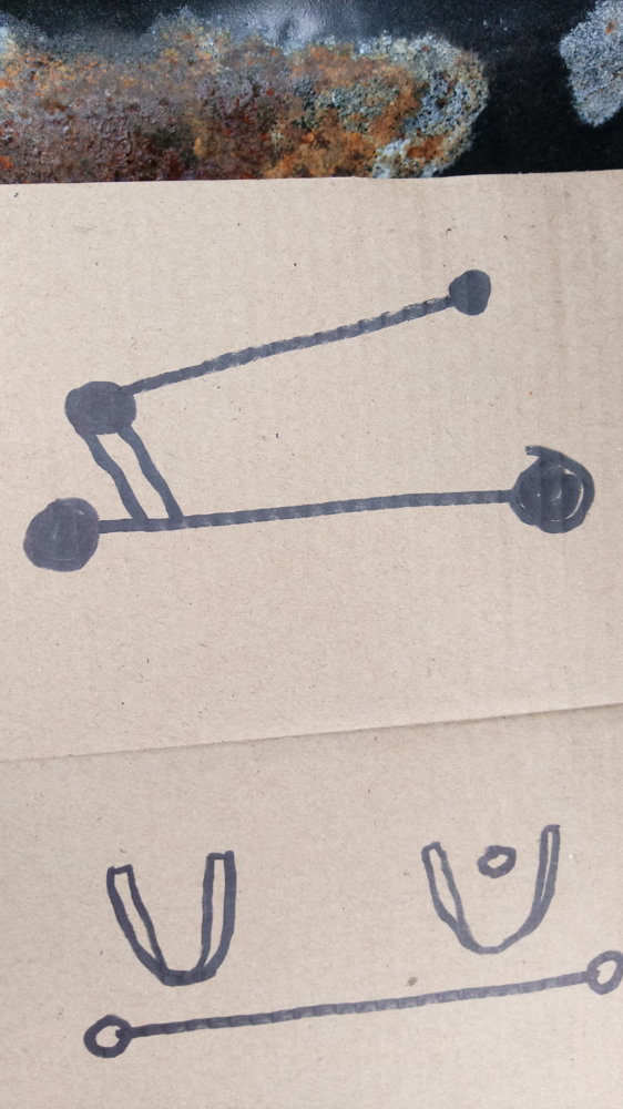

I bought these heims with plans to run the drawing I just put up since its a popular way on the web search but that idea was pretty much turned down...so here I am trying to make use of those same parts and make something works that maybe isn't "favored" but could hold up, that's all

Exactly on point..so we are where we are. Is there no way to use what I have to make a drag link for this thing

I dont understand your top drawing.
Where will it connect

Because that's just lines on cardboard with no reference as to what the fuck we're looking at. Need reference points or labels or something to clue us into what you're trying to convey.
If the drawing what I think it may be, which looks to be an extremely tall vertical member welded/attached to the tie rod with the drag link connected up top. Then no that will not work, it won't clear the leaf full lock to the driver side. Plus it will have a dead spot the size of texas from the roll in the heims.
Yeah u got it, that's what I was drawing..so back to drawing board then

What if I didn't use heim joint on lower linkwhere connects to tie rod bracket
Ok how bout this wheel turned all the way driver and make brackets off tie rod to that joint then straight up to pitman arm...not a bad angle and seems pretty good clearance and angle...gotta be much better than my Z bar setup
Doesn't matter if it's a tie rod end or heim, it's still gonna roll about like a fat pig in the mud when you try to turn. Granted there are ways to prevent it but none of them will prevent it for your proposed set up.
Its flexed out already
No you're at full(ish) droop. Need to articulate the suspension so you hit full bump on one side and full droop on the other. Then repeat the opposite.
Should I even bother though since u say it would steer horrible
