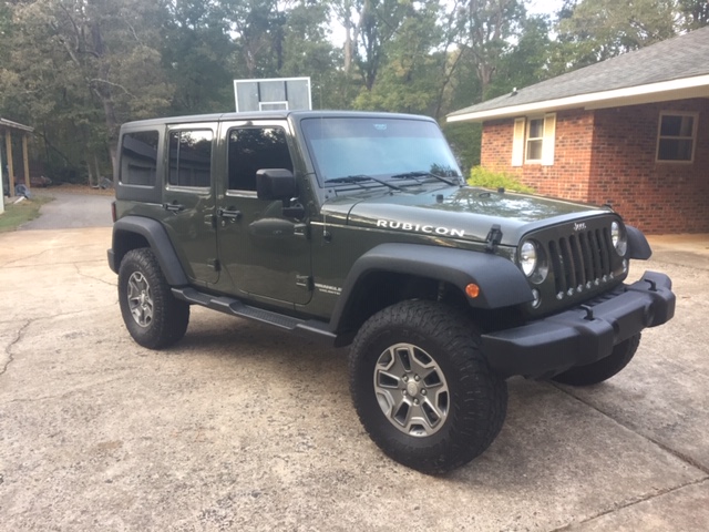

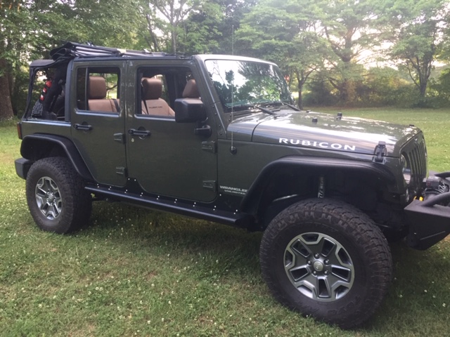

    2015 JKU Rubicon, Tank Green, 14K miles with about every option for that year. Came with Mopar 2 1/2" lift, Fox shocks and Toyo A/T 33's

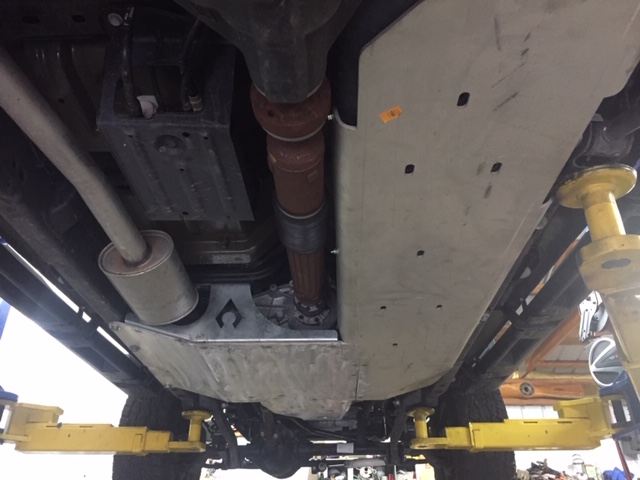

    Artec fully belly aluminum skids (complete)

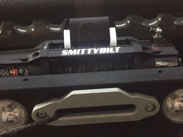

    Smitty X-20 comp Gen2 winch with synth. rope (complete)

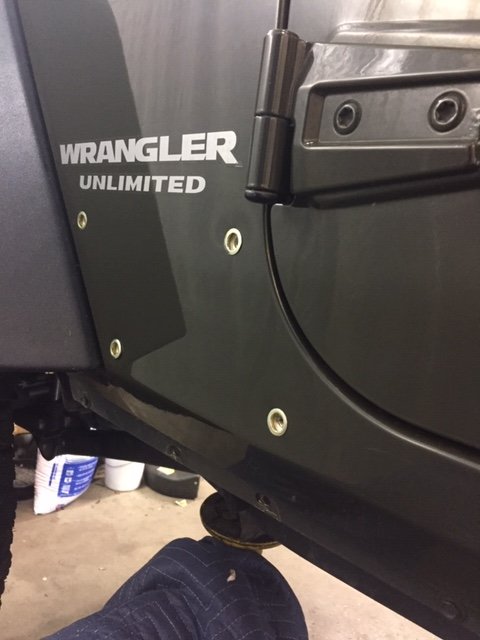

    Barnes Rock sliders (complete and heavy duty)

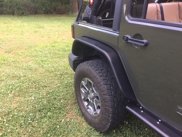

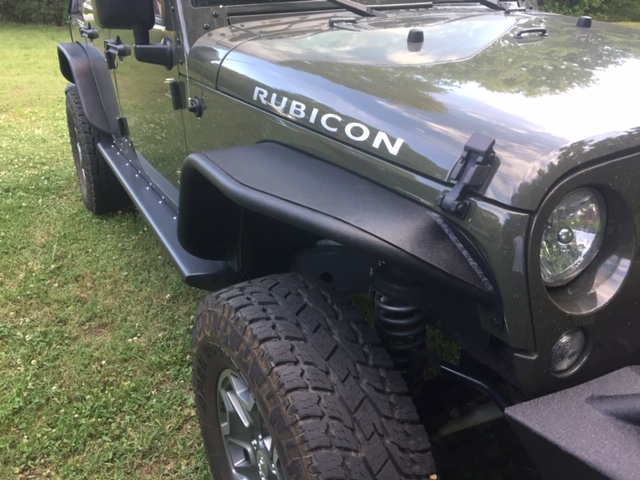

    GenRight aluminum fender flares (complete)

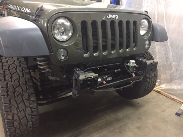

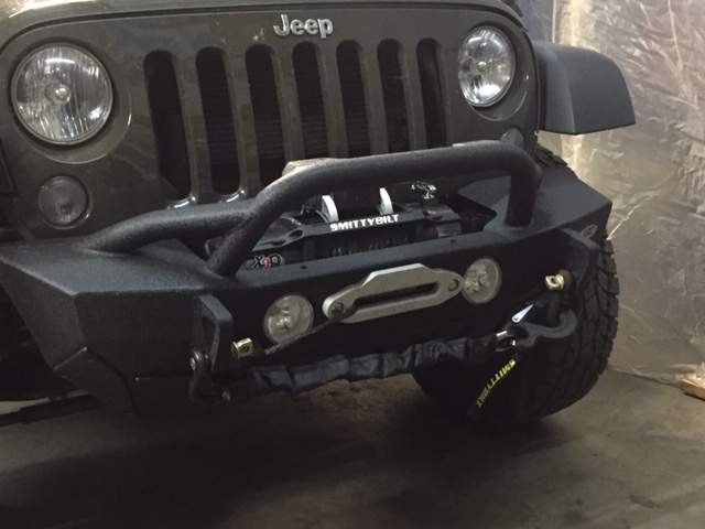

    Bumper install. I liked it at first, but I will probably end of changing this. It is a heavy bitch and I think it will hit a lot of stuff off road. I do like how the winch tucks in though.

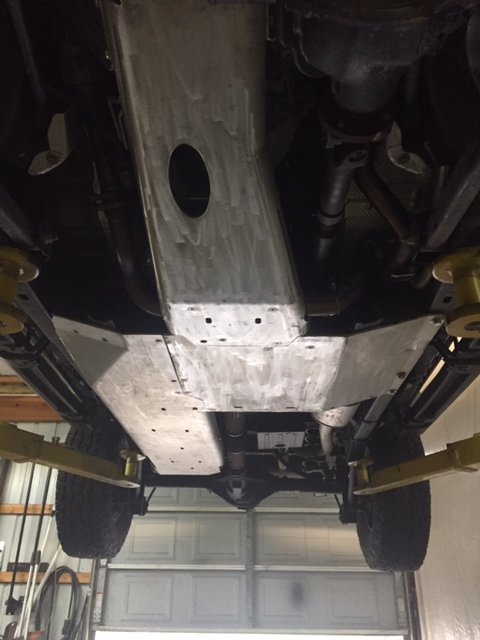

    Skids

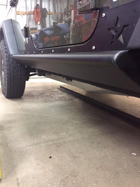

    Barnes Rock Sliders the rivnuts.
    Great sliders

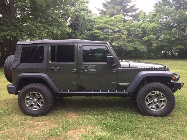

    Soft top installed for summer

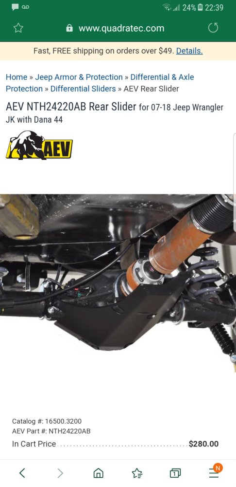

    Steve @89wrangler have you thought about adding a better evap skid. I run the one offered from rockhard and a AEV rear differential skid. Helps protect the zeppa joint and makes going over rocks with your rear diff. But it looks like a killer build so far

    Yup, there will be an evap skid added to the list. I will also look into the diff skid. Thanks @josh$$

    Got the Aluminum GenRight fenders installed this past weekend. Did anyone else notice it was hot out?? Gonna start taking the front axle out next, then truss, ball joints, steering, gears.

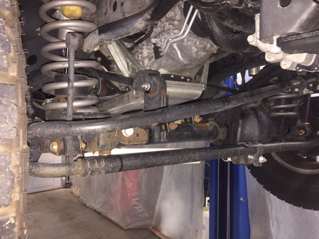

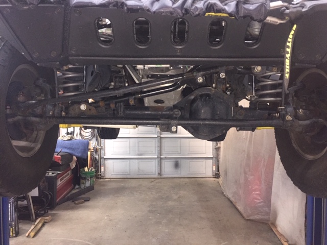

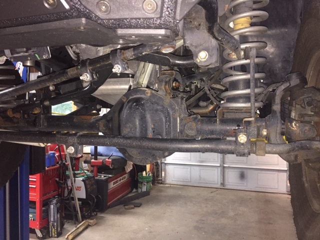

    Going under the knife tonight. Pulling front end and start the axle, steering mods and re-gear.
    before pics

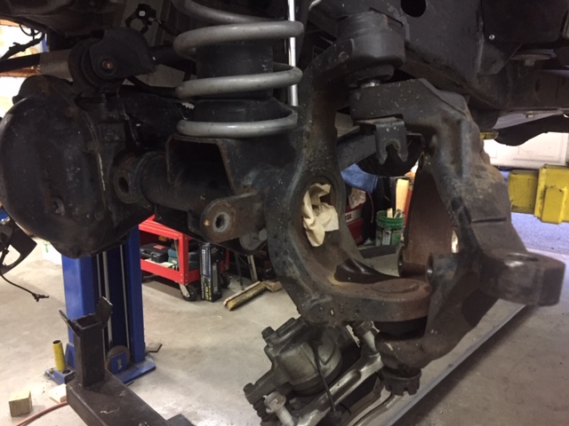

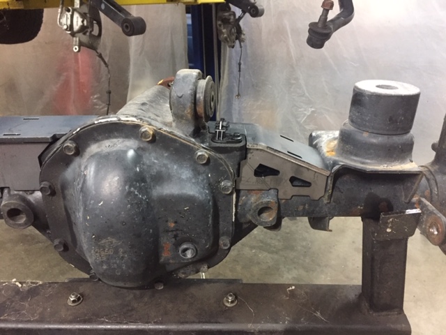

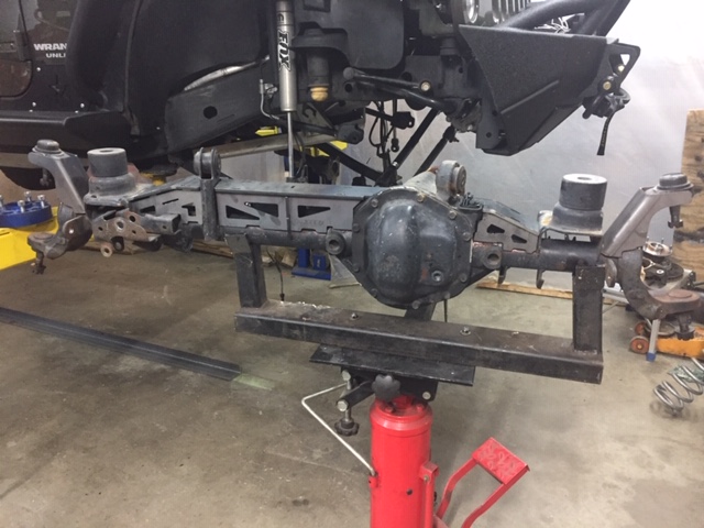

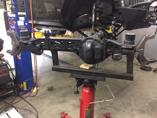

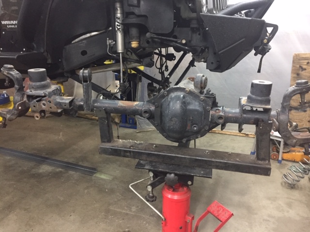

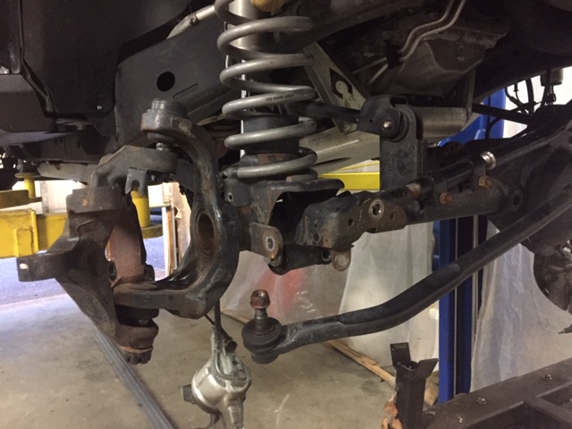

    Axle is out, let the work/fun begin.

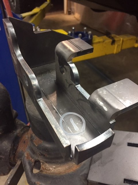

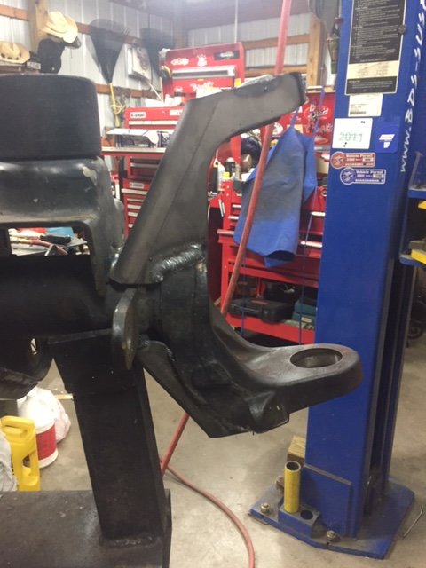

    pull shafts and removing the knuckles for new ball joints

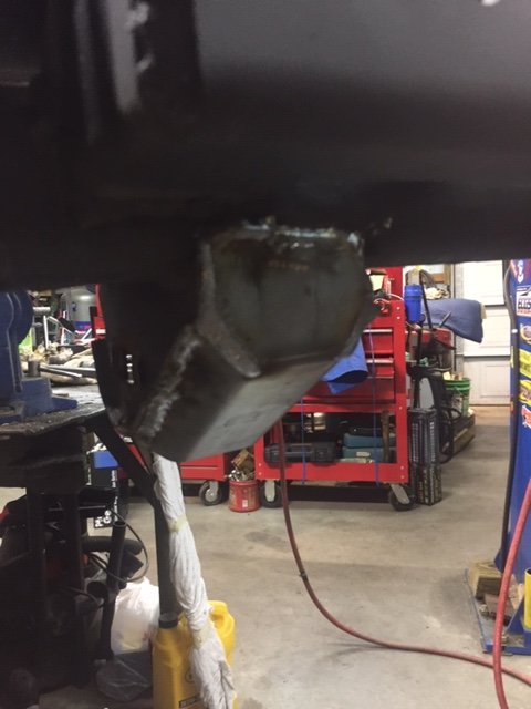

    On the stand. they really ought to put larger tubes on these. you can see why they bend.

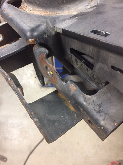

    wimpy trac bar mount
    Barnes Beefy trac bar mount

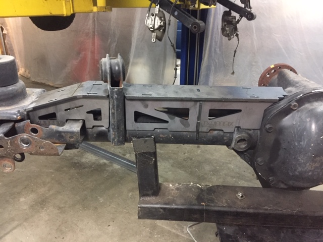

    Barnes Truss mock up
    Going to cut off track bar bracket and clean up axle and start to burn on the parts next once I pick up some wire today. Went to fire up welder last and ran our of wire on first pull of the trigger. Also note to self, where long pants while using the grinder. Damn leg still is not healed from last time!

    Awesome build, looking to fits my 08 JKU with a lot of parts from your list. Have you tried the rock sliders in action? I am looking for something similar to your Barnes sliders, but don't want to buy the fancy looking steps that wouldn't hold up as good.
    89wrangler likes this.
  23. 89wrangler
    89wrangler Not a new member
    Joined:
    Oct 22, 2005
    Location:
    Bostic,NC
    I have not used the sliders yet, in the middle of front end build and re-gear, but I can guarantee they will hold up to any abused you can throw at them. These things are beefy and rock solid.

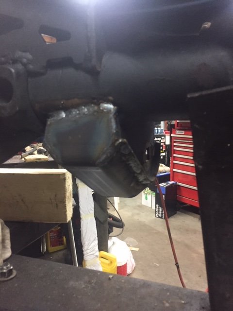

    Made some progress between interruptions...

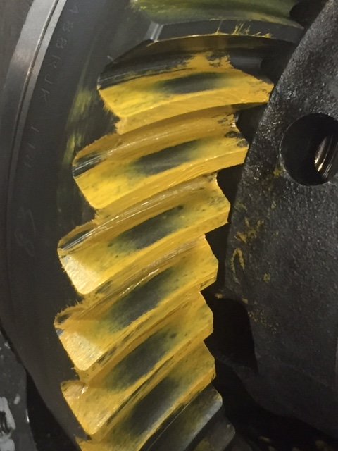

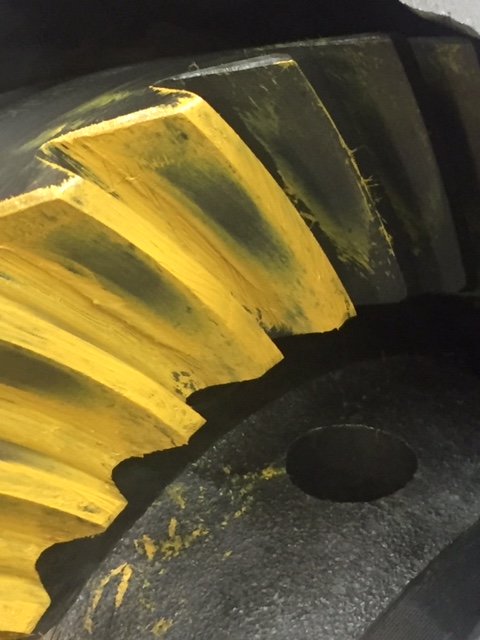

    Got all of the truss pieces welded on, the lower control arm mounts skids welded on and the 4.88's installed in the diff. Next will be the ball joints and steering components.
    gear pattern ( has the "Jody Stamp of Approval")
    Truss parts installed
    C braces
    lower skids
