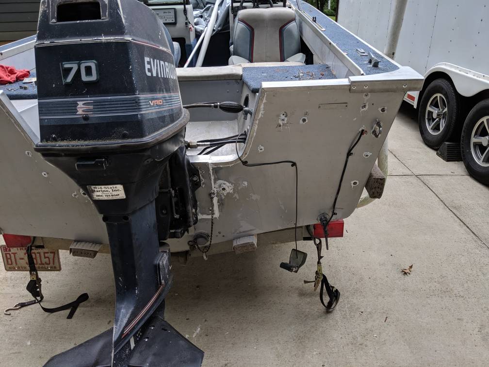

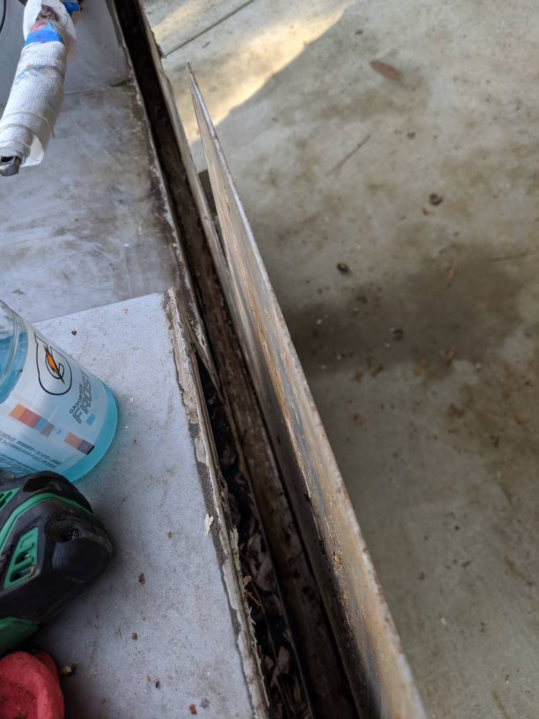

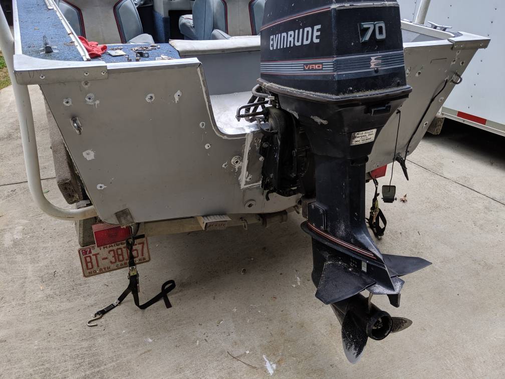

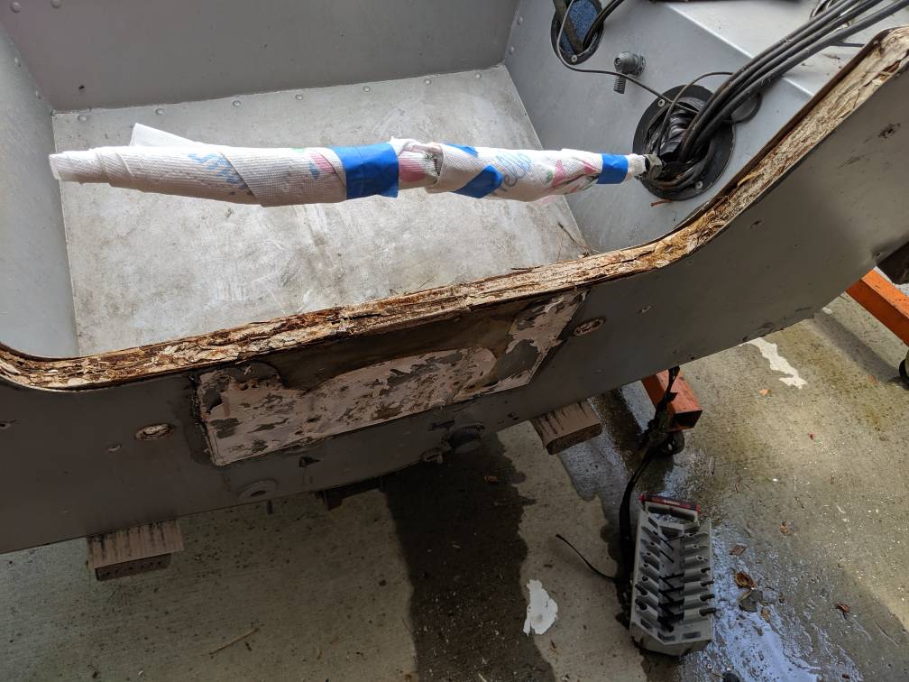

At the end of the season I notice where the motor attaches seemed weak. So I parked the boat for the winter and this Saturday I opened up a can of worms :)

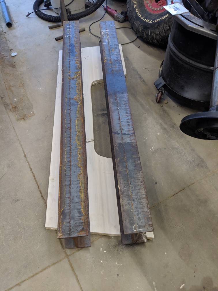

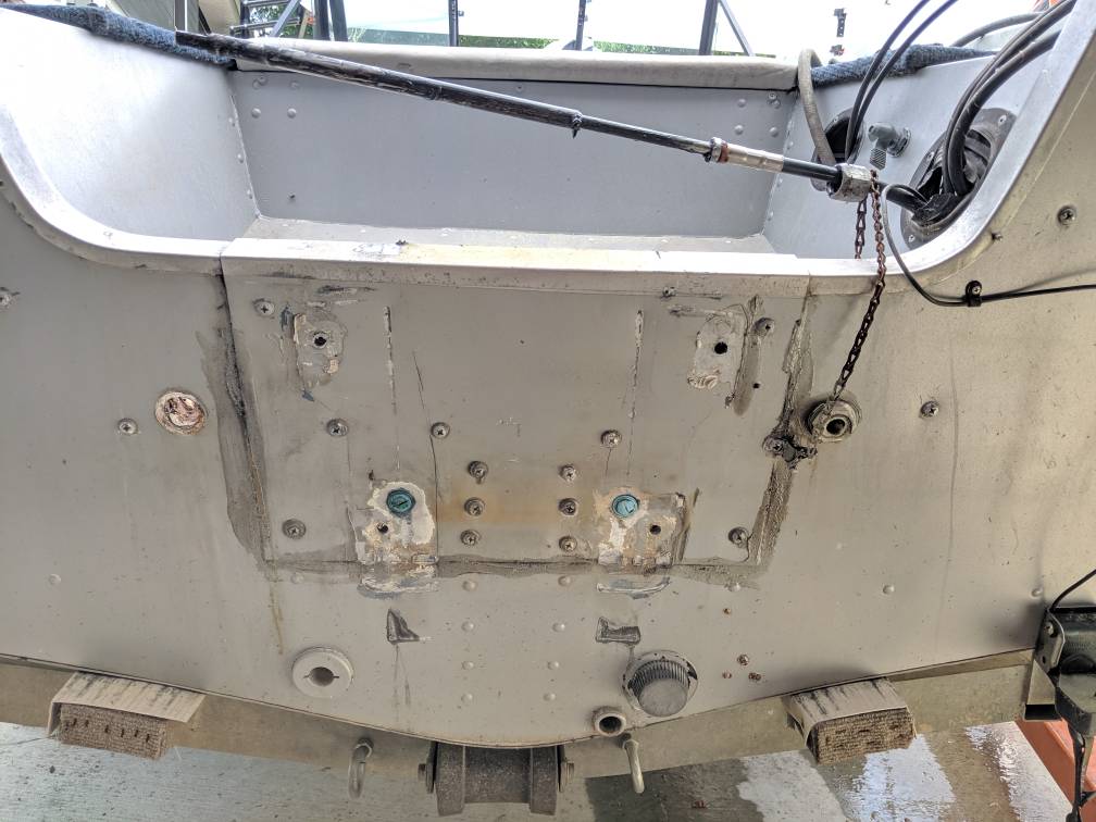

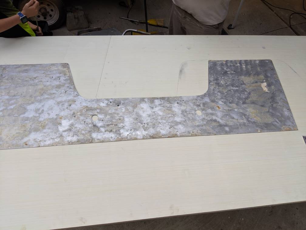

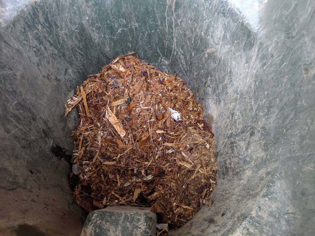

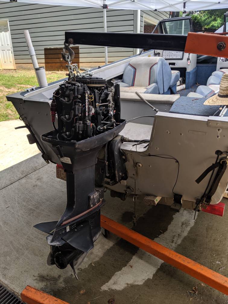

I had to replace the entire transom. Happy to say got it done in two days but crap that was a ton of work.
There is no way I could not have done it with two buddies and a huge shoot out to my 11 year old son. He helped me pit every bolt back in after new wood.
Very Happ to have it done. Now we get to test it again
Ended up using some hardwood sheets epoxy together. Then I epoxy the entire outside and edges and put it in.
Used some special boat caulk around bolts, holes, etc.

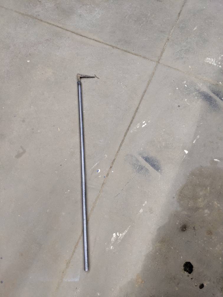

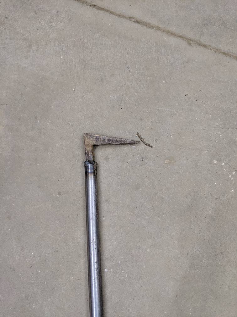

Also had to make a special tool to get old wood out. That was a pain.
Going off the VRO 70 engine that dates somewhere between the early '80s to the early '90s, I'm not surprised that the wooden transom core is rotted out, especially if it was stored outside.
Sold my boat last year for some capital to help move first time without one in about 15 years and I don’t miss working on it in the hot sun one bit last go around I bought a much nicer boat then before thinking it would be less work with fuel injection and all the good stuff I was wroung still a hole in the water to throw money at lol
previous owner said he replaced transom once also

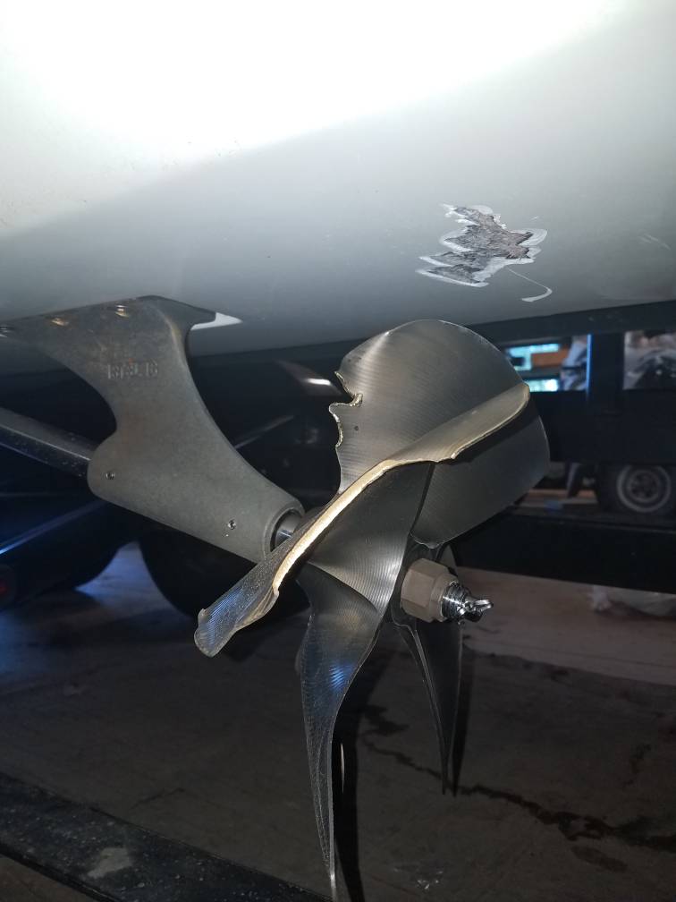

How does it run w that whale tail on it? I assume it was on the boat when you bought it? Lot's of them fer sure supposed to help get on plane faster an or stop porpoising. I had some issues w my boat I bought used and stock from the dealer. After 4/6 years I was about to put a whale tail on mine, but I decided to get a 4 blade prop after researching my problems. Got an alum. one on sale for about 2 times the $$ for a tail. That prop changed my boats performance like night and day and I kicked myself for not trying to fix it sooner. The steering , time to plane, and the all over performance change was amazing. You can get your own advise about this, but I bet you could put a 4 blade on it, take the tail off, and the boats perf. might surprise you.
This was 2 years ago, a submerged log floating vertically just below the surface. Bent the shaft , prop and rudder. Still the best money i have spent.
