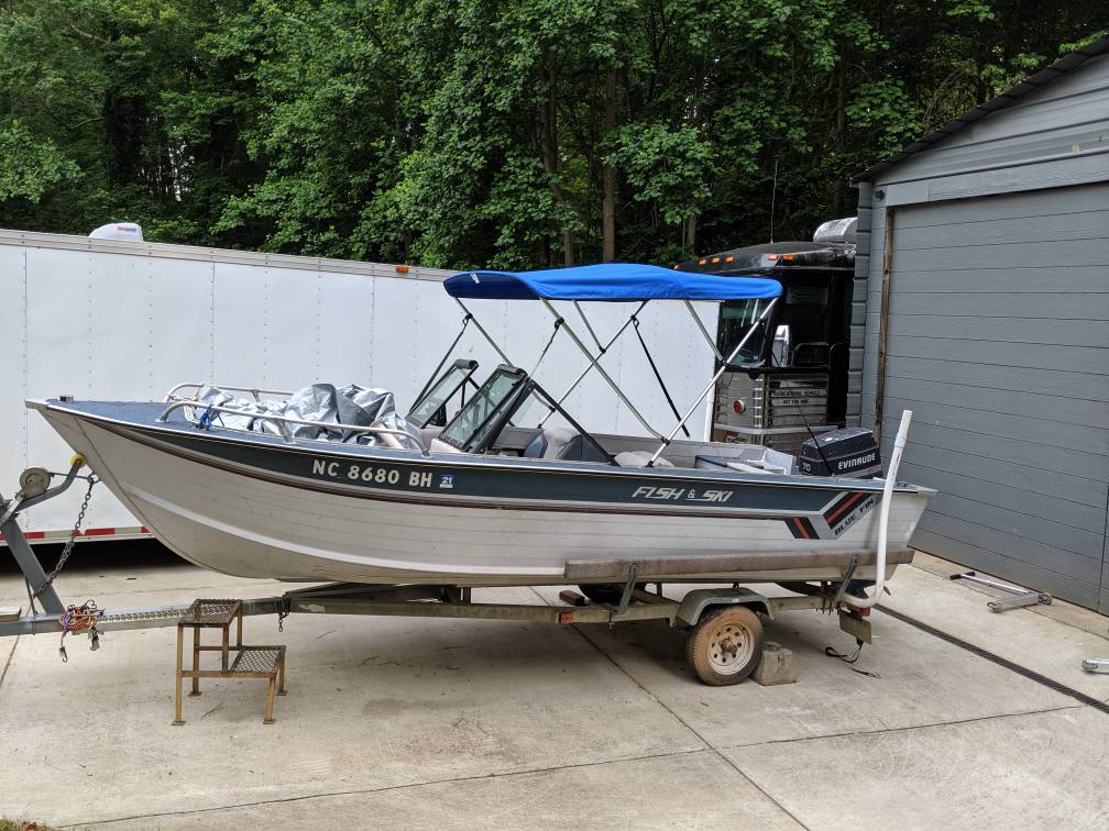

I sold my easy/cheap 14' alumicraft w/ a 25hp tiller over the winter. About 6-8 weeks ago I replaced it with a procraft 18' fish/ski w/ a Mercury 150 on it.
So far it's been worth every penny just to see my 9 yr old ski like a pro on his second trip skiing. Man is he excited.
With that said the boat has developed a hiccup as I start to really get on it. Other than that everything is perfect. So if anyone has any recommendations of what would cause it to studder about three seconds into full throttle I'm all ears.

How old?
With a delay like that, I always think of a fuel delivery problem first. A problem with things like plugs or injectors generally doesn't wait for 3 seconds to show itself.
Does it have a primer bulb, and is the bulb getting sucked flat?
I'd always change the fuel filter first, especially if you haven't replaced it yet, and double especially if it's a water separating fuel filter. It's amazing how quickly and easily a fuel filter gets clogged on a boat of any significant age. Buy two, so you always have a spare on hand when you actually need it, instead of on Sunday when everyone is closed or no one stocks it. Also, buy OEM filters because they're still a relatively cheap part, and the generic aftermarket filters (Sierra, etc.) are often only available in larger micron ratings.
There are some other easy things too, like not waiting for the ECU to fully boot on some outboards until you hear the beep (like Evinrude, not sure about Mercury stuff). If this is not done on an Evinrude ETEC for example, the min throttle position adapt is not done properly and can cause all kinds of stumbling and hesitation problems (the fix is to turn off, and re-start properly the next time).
If you haven't had the boat long, you might be overlooking something simple from lack of familiarity.

Its a 2003 model. It does have a bulb but not sure if it's sucked flat. It had a complete tune up just before I bought it including a compression test. Seems like the fuel filter says Dec -18. And coil packs were replaced in 2015.
Once it hiccups that split second it runs perfect. So idk.
I've been guessing it's fuel delivery also and may go ahead and change the filter but seems like it would hiccup at 60mph but it doesn't.
And yes I've had it <two months and had it on the water maybe 12-15 times so I'm really still learning it. Another funny thing is it just developed the hiccup when I started pulling my boy on skis.

The extra load from pulling a skier is probably what's showing a problem that you didn't see before, or the fact that you're applying a different throttle ramp to get him out of the water or whatever.. Have you noticed that the hiccup correlates to the amount of fuel in the tank, or how fast you give it throttle, things like that....?
Mercury had a pretty mixed bag of stuff in 2003; is yours carb'd or injected, and is it 2-stroke or 4-stroke? I'm assuming injected because of the coil packs.

what fuel are you running? my parents boat had a problem similar to yours if he wasn't using 93+ fuel, or if he ended up getting fuel on the lake he would have the same problem.

I've not ran it below a half tank since I've had it.
Seems like it only does it when pulling a skier but I'll check it out again and make sure this weekend.
It's 2-stroke.
I'm pretty sure it's carburated but honestly I've not paid any attention. I've only had the hood off twice and the fuel delivery system is completely covered by the air intake shroud.
I'll look and make sure tomorrow.
