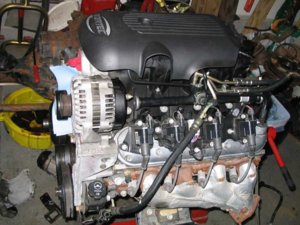

Picked up the engine yesterday - The shop was disappointing. They knew full well what I wanted, and some of their methods were still the old "It's attached still, cut it!". That's NOT how you pull an engine when it's ordered as a "Full take-out" 295hp, 330 lb-ft stock.
Oh well, not too bad though, and the price was great. The motor looked kinda dirty, but it's cleaning up rather easily. I'm going to replace the intake gaskets just because, but other than that, it looks damn near ready to run.

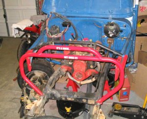

My PSC p-pump will also bolt right in once I swap the pulleys, I'm glad I bought one with the metric threads! (NO idea why I did that at the time) We'll most likely buy another driver's side manifold and use it on the passenger's side, and route the exhaust around the front as had been suggested by a few people.. that's the only way I can think to route it.. With the driveshaft about 3" under where the R/H manifold exits, I don't see any other way.

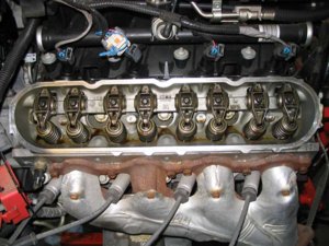

The motor is nice and clean inside.. 55k miles. All the brown is just motor oil.. NO deposits anywhere.

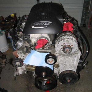

Other full shots of the engine, after I stripped the Medusa harness off it.
