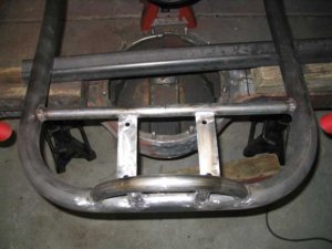

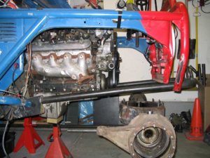

Today, made the front frame rails, winch mount & fairlead. The chunk will slide up between the front of the engine and the crossmember. This would be SO much easier if I built one of those sky-high rockwell rigs you see all over the place.

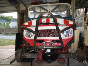

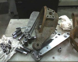

A little more progress.. Much of my weekend was spent helping make the steering arms or running errands, so not alot of progress..

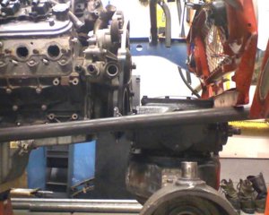

Managed to replace all the axle seals after figuring out how the seals come out... weird! Assembled the chunk into the axle and put it back up in place. Lucky for me, Toyota offset the OEM motor to the left, so I did too. It's a TIGHT squeeze in there, about 1/2-3/4" between the pinion flange and the crank pulley.
finished capping the frame and supporting the "frame rail", used 1/4" plate in 3 pieces, so the new front rail isn't butt welded to the cap, it goes through it.
Got hi-steer? :D Though my role was minor ("cut this, turn this, bore that"), it was still really neat to play a part in the creation of such sweet parts! Yes, I was in awe, and giggling like a school girl watching all this take shape.

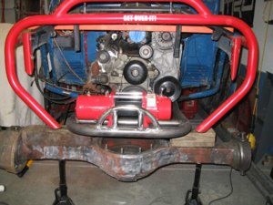

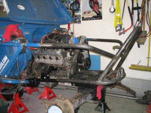

Good progress this weekend.. front tubework is almost complete (need shock hoops), and the engine is now part of the rig. (engine mounts complete)
Went alot different than I was planning, but it keeps the protection for the front end but has a more 'agressive' line.

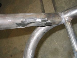

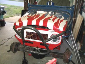

Because I'm doing away with the "fender-lets", I was able to narrow the front tubework 4".. it used to run alongside the hood, now it goes under it at the corner. It sticks out slightly past the hood line, but I already warned the wife that the corner will probably get crunched. I'm very happy with how the tube splicing and narrowing came out...

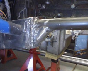

I spent alot of time getting the stinger dimensions how I wanted them (not too tall, not too short), I TOTALLY forgot to see if it interfered with the winch! Oops. I wasn't totaly pleased with the original winch mount anyway, and the new one will also have the winch down about 2" lower than before. (CoG baby!)
Had to open up the tube, and then plate it with some 1/8" plate, contour it to fit. it doesn't look like much, but it makes a big difference.

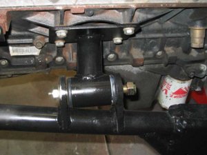

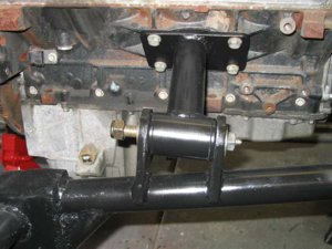

And, the engine mounts. The engine is offset to the left, which is why the tubes are different lengths, and the driveshaft will be running right under the right side, which is why that one is mounted so high on the engine plate.
Gotta admit, thats the first time I have ever seen greasable engine mount bolts. :flipoff2:
you expecting that much frame twist ?
I know they won't sieze in the sleeve, and I'll be able to get them out.. :)
