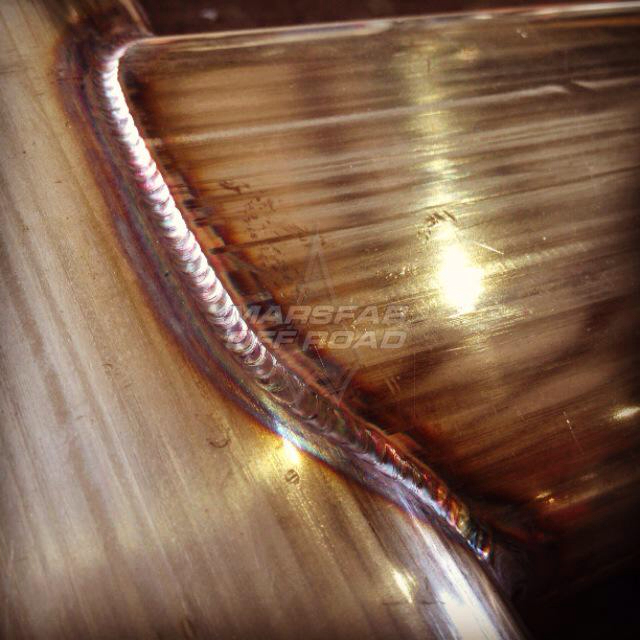

I welded this..
and
ai44.photobucket.com_albums_f36_benji51288_utf_8BSU1HMDAwNTktMjAxMDA5MDgtMDAxMy5qcGc.jpg
with this ole' gal..
ai44.photobucket.com_albums_f36_benji51288_utf_8BSU1HMDAwMzMtMjAxMDA4MjctMTM0Ni5qcGc.jpg
ai44.photobucket.com_albums_f36_benji51288_utf_8BSU1HMDAwMzItMjAxMDA4MjctMTM0NS5qcGc.jpg
she takes a while to get warmed up, but she will weld the world together if you hold your mouth right! :huggy:

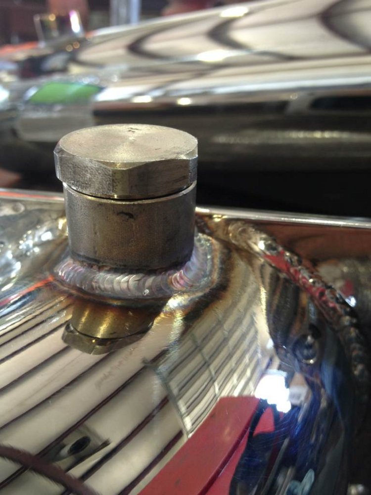

It is undercut. .045 tube to a roughly .188 bung using 1/16 filler.
Sent from the MarsFab Off Road mobile response unit.
I wouldn't sweat that undercut. There's plenty of metal behind it! ;) I hate welding pipe to thin stuff. Looks like the weld was a little hot, too, but sometimes that just seems unavoidable. Did you back purge?
No no back purge and it was probably a little hot. I'm trying to learn my new pulse machine. You can't tell in the picture but this is a double wall pipe with the gap between the walls being less than .25. I had to weld outside and inside to seal off the gap that was fun. I won't hurt you guys eyes with my inside weld lol.
