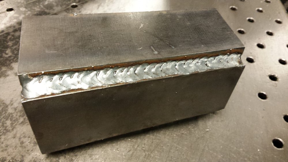

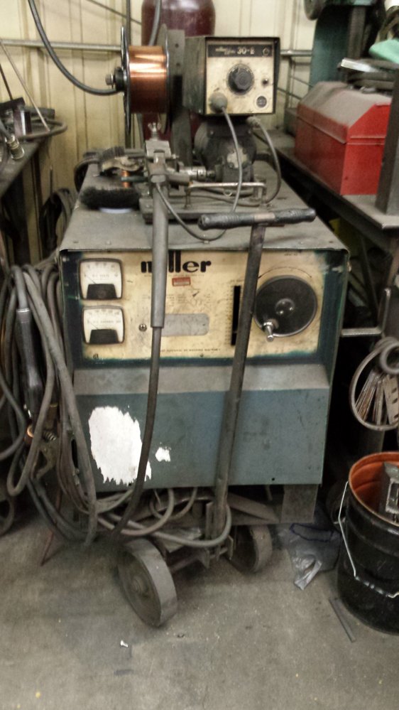

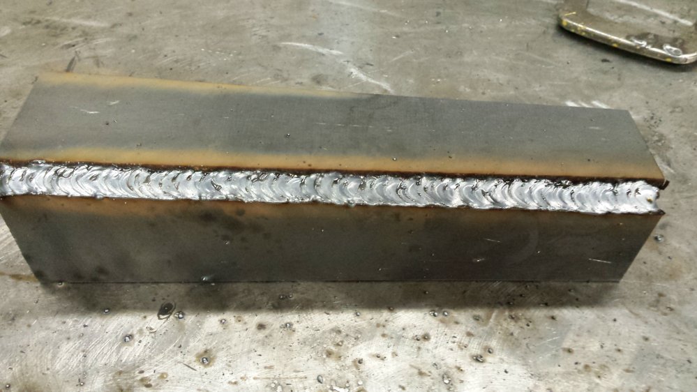

Finally got some time to practice on some scrap at work and to try out this old as dirt Miller.
Not killer, but not bad for my standards.
I've used one of those, good machines. Although the dial didn't correspond with the actual heat output. The analogue gauges were fun to what and really cool when you fiddled around with different stick outs and ranges of wire speed. It reallyu proved how dramatically those variables affected current and amperage during the wire transfer.

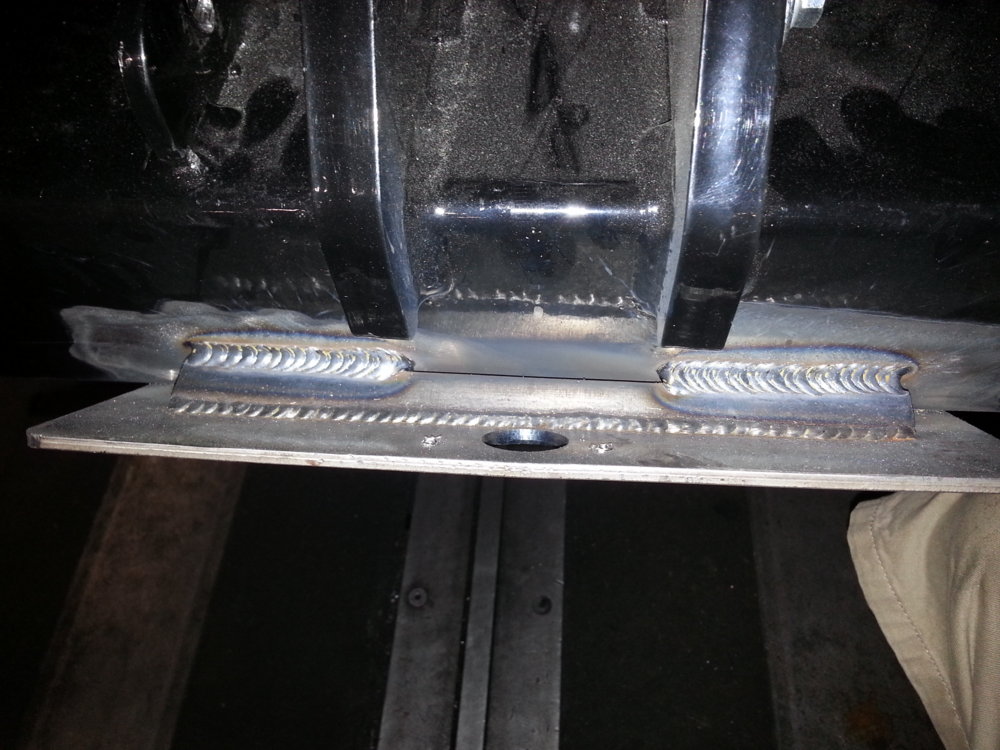

Staggered welds throughout the arm to keep the heat down
not sure what you processes are but, this may help you get faster with the same quality. Try tacking the entire piece solid. Then run 4 or 5 inches of weld on that type of material. Have 10 or so, decently heavy blocks of aluminum sitting by. After you run your first 4 or 5 inches, start clamping the aluminum blocks to the outside of the fillet. When you stop the weld at the end of the heat sink, clamp a cold one on it and rock out again. and repeat. Would be cool to see what happens. I bet you can get it running pretty good.
