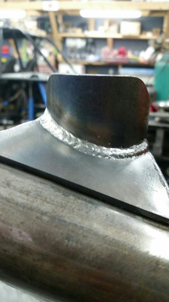

Great tip on the wire downsizing to 023. Been getting a little practice. Much more control and easier stop and starts . Heat appears more even as well. Why didn't i think of this before. ...thanks guys!

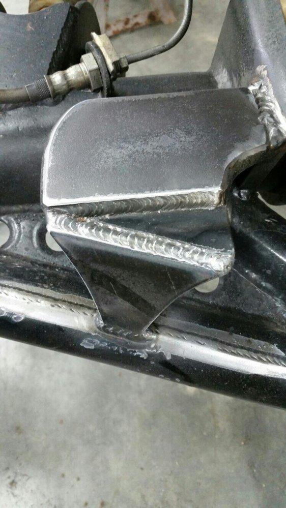

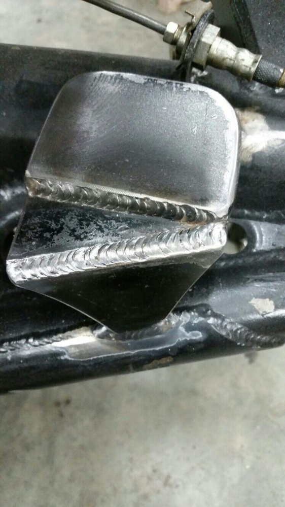

For my 185, I've now run all sizes in it and never changed the rollers. Iirc, my rollers only have a groove on bottom wheel, top wheel just applies pressure, I'd have to look again to be sure. Welded some 1/4 tonight for my bump pads, I'll post a pic tomorrow, never been happier with my welder than now with the .023. I will continue to keep .030 handy for heavy, less purdy jobs.
