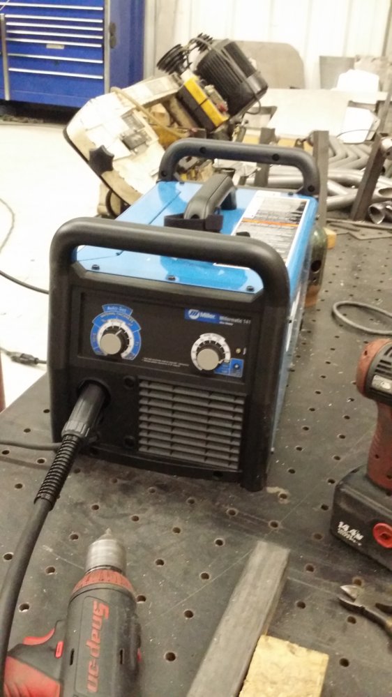

Picked up this little guy yesterday. It's a 141 Miller. We filled it with .025 wire and it will stay on the jig table welding .085 and .095 tube for the majority of its life. I'm very impressed with how it does, especially for $700.

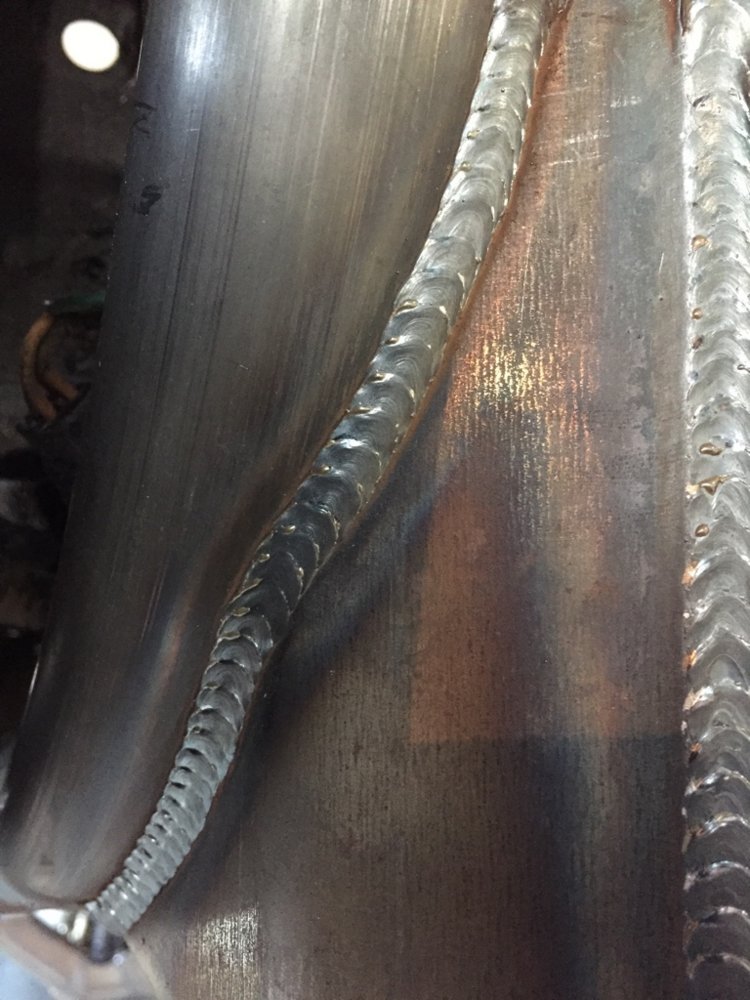

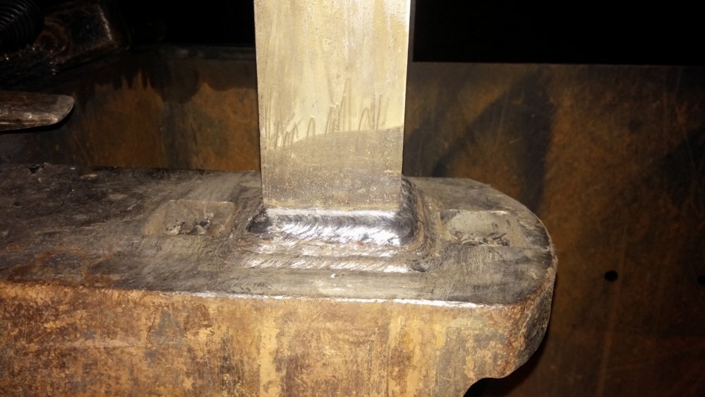

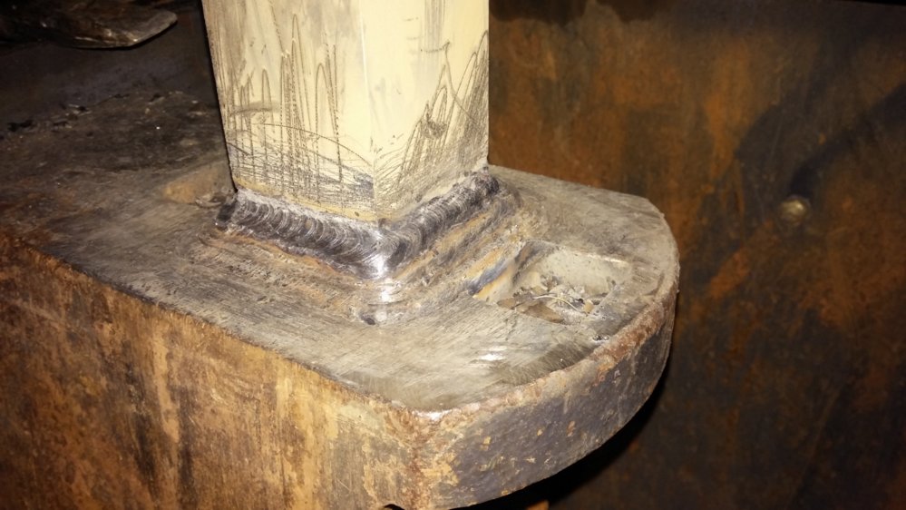

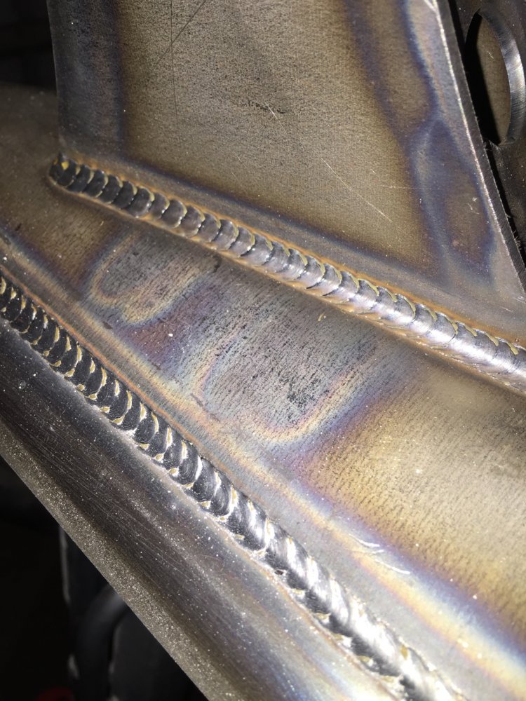

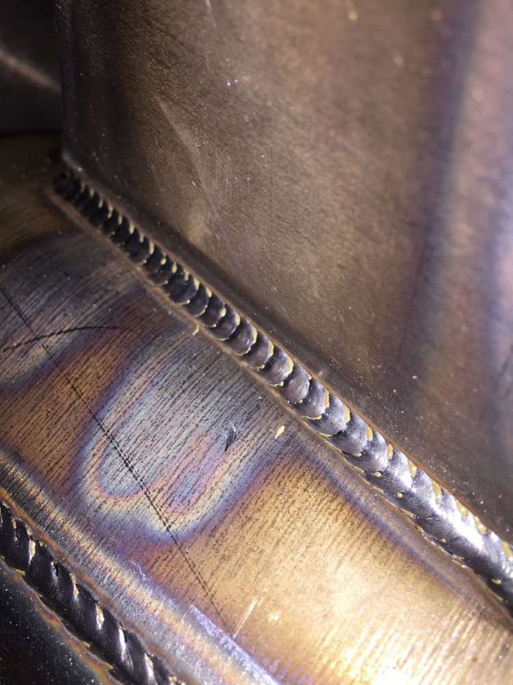

not my best work but maybe my deepest penetration
Aren't you just a crafty m f'r lol. That's pretty impressive.

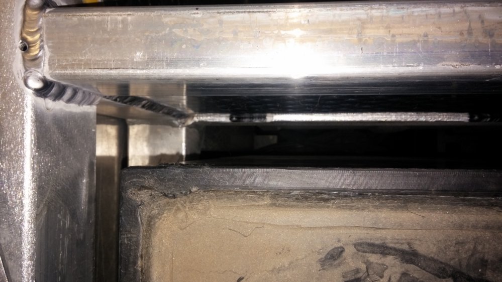

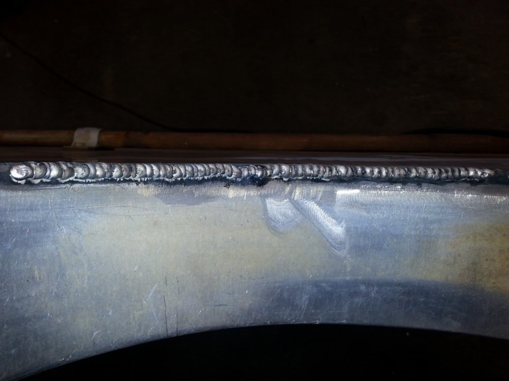

Here's my weekly entry. I believe this was to the tune of "Pencil fight" by Atomship great tune. Awesome band. If you've never heard of them you really should get to youtubin.

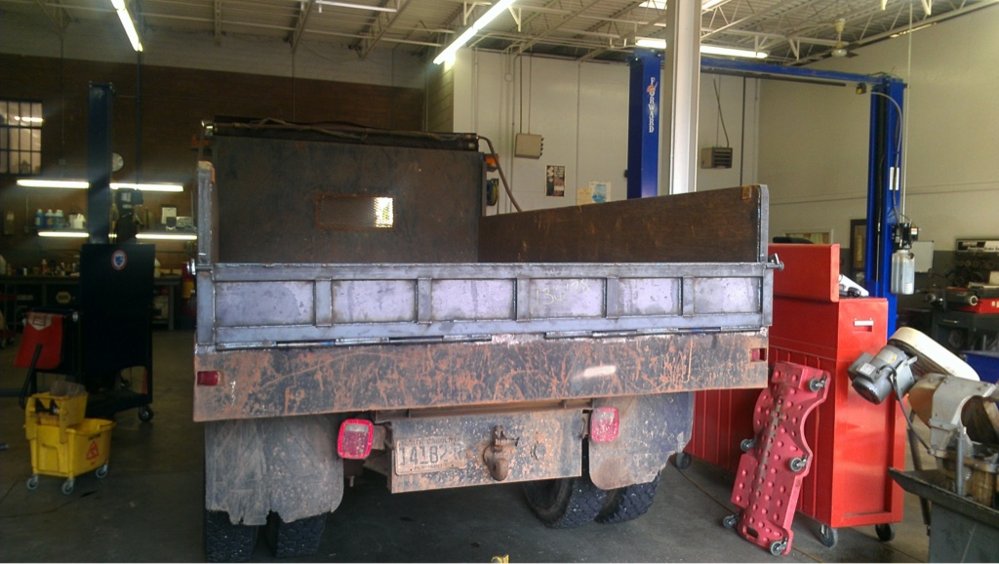

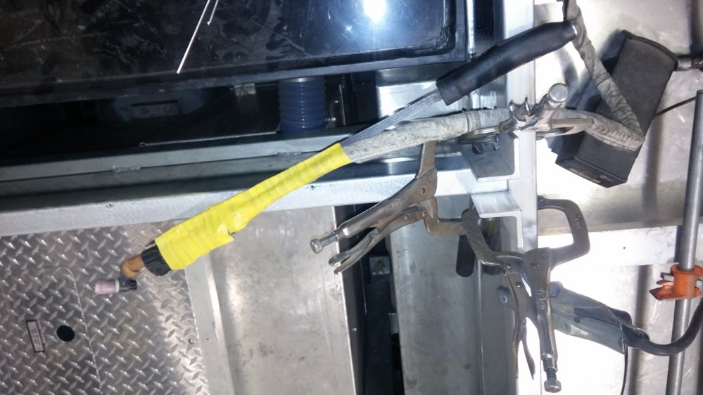

Yep, had a 2 inch or less gap to work with. Welds were 14 inches straight down from the top. Needed about five 2 inch long beads to hold a panel on an extrusion on the Ladder truck. One vertical bead 12 inches long. The only other method was to pull the water tank and remove all the related valves and set the truck up out side. Then pull the 500 gallon tank. The insurance company quote didn't allow for this in the estimate. So I unhooked the thumb control, plugged in the foot pedal and grabbed a few full length rods. Steadied the Tig on a stick by wedging against the truck, filler against the plastic tank. Worked one heavy pulse at a time to put it in. The cup hid the entire vertical bead, sorta shot from the hip on it. Saved a day and a half on the job.
Very nice. A fusion weld on a stick is one thing but introducing filler that far away from you and actually hitting the puddle with the end of a tiny flimsy rod is more than I'd ever wanna tackle.
