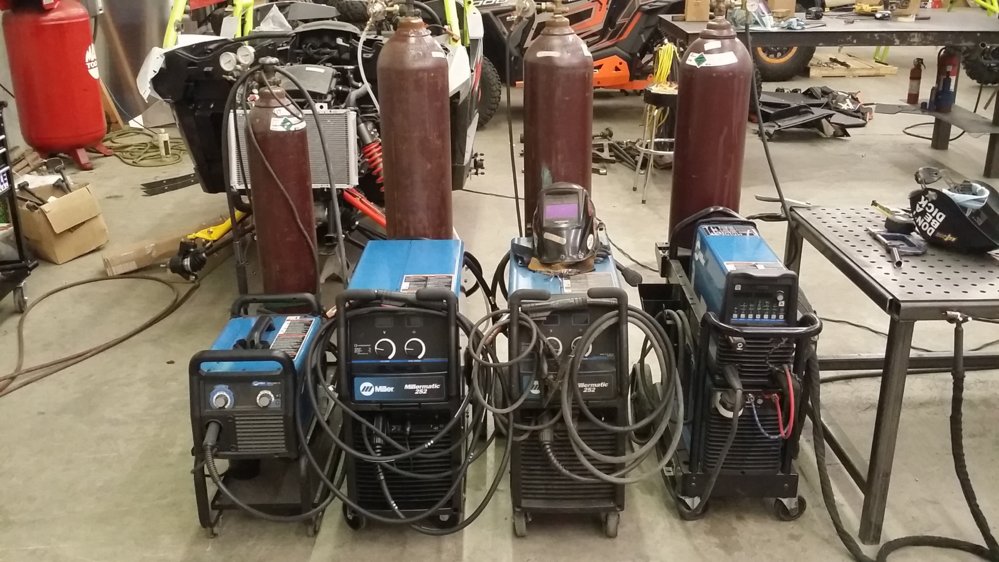

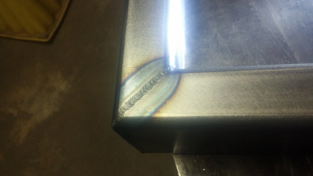

Learned something new. So that's the Damn problem and why my machine never seems to true my tune in. Its great when the ideal position and joint is available. But your right slightly out or variables really screw with its output.The big millers and millermatics older than 20 years or so don't seem to have the issues i complain about.
I don't necessarily hate the auto set feature. It's great for when I'm welding up a cage or something and someone walks in with a loader bucket to weld a crack on. Just turn the dial and go.

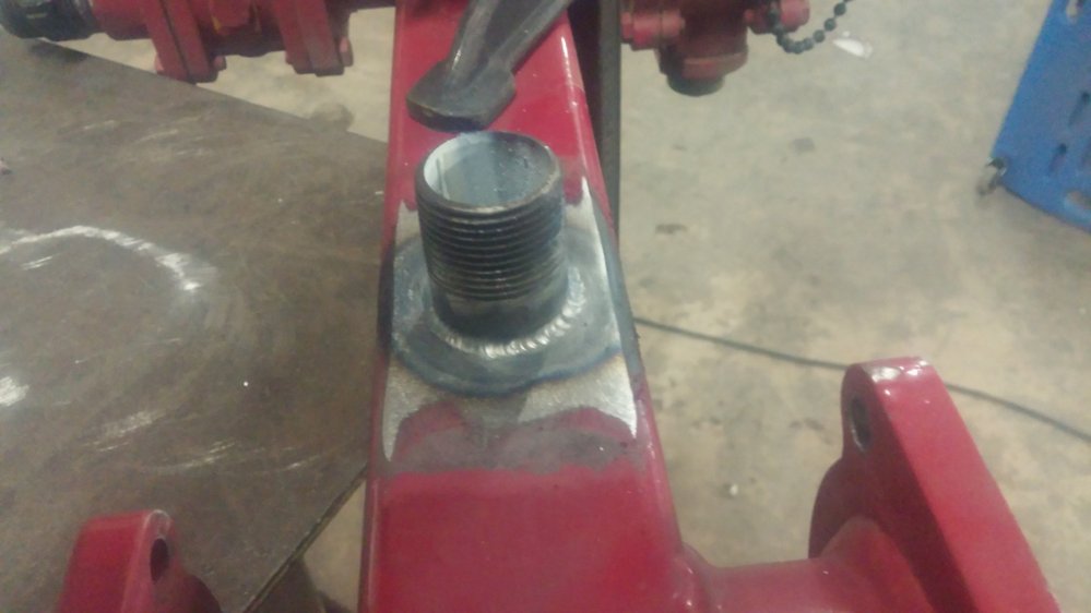

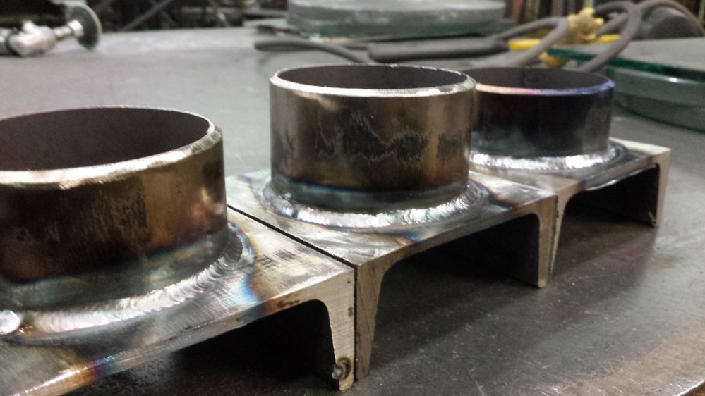

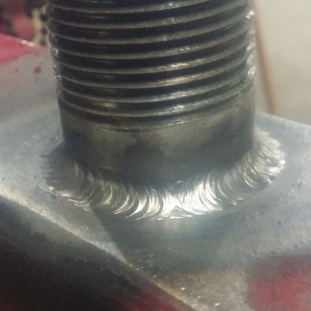

My complaint with the Miller is a very specific problem. When I weld tube I try to do a 360* joint in two 180* passes. If you have a 45 deg. angle on two intersecting tubes you end up with a really tight spot on one side. To make the weld look nice you need to start one of your 180* passes in that tight spot. I call it long arcingng, but you basically have to start the weld with a bit more stick out that usual. The Miller machines won't do it. They just spit and sputter trying to adjust themselves to fix the problem. It makes for a hideous weld start and a cold joint.
One of the guys that works for me also works for a big race team and he informed me that the "run in" was adjustable. I couldn't believe I never knew about it. I thought all my problems were finally solved. I've since spent the last 2 months screwing around with the run in adjustment and I can change how it does it. I just can't make it go away.
Miller tells me that all of their below 300 amp machines "tune" them selves in the first seconds of a weld based on the arc length and other variables. This "tuning" is what ruins my welds. They tell me there is no way to disable the feature. So I disabled it myself. I got rid of the damn thing.

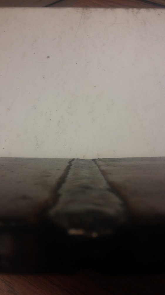

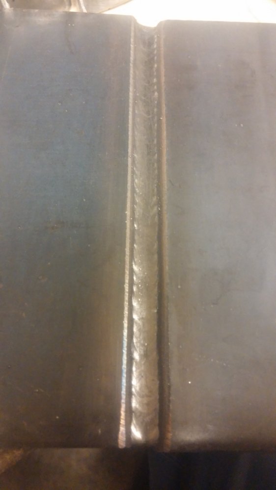

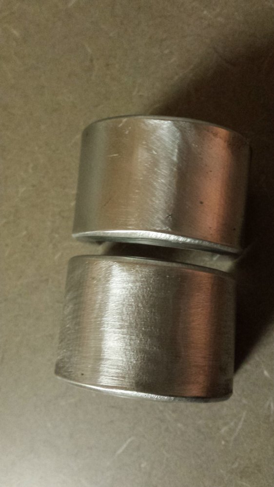

No pretty dimes of the stacked status but, I did take time tonight to do an experimental bend test on my open root GTAW 3G. Progress. Sometimes you have to see for yourself.
@hurt4x4 You're slacking. Step it up.![]()
1/8" gap, no landing. One root pass with heat on 86, 1/8" tungsten, 1/8" filler rod. One hot pass at 105, two filler passes and three caps at 110.Nice! But if you gonna bend it might as well make it count
Just out of curiosity, how many passes did it take you?
open root no backing? Either way good job. I am teaching a new batch of student right now. It is amazing how some people catch on compared to others. After about four classes of 3 hour lab time I can usually pick out the ones who are going to make good welders in the Gtaw process. I have seen plenty who can't make the transition from other forms when they are taking Gtaw last. I wish it were mandatory to take it before all other processes.1/8" gap, no landing. One root pass with heat on 86, 1/8" tungsten, 1/8" filler rod. One hot pass at 105, two filler passes and three caps at 110.
The school I'm going to allows me only a SMAW, GMAW and FCAW cert for the curriculum and time I paid for. I flew through that in no time. I'm prepping for any GTAW test I'd be asked to take to get on with a company, minus the pipe stuff. The shear enjoyment of tig itself is why I haven't just graduated early.
Yes sir, no backing. That was vertical position and at the same time I was running the 4g overhead same procedure. The way a pipe welder explained it to me is when tig welding, either walking the cup or dapping, you look for the "click" made when the filler puddle fuses to the base metal. If you can grasp that, youre good. That is what I've passed onto other classmates and it always seems to help it all makes sense. One thing I'll say, after doing tig, going back to stick or mig seems way easier than before. Puts a whole new meaning to watching the puddle.open root no backing? Either way good job. I am teaching a new batch of student right now. It is amazing how some people catch on compared to others. After about four classes of 3 hour lab time I can usually pick out the ones who are going to make good welders in the Gtaw process. I have seen plenty who can't make the transition from other forms when they are taking Gtaw last. I wish it were mandatory to take it before all other processes.
Yea like the student who told me: I have never saw the metal melt before!. Referring to the puddle. I didnt know what to say.Yes sir, no backing. That was vertical position and at the same time I was running the 4g overhead same procedure. The way a pipe welder explained it to me is when tig welding, either walking the cup or dapping, you look for the "click" made when the filler puddle fuses to the base metal. If you can grasp that, youre good. That is what I've passed onto other classmates and it always seems to help it all makes sense. One thing I'll say, after doing tig, going back to stick or mig seems way easier than before. Puts a whole new meaning to watching the puddle.![]()

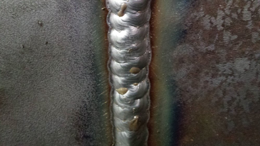

I love dual shield wire! I just started messing with it last year and really enjoy it. My only problem with it is all I've run has been .045 at work and it requires such a large machine to run it. I wonder how some .035 E71t-1 would run in a 250 amp welder at home. I'm much more confident with these welds than mig. It seems to me like 7018 rods on a roll!
