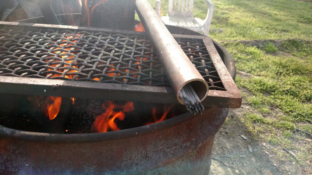

I guess this goes here.
7018 cooking. In DOM.

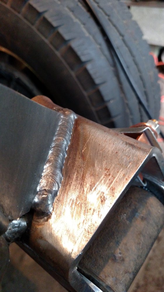

Some mig from today.

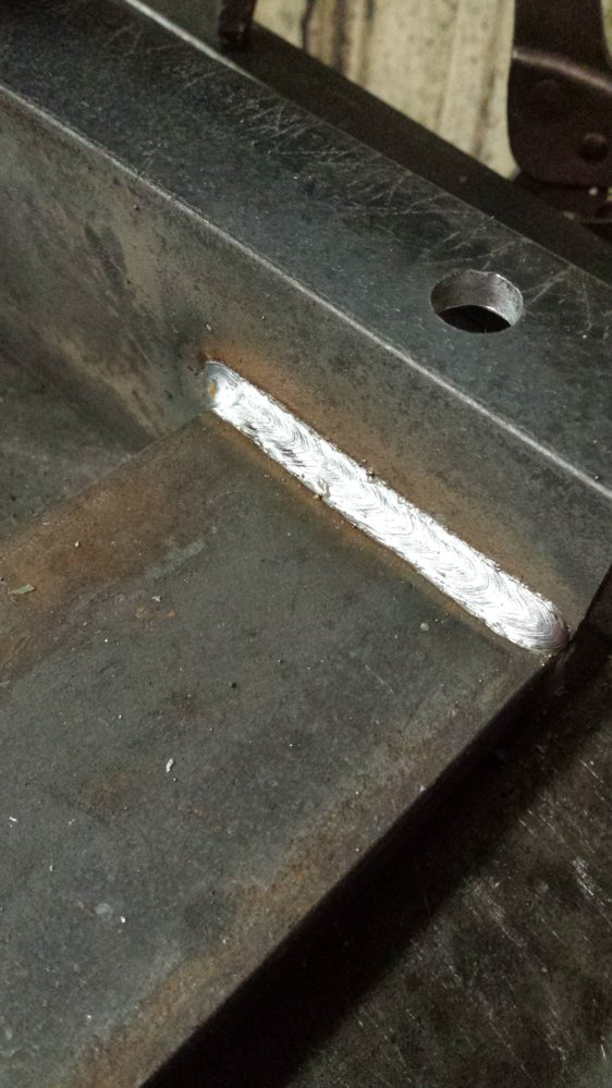

5/8×3" with around a 3/16 bevel, To 3" C channel. This is the 2nd pass.
All for a coffee table..

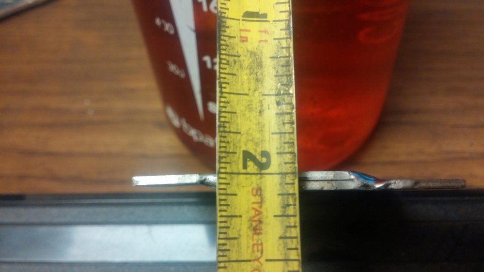

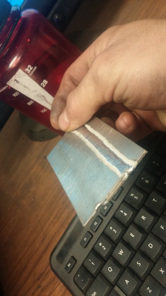

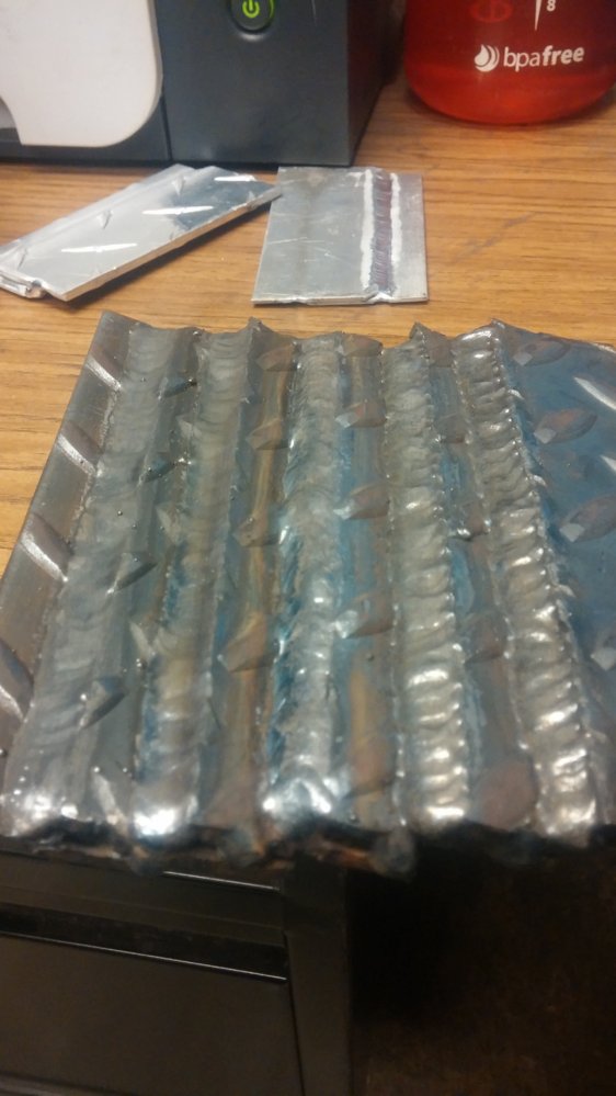

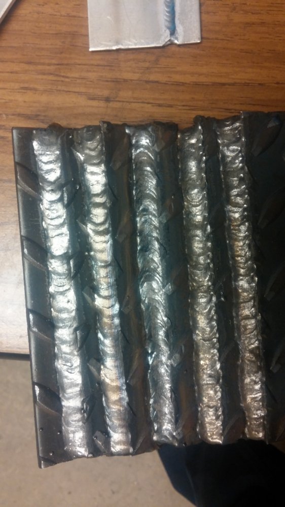

Messing around while students work on cutting project. Outer Shield.
1f,2f,4f,3f, and setting up machine 3f. Left to right.
Same plate
Flat, Horizontal, Overhead, Vertical Up, Verticle Up........for the nonwelder speaking.:D

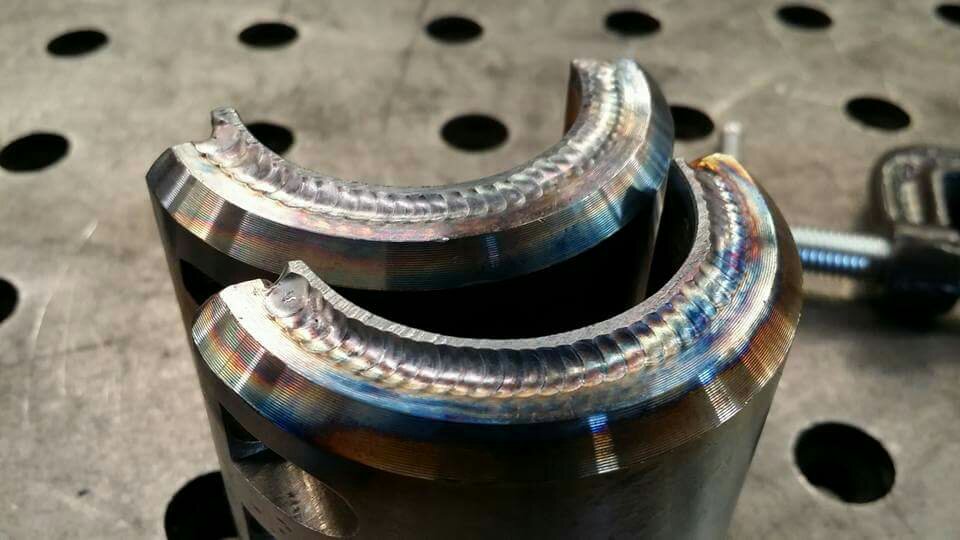

These caused some headaches but the students are learning to pulse and set it up.

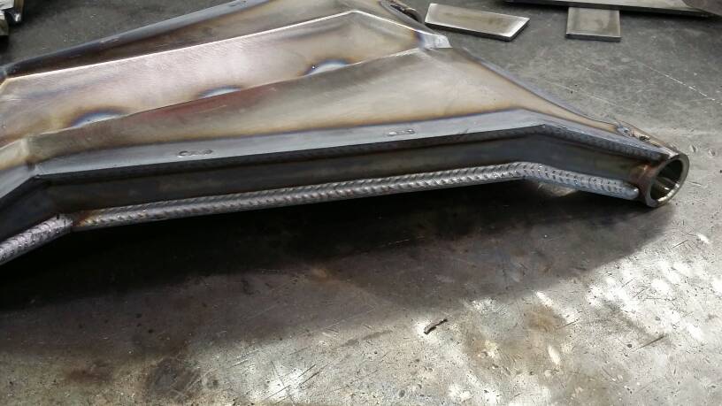

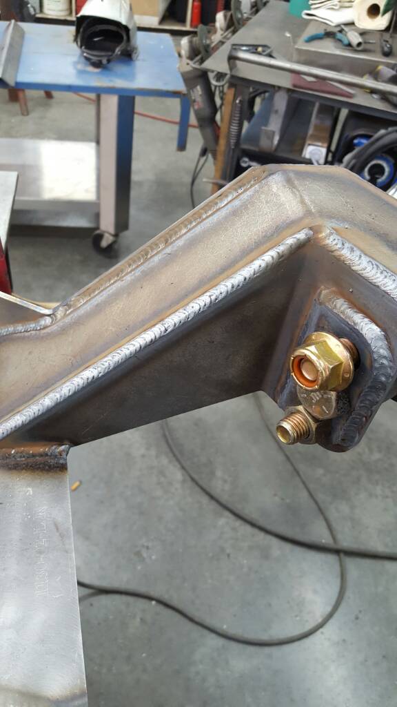

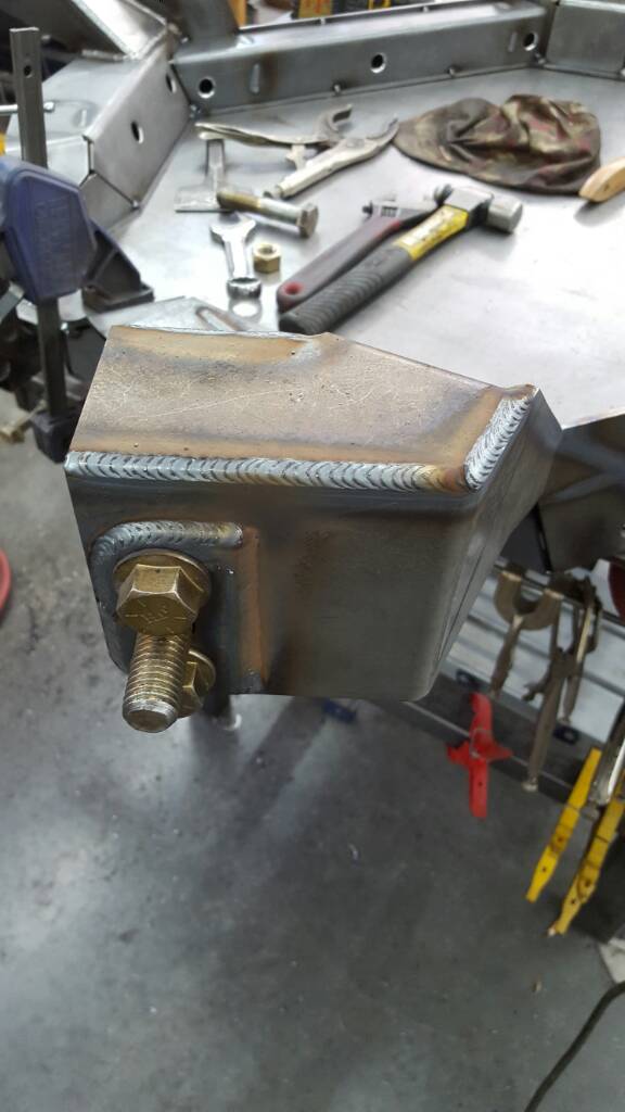

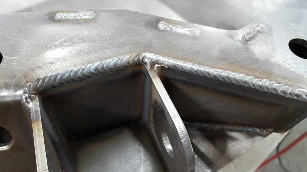

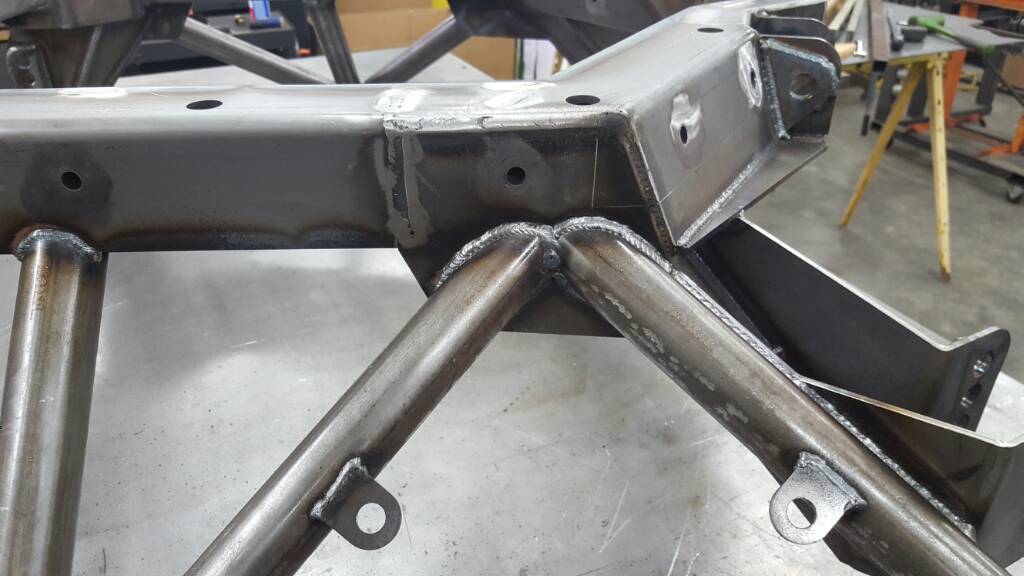

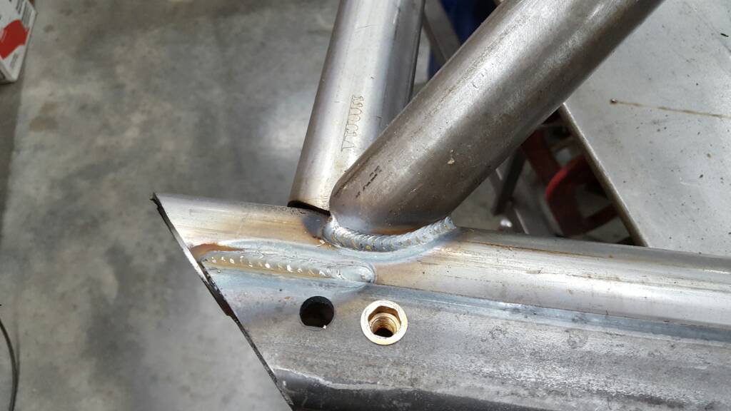

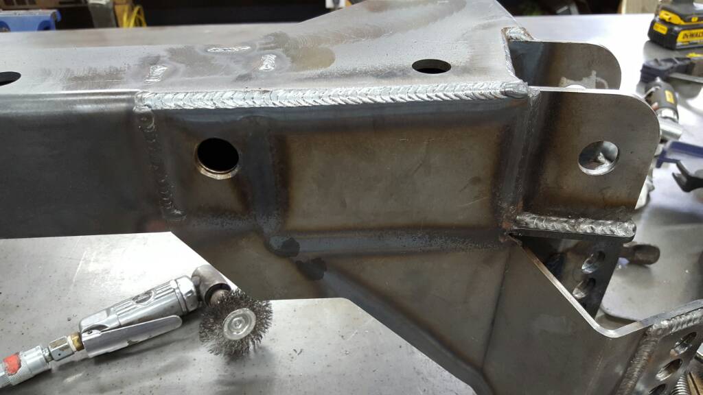

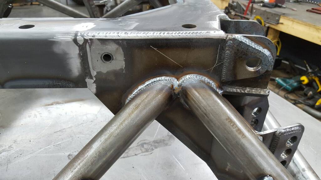

I wondered when you'd start mig welding those. Your TIG welds looked awesome too but I think the MIG'd arms looks even better. Did you switch it up for production purposes or just to do something different? I'm sure it takes a few hours to TIG up a set of those arms.
Yeah its really just for production reasons. Since they're built from carbon steel it doesn't make a ton of sense to TIG them and it took too much time. The only arms we TIG now are the chromo LT arms
Ooh yeah best welds in the entire thread.

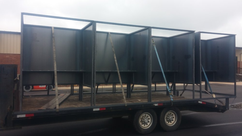

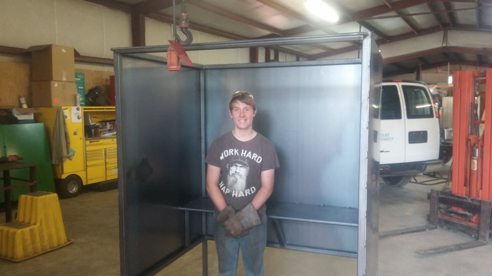

Hopefully some killer welds to be perfected in these booths. I won a small contract for 20 of these for a community college #welding program.
Seems odd that a welding program outsources a welding project
It's called government grant......and a brand new facility with no students to weld.
Easier to spend the grant money than to organize, design, and build them....
Are they doing any fume extraction?
Yes each booth will have its on regulated duct directly in the center of the back wall. It is also suposed to clean filtrate and recycle back to the room. But then I also heard they threw the air conditioning out the window. IDK for sure on that not my circus not my monkeys.But it will have independent fume extraction.
