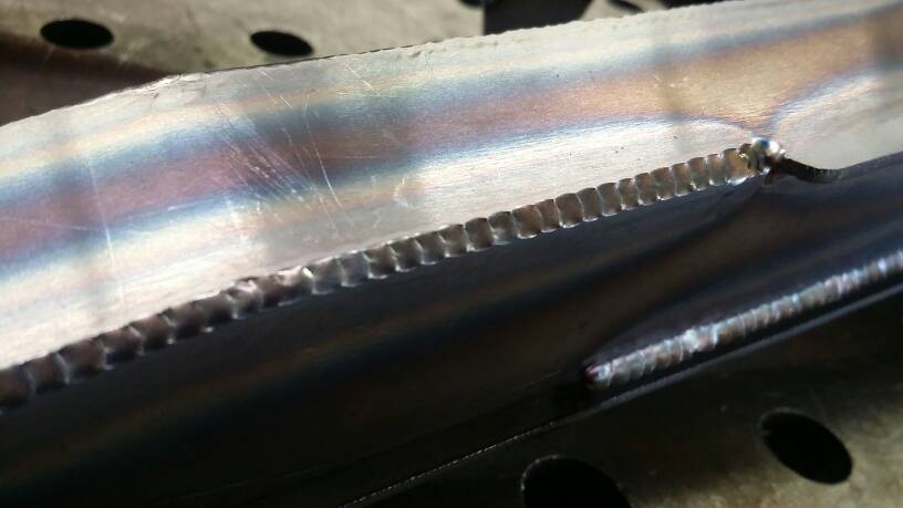

These ouside corner welds always kick my ass. This is .090 chromo. I'm getting better but have a long way to go, I dread these.
Tighten up your dabs or use larger filler rod. You will get a better rounded corner for your weld.
I'll give that a try tomorrow. Thanks for the tip!

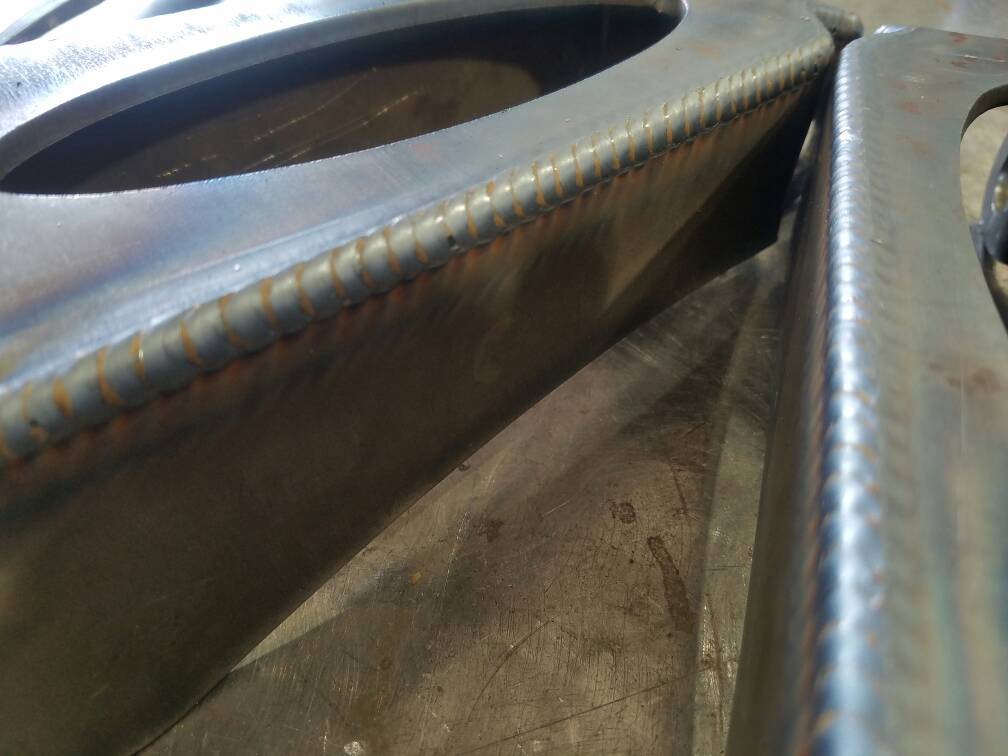

Welcome. I wanna be nosey. Are you using a gas lens? The color on those collar things was tits..
I'm using a plain jane #8 with a diffuser in it. I use plenty of post flow to keep my tungsten alive for longer and to give the color. I have some of the larger lenses but I can't justify the extra gas flow needed to run them. I can with 15 on this cup but need close to 30 on the big gas lens.

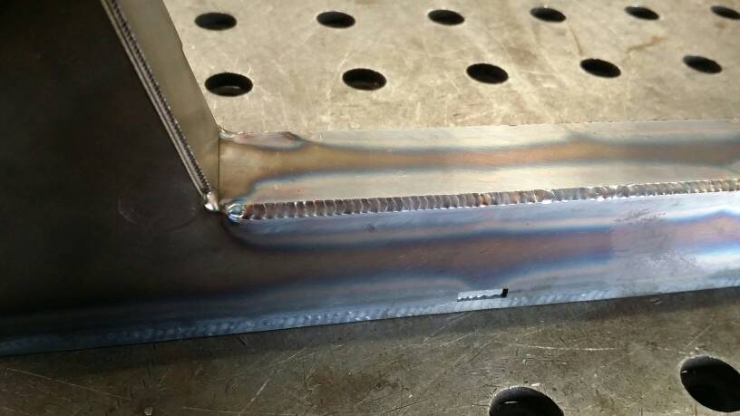

I have very little luck getting nice color in my welds. I either have to move so fast that I can't get enough filler in the puddle and it's way to concave or I have to keep my heat so low that I end up cold and can't get the puddle to flow.
I use a #8 gas lense for almost everything. The best luck I've had is doing a heavy fill first pass then a no fill cap pass with low current to flow the the filler out wider and shape the weld. That pass will sometimes have nice color, others will just be a nice even silver color.
How much strength does the color add?:gay:
Pretty much if it's a TIG weld and it's a dull grey it's too much heat, gas coverage can't make up for that. You're looking for a shiny finish. This is my experience.
I run post flow for no less than 4 seconds when I tack. All of this .090 and .125 stuff is set at about 8 seconds, sometimes longer depending on the area. It really helps keep the weld protected till it cools and give a shiny and slightly colorful finish.

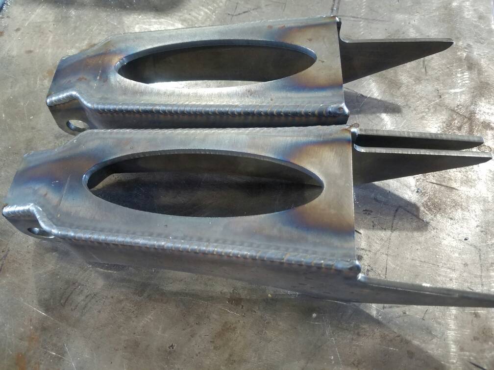

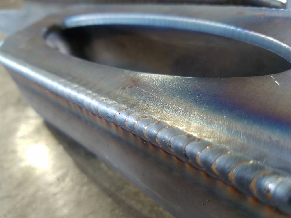

Tried ramming more filler in it and trying to tighten it up some. Getting a little more comfortable with it, pretty happy with the end of the weld. Weld width is right at .125"
What size filler rod? Be a toss up between 1/16 to 3/32 for me. With your spacing I would choose the larger. And a joint that size 3/32 to 1/8 for the tungsten pending how many amps I was pushing. And post flow is the most over looked topic for tungsten preservation. Often it stays hotter longer than the base material and susceptible to contamination. I Love welding parts like these.
.045 filler ER80S D2, I'll try 1/16" and see if I can still control the puddle.
3/32" tungsten. It's set at 80 amps. I'm probably running no more than 60 on it, I've never come close to matting the pedal.
Thanks for your help. I'm always trying to improve
3/32 is my go-to filler. I find it works for all but the heaviest or smallest of pieces. General rule of thumb is to run the same diameter filler as your tungsten. Unless you're shoving a bunch of filler in per dab with 0.045, you're not getting a much stronger weld than if it were a fusion weld on thicker materials.
