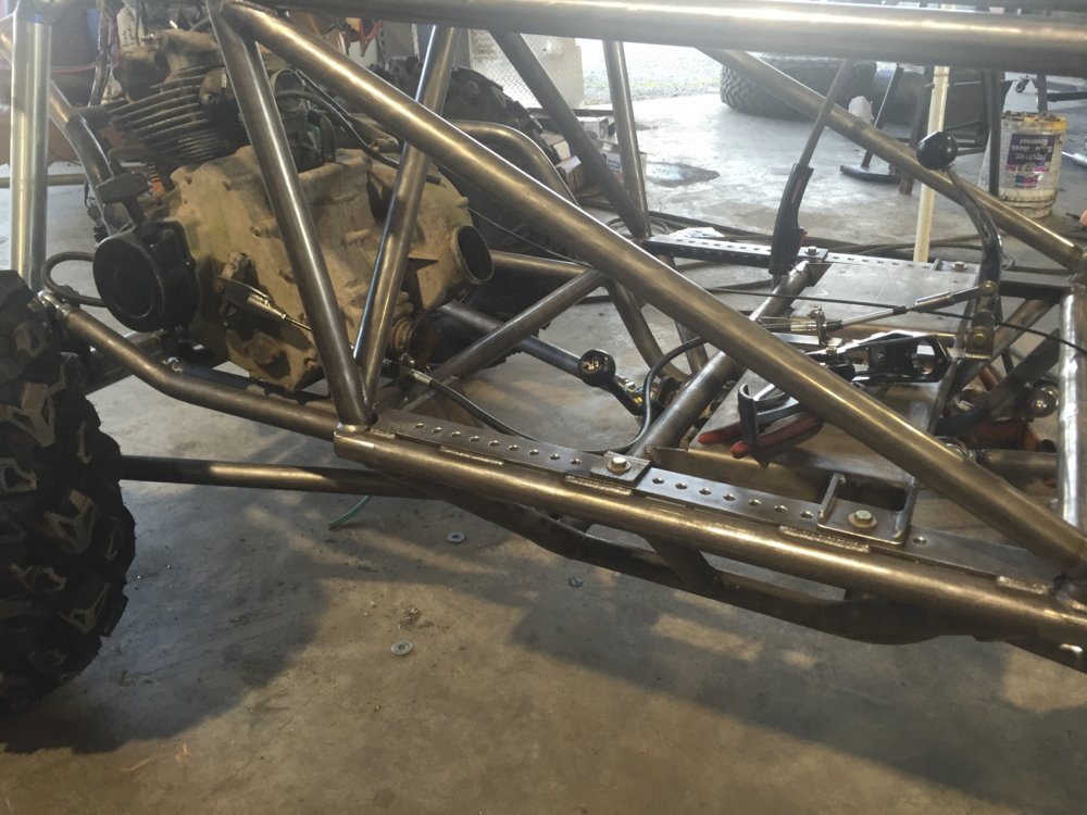

The ATV trans is now cable shifted to a nice repurposed polished hurst shifter, the brake master and pedal is mounted, most of the tabs are on for the body panels to mount to, I finished out the rear taillight area finally and a couple other small things. Nothing really photo worthy yet. I do however have a large pile of parts already here from Rob waiting to be fabbed up and or installed.

Shifter done.

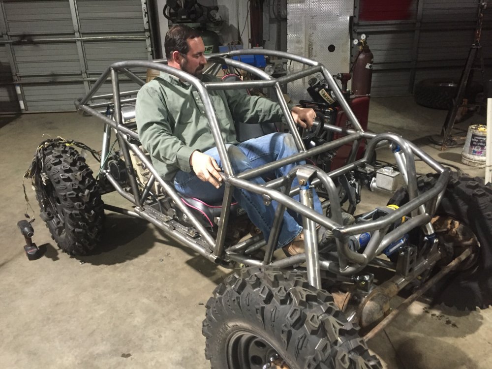

Checking out the buggy. Laying out several of the finishing touche like exhaust and a custom heater with duct and variable speed motor. Yes, this is an air cooled motor :D
My god you are a giant!!!
I'm gon show this pic to the guys at work and tell them its a regular sized rig. Haha its looking good!
Ugh! Please don't tell me that. We were trying to stay AWAY from looking like a bug but still keep the curved roof. I saw a lot of others that did look like a bug and I think we steered away from that look.
But either way, it looks good.
