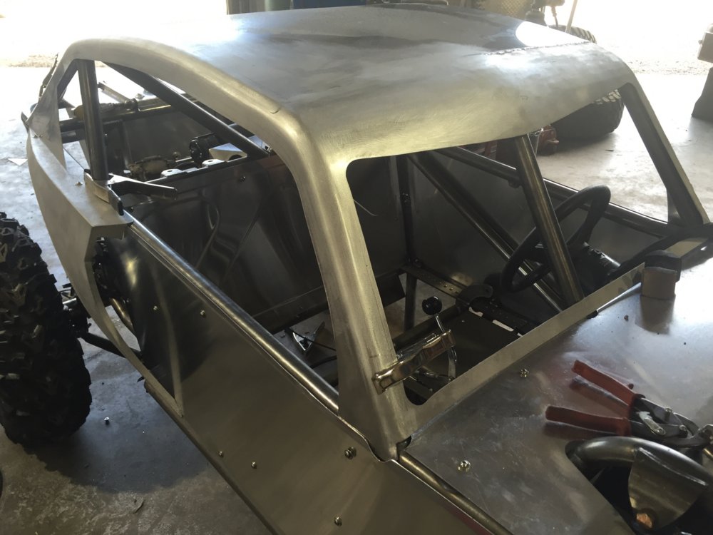

Needs gt40 bubble

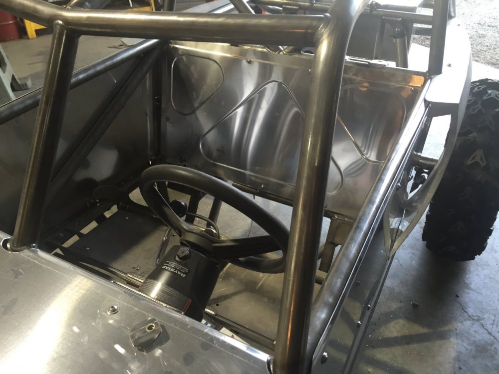

So... It's no secret that Rob bears a strong resemblance to his Sasquatch forefathers... and it's impossible to get a sense of scale otherwise from the photos. So what's the theoretical maximum drivers height with helmet and 2-3" clearance?

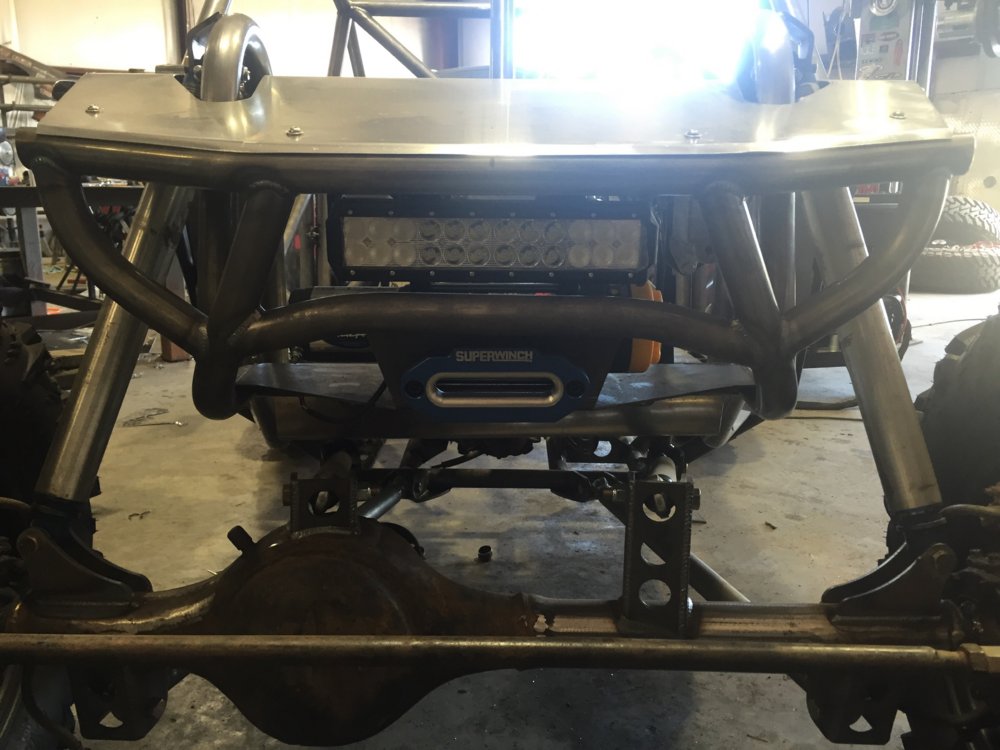

Front LED light mounted...

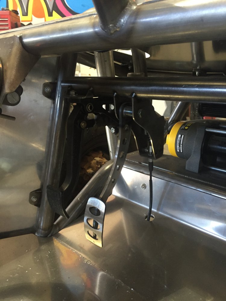

Brake and go go pedals mounted. Chris @MarsFab fabricated the gas pedal, bracket, linkage, etc, 100%.

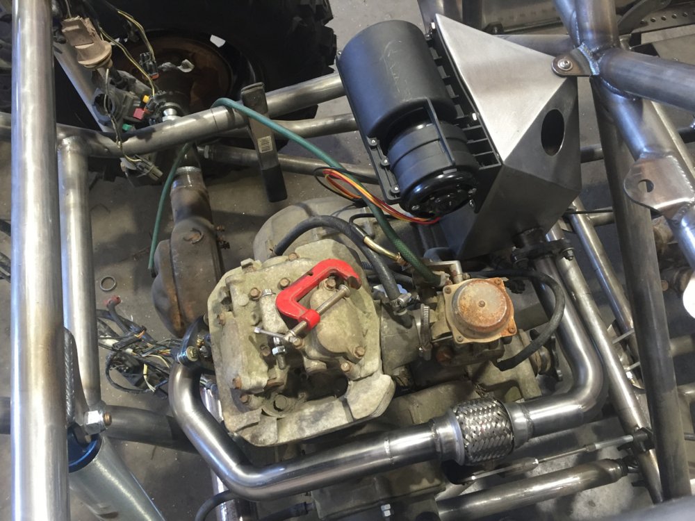

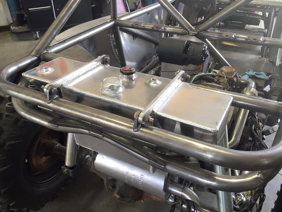

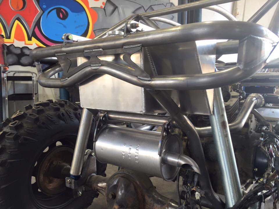

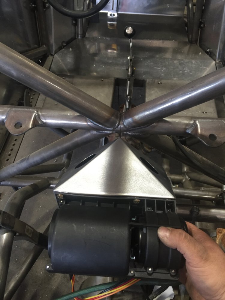

Because twin girls are, well, girls, they must be comfortable as best as we can. This includes heat on those cool spring and fall wheeling days. The ATV motor is air cooled so this created a challenge. We borrowed the idea from a VW bug for its heat and created a heat exchanger box with a blower motor. We used the same blower motor and switch setup as what is in the universal heaters from Summit/Jegs/etc. it's also the same blower for the heater in my buggy. Should make working on mine and mini easy and parts sourcing a breeze.
Basically, Chris snaked the exhaust into a custom box in an "S" shape to create as much surface area as possible. There are 2 blower mount locations; one on the top for less heat and one down real low. Weren't sure if the lower mount would be too close to the exhaust tubes for the blower or create too much heat, so the upper mount location was created as an option.
