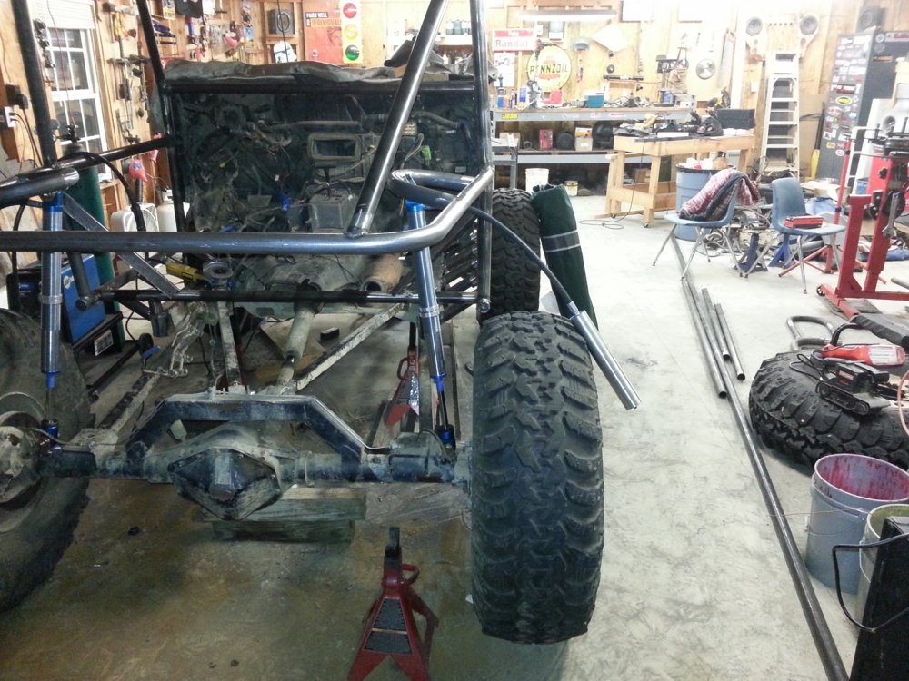

Two years ago, I made the jump from basic TJ on 35's to 1 ton axles and 40's. I stretched the wheelbase 12" and went with coilovers up front. The project went over budget and I had to make some concessions to finish and not end up with a 3 year project. The time has come to finally "finish" the rear the way I originally intended.
Goals for this rebuild...
1. Back half with coilovers, looking for more uptravel out of the rear
2. Better visibility from the driver's seat
3. Redesign the cage
4. New flat dash
How it sat 2 years ago.
How it sat 1 month ago

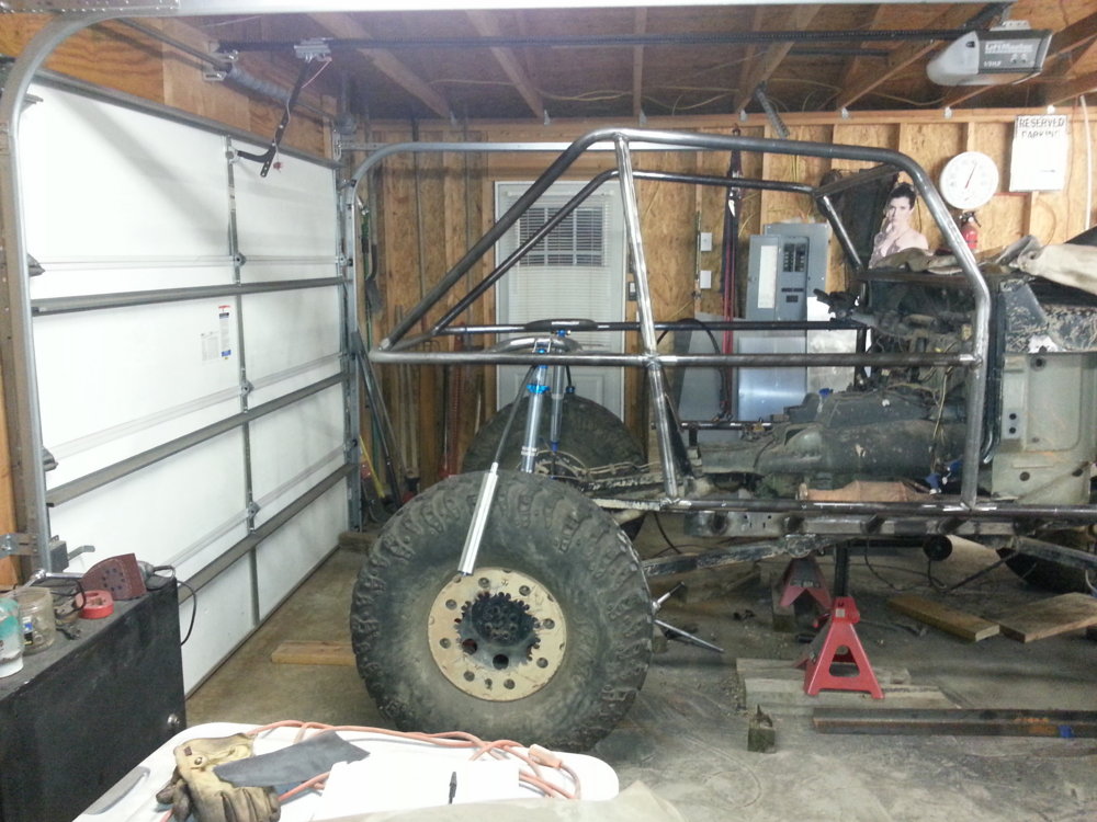

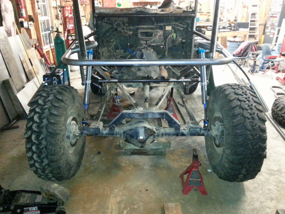

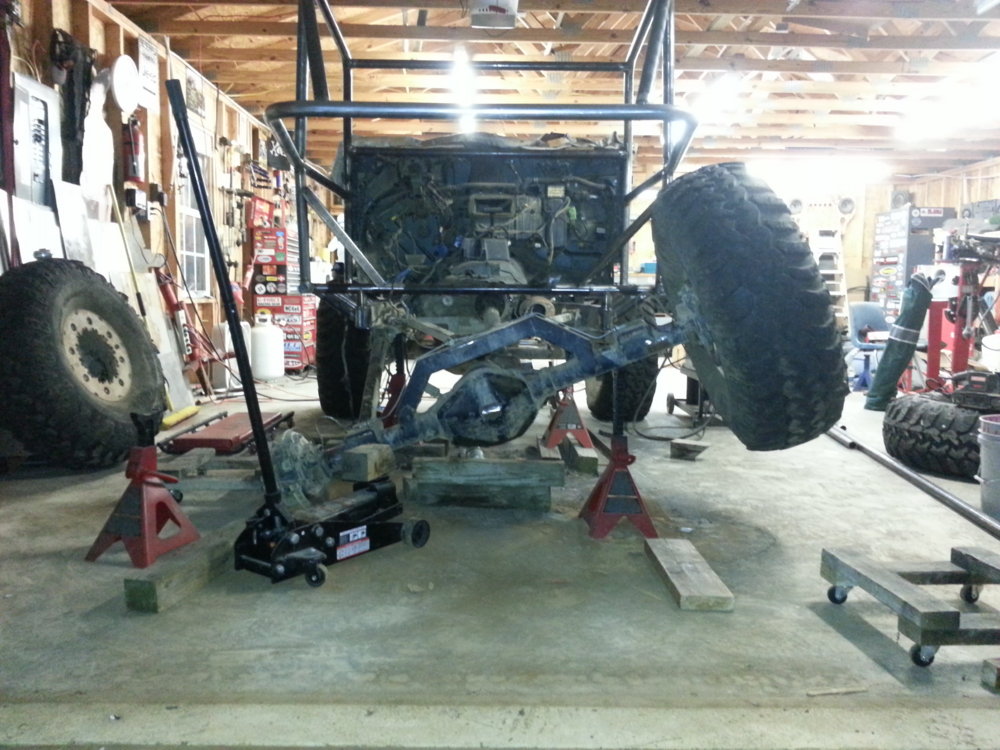

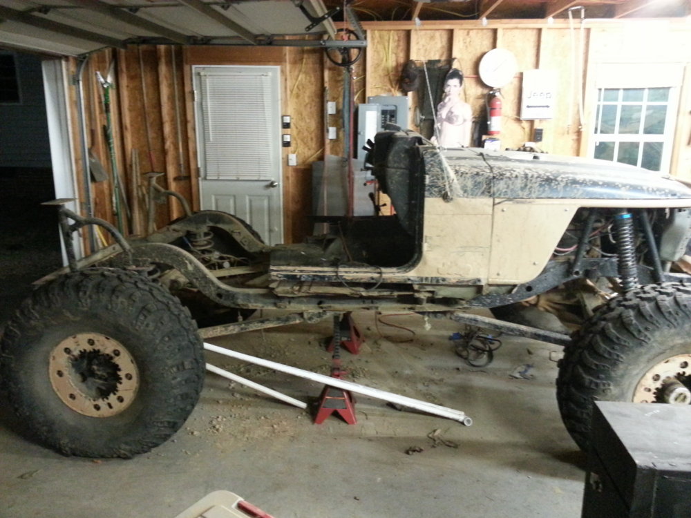

How it sits tonight ready to start cutting
