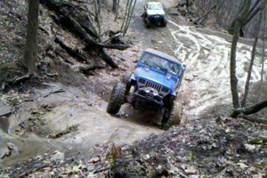

the first try (pictured) didn't do to well on all the ice. Couldn't get the back tires up onto it to really give it a go.

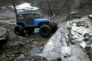

Went back that afternoon and was able to get up in 3 tries after all the ice had melted. I pretty much crawled up that afternoon when i found the right line all the way over to the right, after just barly bumping it to get teh back end up on it.
The 2nd waterfall, or step up, thats like 3 ft or so tall, just a single step, I had a harder time on it, but just bumped it hard with the back end to get up it.
Had alot of fun though. I totally feel like an idiot for asking where it was on welder... I definitely drove right by it my first time up there. Thanks for the help with that.
