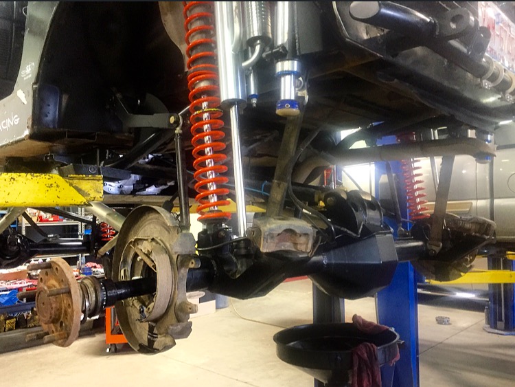

Working with 4 Wheel Parts and ECGS trying to pin down some noises and vibrations in the drivetrain. Pinion bearings were on their way out, so I'm having everything inspected around them to make sure it will be nice and smooth for the carpool lines at school. Ryan and team at 4WP has been on point with stellar communication and Chase and the ECGS crew are doing what they always do well- fix my junk lol.
Out of curiosity why not push the front axle out a little more for more wb and better approach angle? It only looks a couple inches from stock
I've thought about it a bunch, but ultimately the labor involved to set it up so that I gained an extra 3" was just too expensive to really do it right. It's so tight up there with the 2.5" coilovers, keeping the +\- 14" of travel was going to take a ton of engineering with a front stretch. At least that's been the feedback from some of the shops I have spoken to about it.
The jeep is around 105" to 106" right now, too much longer starts to make it tough on break over angles with the 37"s (for me anyway).
