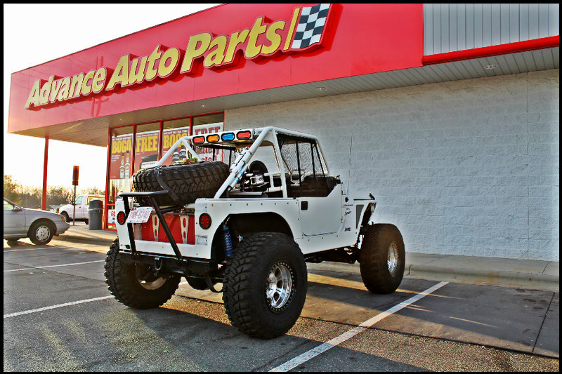

I was laying out in the sun today working on my base tan for California and couldn't resist the urge for a little pre-running. 70mph went as smooth as a Lohan court appearance. One of the quickest trips to Advance Auto I have made all week.

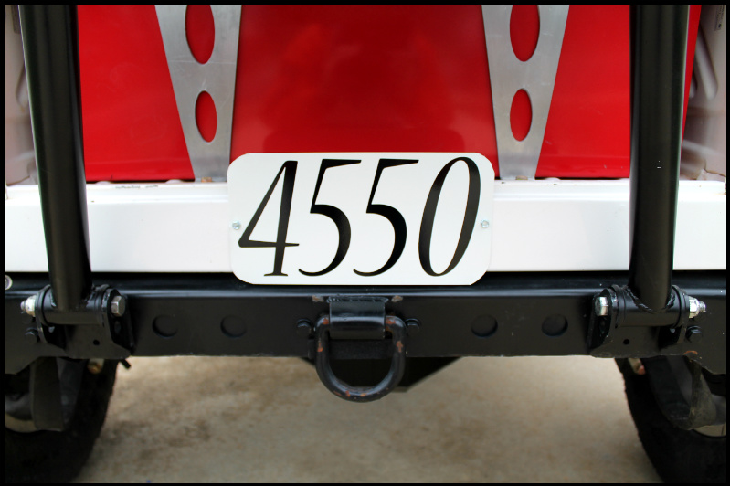

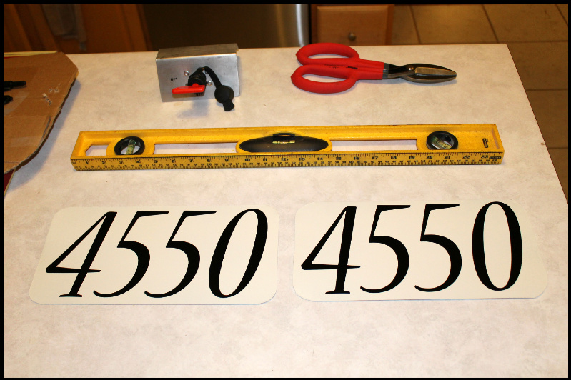

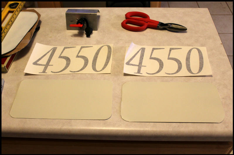

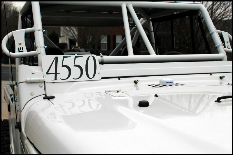

Getting the numbers finished:
alh3.googleusercontent.com__0bEViCC8nU0_UQLx_DRYKLI_AAAAAAAAC9497af6cc49835d556f8356fdcd3efa4d.jpg
alh6.googleusercontent.com__Mo67b6kZyJs_UQattEu_yCI_AAAAAAAADAf78858e28ff005342aa7e233b300634b.jpg
alh4.googleusercontent.com__SR7rPgc6OIY_UQatsQ2snqI_AAAAAAAADA4270f59e7a80e1368471226c5e3a584e.jpg
alh3.googleusercontent.com__eTDpMvLqBWE_UQatuIocjsI_AAAAAAAADA2ad749872599e437dbe4b3658edd008f.jpg
alh4.googleusercontent.com__R3Ago56CLM8_UQauXU9MAbI_AAAAAAAADA0fb839f133190c36e7ad9db173a8f051.jpg
alh3.googleusercontent.com__P2QP5bYnKoc_UQauWu0agII_AAAAAAAADA98f67dd9450ad9b45d4b37c61623892f.jpg

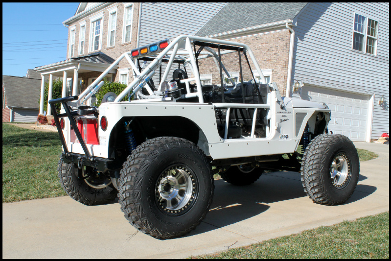

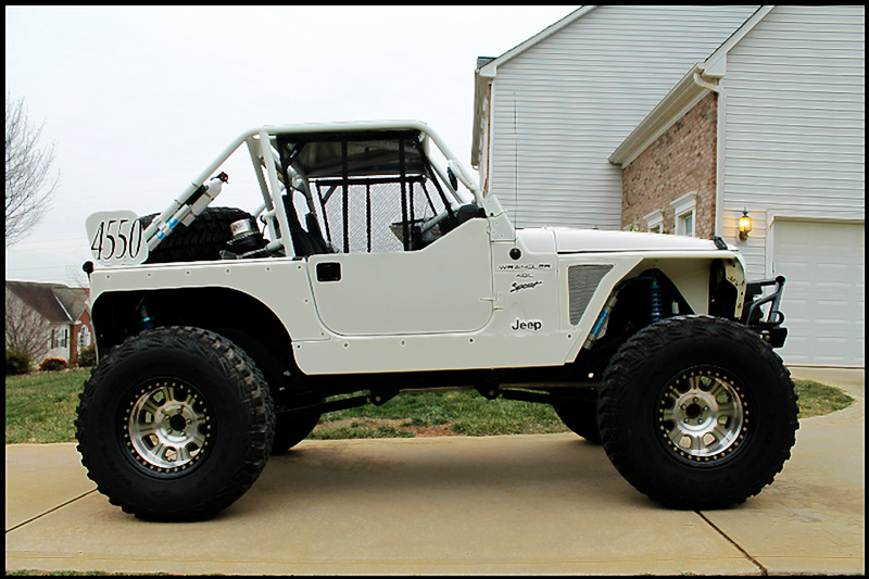

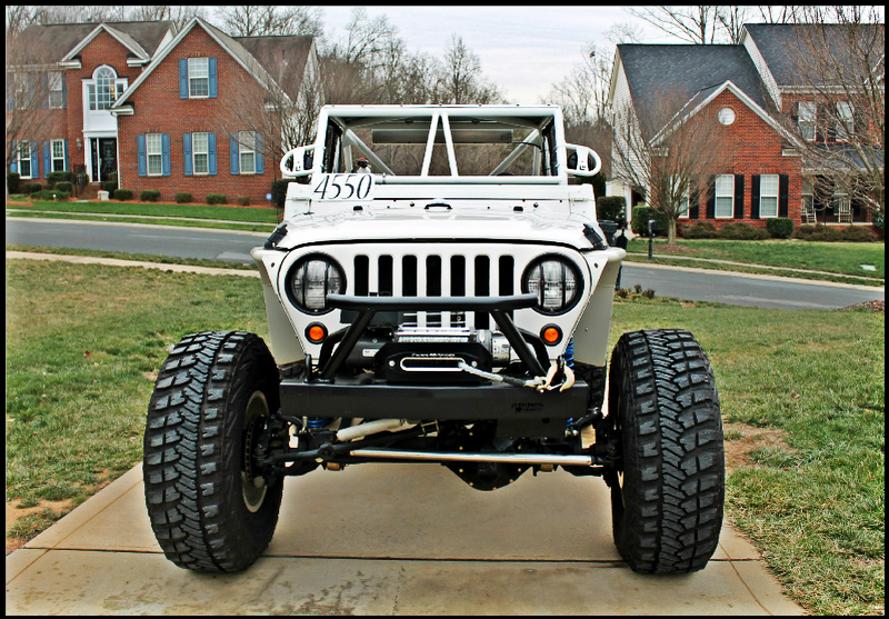

did you brace your front axle knuckles? if not have them weld that in cali also..
They are already braced as much as I can get them. Front axle is a Rubi 44 with ARB, Alloy 4.88s, super 44 kit, timken hubs, new ball ball joints, outer C's gusseted, axle tube truss, and Clayton 3 link diff mount (works as a truss too). If a Rubi 44 were to ever survive, hopefully it would be this one.
nice..
you can drive the pin out of the hinge and add the original windshield back with a removable pin.
I still have the full stock windshield for after the race. I'll just unbolt this one and blt the stock one one for daily driving. This, afterall, is literally my daily driver TJ.
look into removing the pin. wheeling without the windshield is great. just pull 2 pins and set it on the trailer.

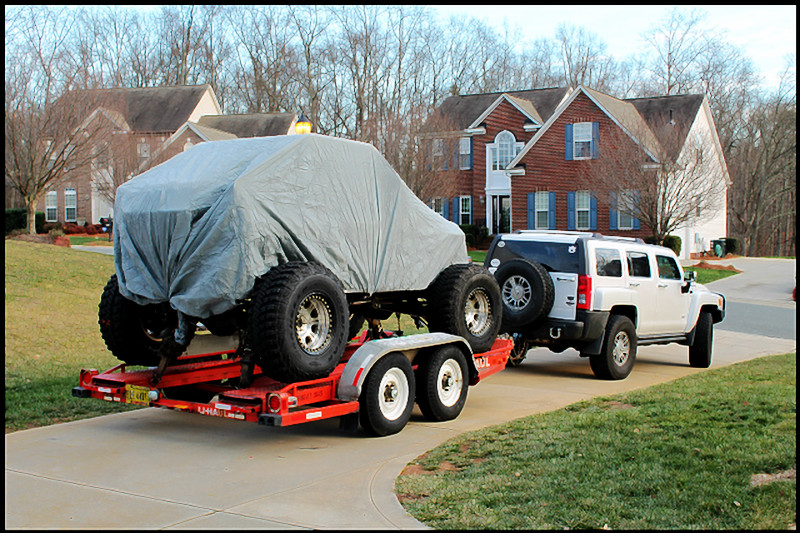

Off to Alabama where Jordan of team 4580 will be hauling it the rest of the way.
alh4.googleusercontent.com__REvI8iSGrXQ_UQa7UGVhWiI_AAAAAAAADBc4b4cc2da8a92ef57958872c8271024b.jpg
Hope u took cover off before towing. If can screw up the paint if you don't
I did a test pull with it and ended up pulling it off.

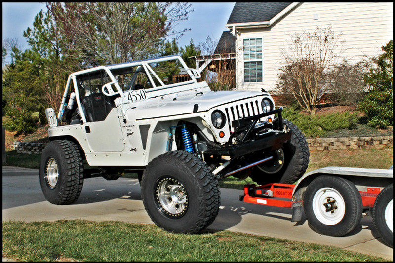

Speaking of test run, I finally got to open it up through some corners and bumps (speed bumps). Lot's of dialing in will need to be done Monday night/Tuesday morning on the lakebed. I have a rear anti-rock waiting for me out there and about 5 other small jobs waiting to be done that we discovered, but ran out of time to do. Main concerns are death wobble, shock tuning, electrical battery drain when car is off, and body roll.
It wouldn't be fun if it wasn't this stressful. Hahaha
Dang, are you going to put any spacers under your tires? Looks like a lot of weight on the tire guard rail. Good luck out there! :beer:
