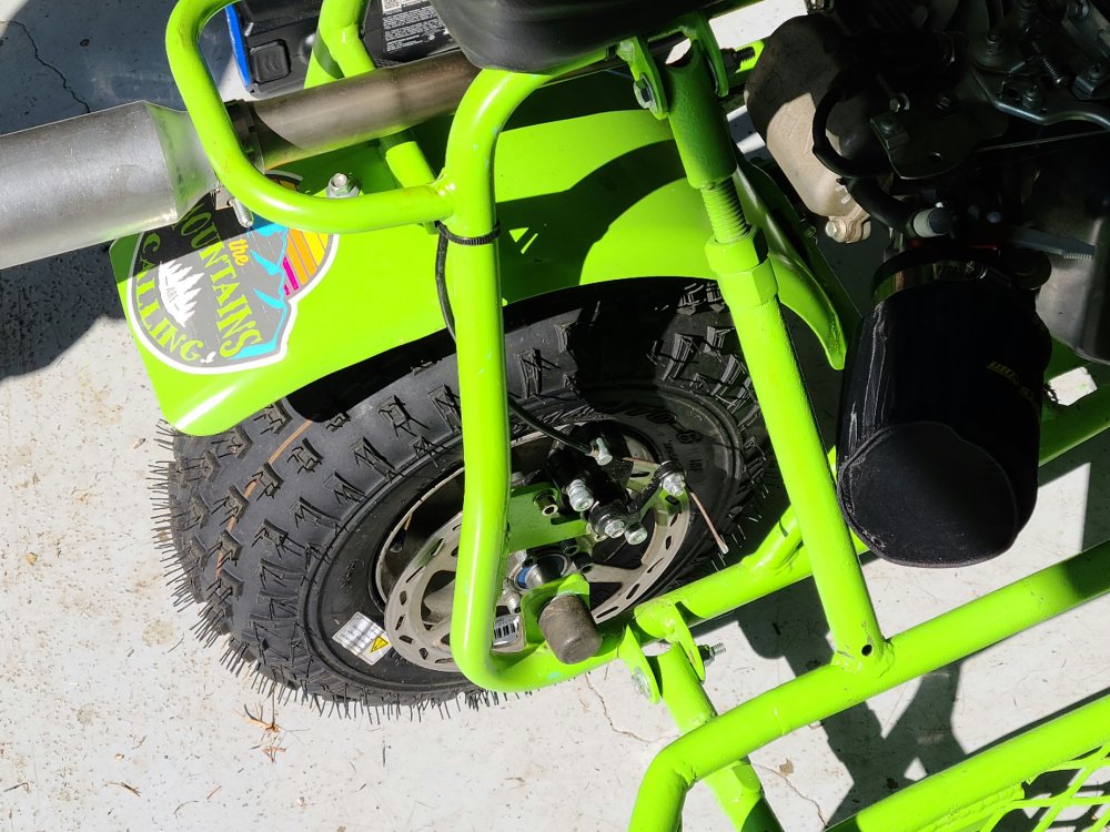

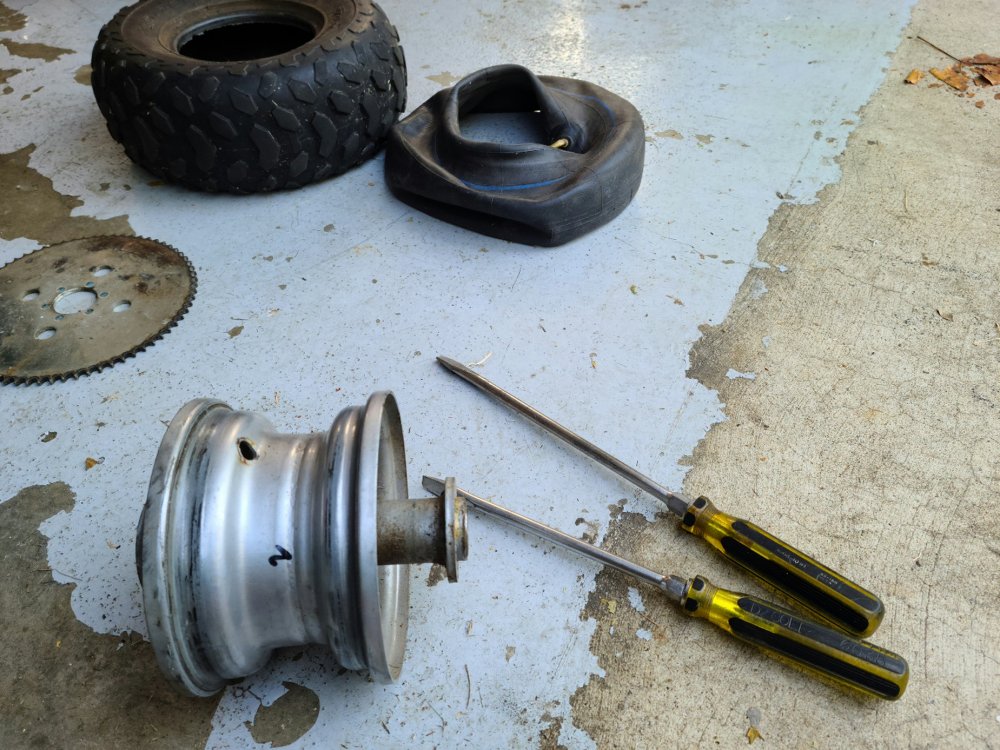

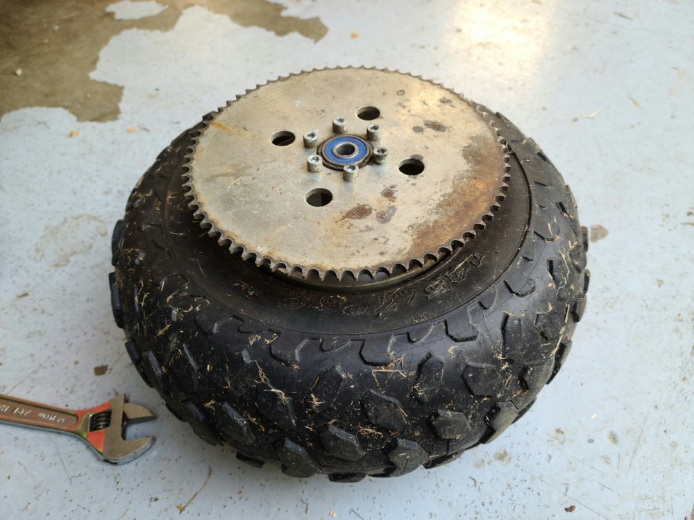

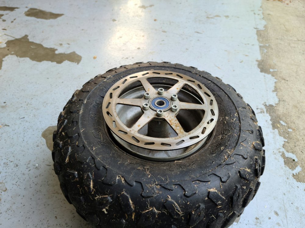

First, take the tire off your bike and remove the the sprocket and disc brake if you're working on the rear tire.
Those are 5mm Allen head bolts if anybody needs to know. To disassemble the tire I deflated it and used the two screw driver method to pop it off.
Here's another tip in case you forget things easily. The disc brake goes on the side where the valve stem is. Next, assemble your tools.

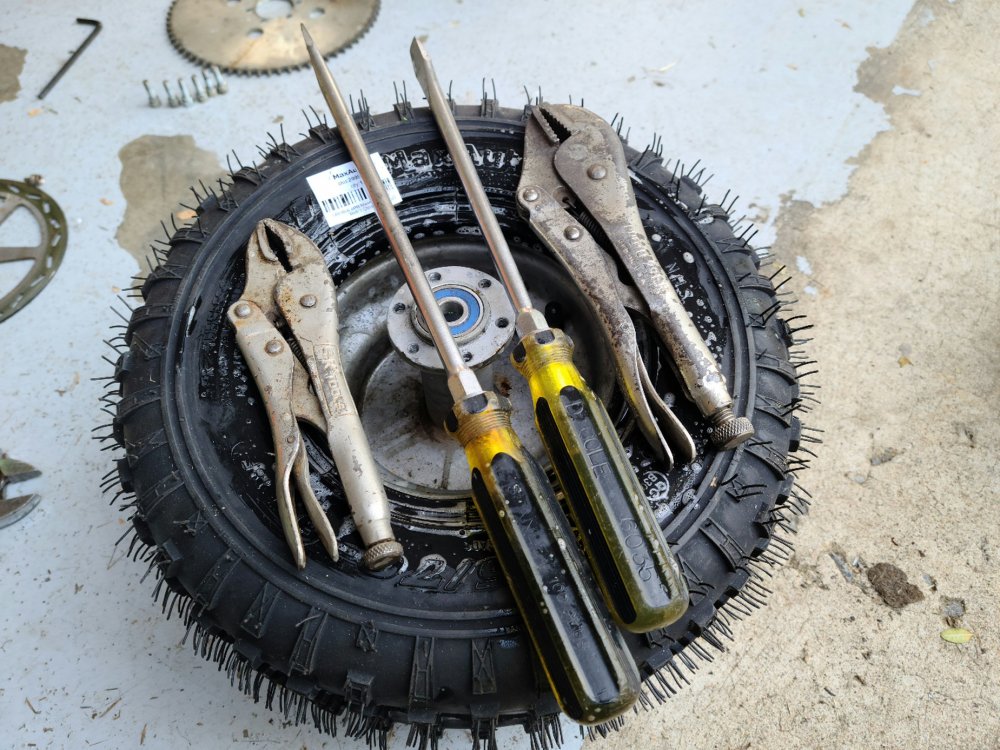

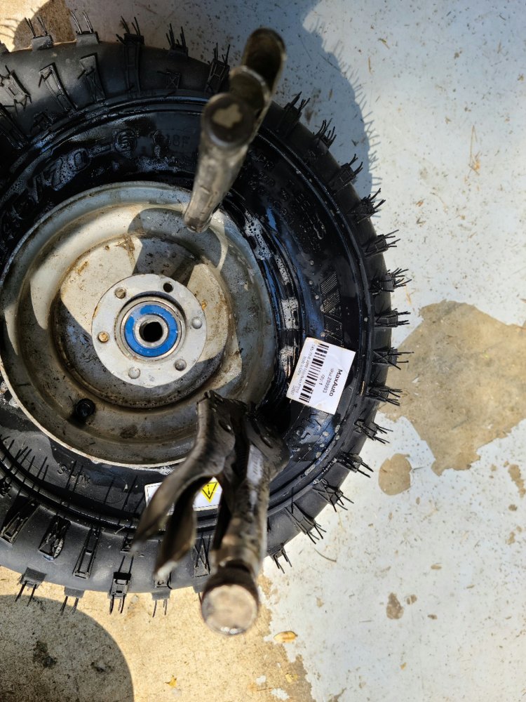

I forgot to take a picture of the tools first so as you can tell, I already popped one side on. Same deal, two screwdrivers. Without going back and looking someone said lube, lube, lube. They are correct. A simple splash of Dawn and water won't cut it. I used a mixture of Dawn and car wash soap. Lube the shit out of it and pop the first side on.
If you have a tube and like to live dangerously then go ahead and put it in. At this point you'll have more room to work. However, this is precaution #1, make sure that thing is out of the way when you start prying on the final bead. Common sense will tell you why.

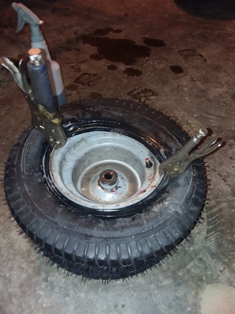

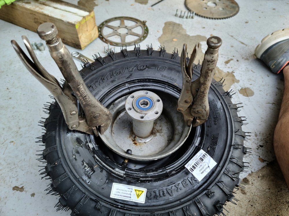

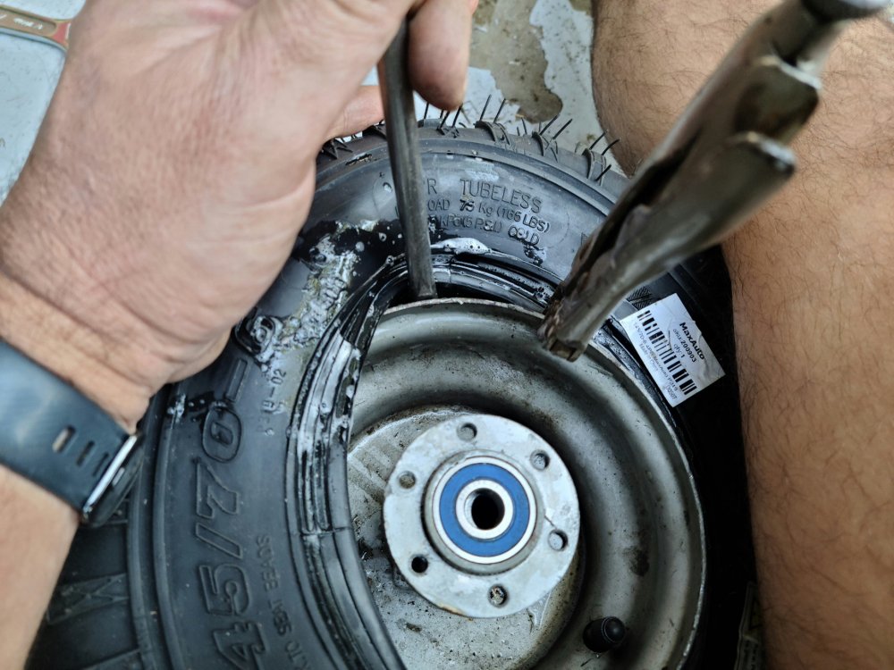

So, this is the issue in my opinion. When you start popping the last bead on it's almost impossible to maintain progress. As soon as you slide one section over you lose that much ground on the other. This is where the trusty vice grips come into play. Get your lip start and place you vice grips like so.

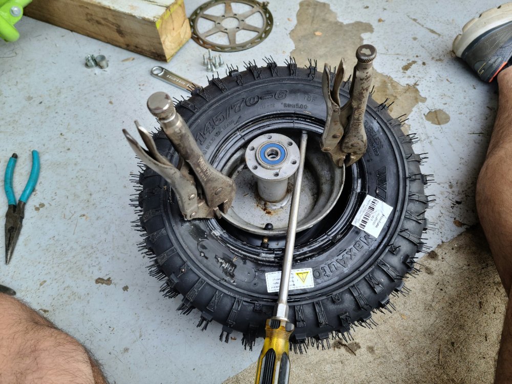

Next, stick your screwdriver under a section and pry. Two precautions here that are also common sense. The old question of, "How do you eat an elephant?" comes to mind. Don't take huge bites. A little at a time is better. Also, sink your screwdriver far enough where you're not leveraging all the force against the lip of the wheel. It will bend...
This is the crucial part. Once you've pried the lip back, hold the screwdriver in place with one hand. With the other hand, release the vice grips and move them towards the screwdriver and reclamp. This way when you let off the tire won't slip back.

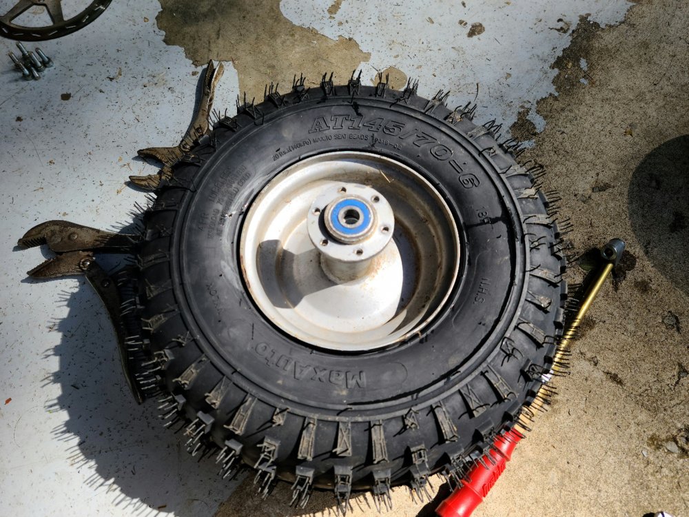

Remember to relube as necessary and continue to work the vice grips around towards each other. You'll finally get to this point...
So close!!! Finally, pop that last section and tell it to kiss your ass. Air it up and mount it back on the bike.
This is how I do it and it's worked really well, at least on these two it did. Your results may vary.

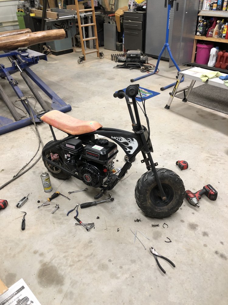

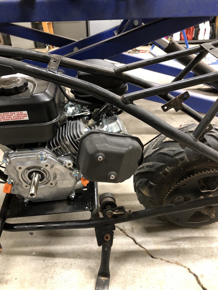

Made a governor bypass rod out of a landscaping fabric stake and got the motor mocked up. Waiting on clutch and chain to show up so I can finalize the mounting position. It’s quite a bit wider than the old motor
Pictured: “Oh stepbrother it’s so big!”
I had to make a custom mounting plate by doing some fancy machine work with a drill and a reamer. I think you've got more resources at your disposal. In the end my adapter/mounting plate was a 1/2" thick.
Just fyi there is a weld on mounting plate on amazon for 25 dollars
Well, at the time (2+ yrs ago) the OGs had to make their own.

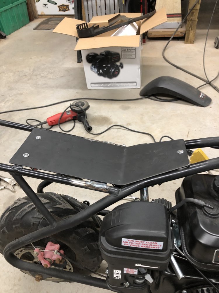

I think I have space to just redrill the stock plate to fit this. In order to fit at all I’ll have to run the clutch backwards (sprocket pointing towards the engine case) to make everything jive. No big deal, the clutch I ordered will work in either direction.

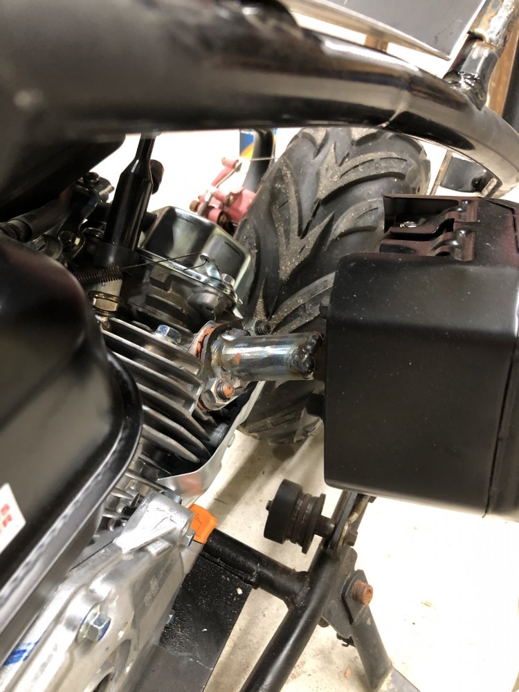

I got my Fuller on today and modified the exhaust to sit lower and point down a little. I didn’t have the right size DOM in stock so I ground the galvanizing off some conduit and used that :lol:
Also made a racing seat pan, or what I like to call a taint slammer to replace the broken stock seat.

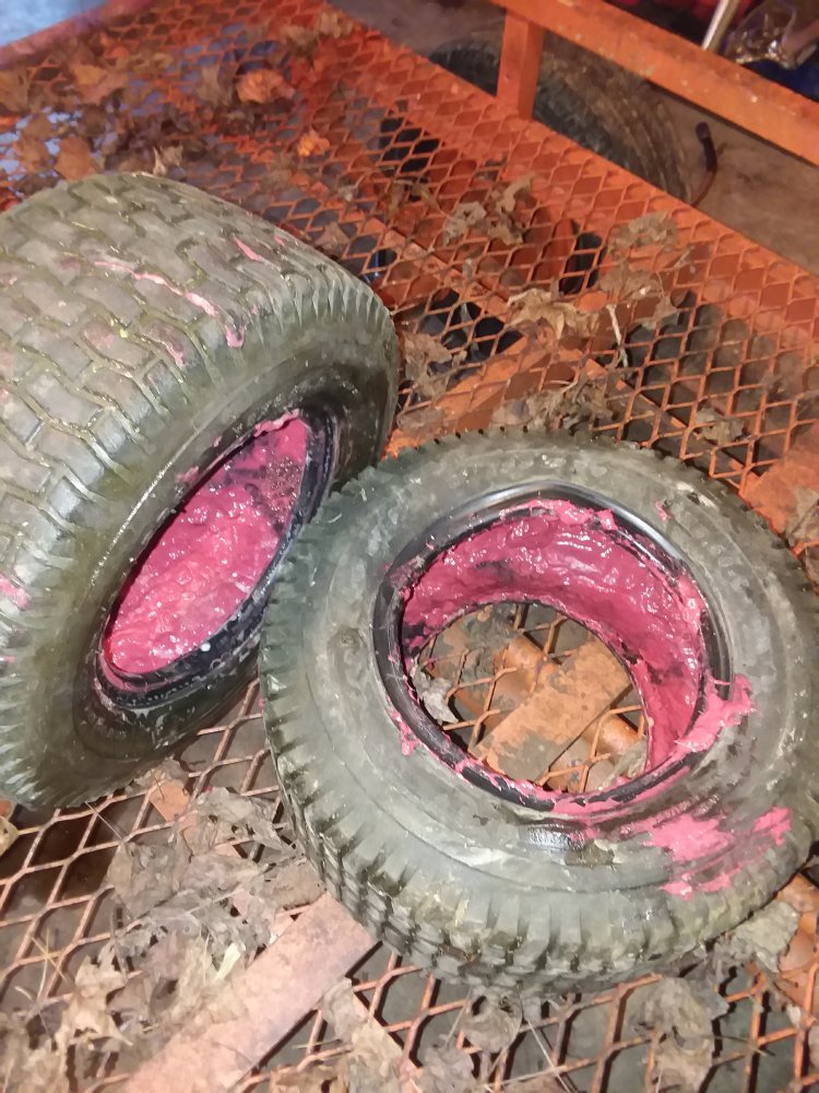

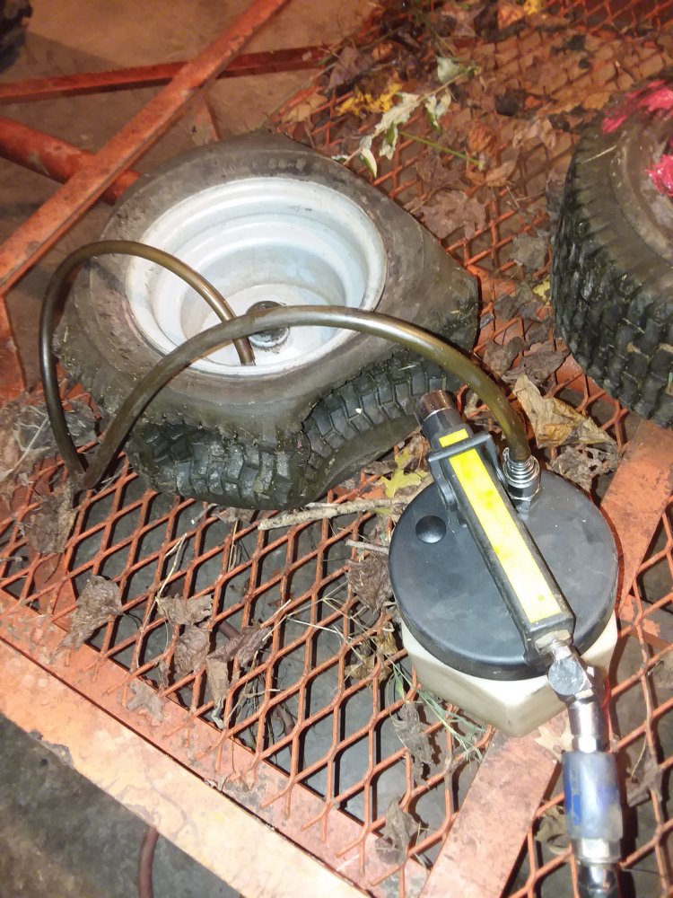

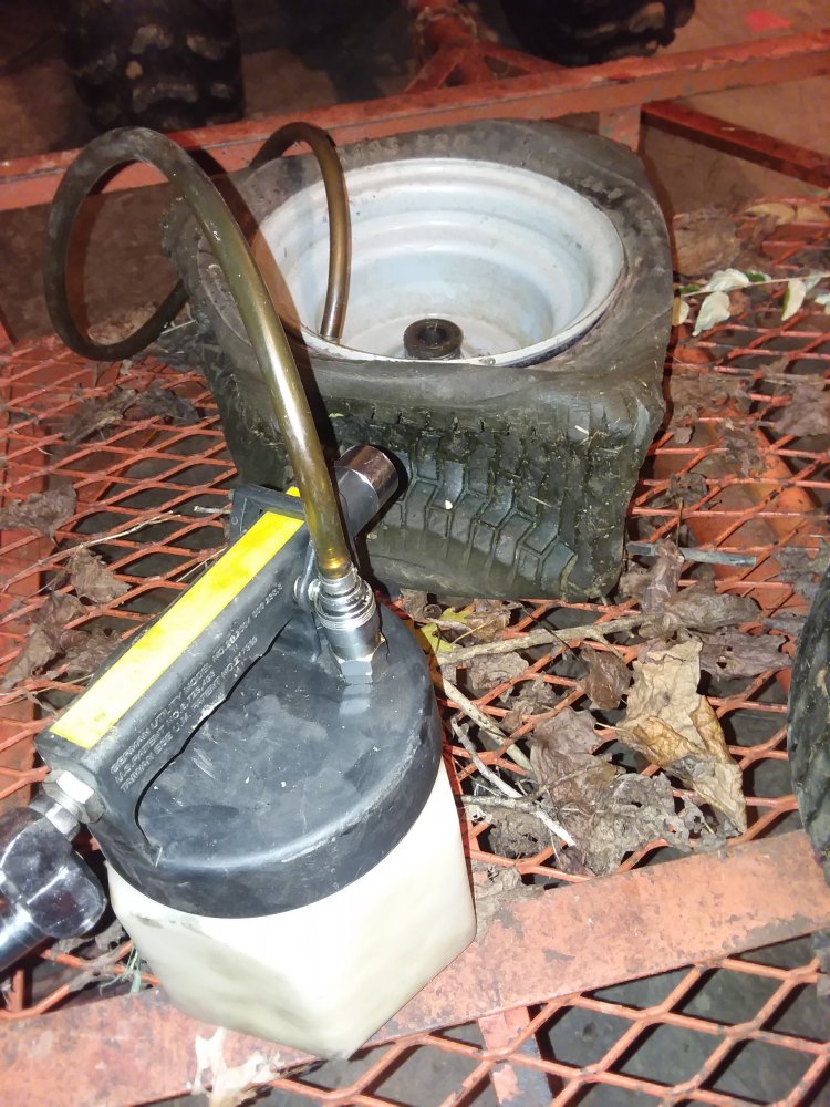

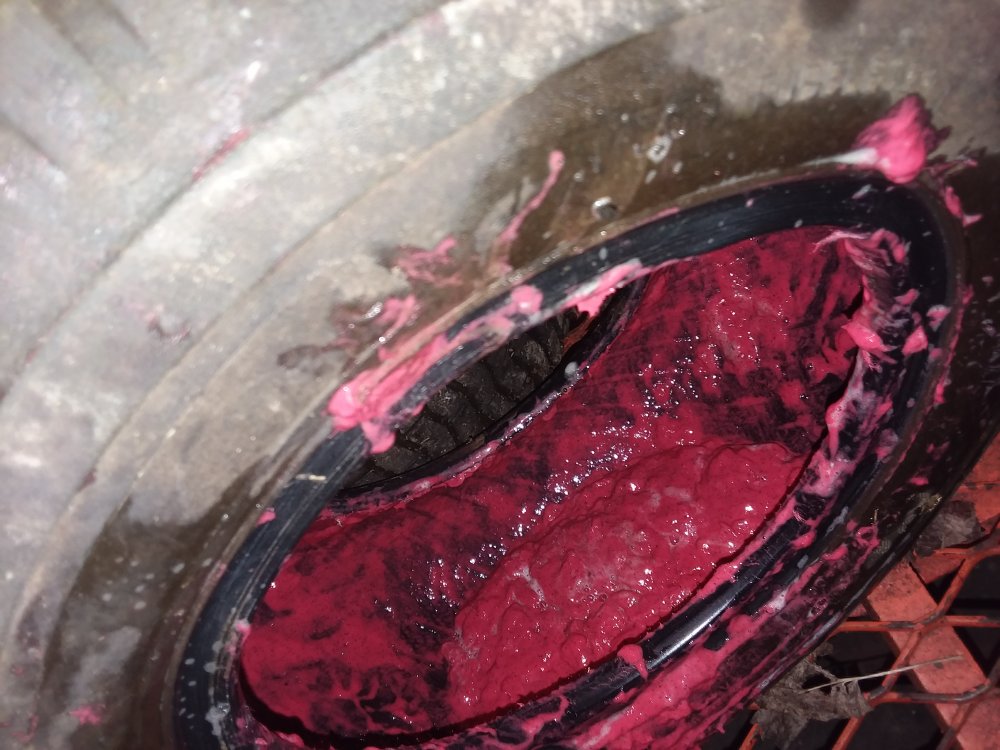

So @McCracken helped me this am!! I was fighting a dang lawnmower tire and remembered his vice grip tip!! Thanks man, that helped out bunches. These new tires are 4 ply and the sidewalls are ridiculous. I been dumping fix a flat in the old tires for years but finally had one the broke a belt so I was mounting tires as the sun came up this morning. I use a vaccum chamber to break the beads an two screwdrivers to remove and reinstall typically but the vice grips really helped from having to grapple with the tire.
So @McCracken helped me this am!! I was fighting a dang lawnmower tire and remembered his vice grip tip!! Thanks man, that helped out bunches. These new tires are 4 ply and the sidewalls are ridiculous. I been dumping fix a flat in the old tires for years but finally had one the broke a belt so I was mounting tires as the sun came up this morning. I use a vaccum chamber to break the beads an two screwdrivers to remove and reinstall typically but the vice grips really helped from having to grapple with the tire.View attachment 328622 View attachment 328623 View attachment 328624 View attachment 328625 View attachment 328626
Nice!!!!! Glad it worked for you :cool: I can't help but remember what an old wheeling buddy of mine used to say...."there's the right way and there's the way that works".
