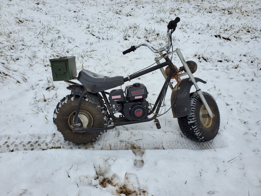

May as well join the chaos!!
Had some pipe laying around and a random exhaust flange, so I made a straight pipe. Has a little more pep and definitely sounds better.

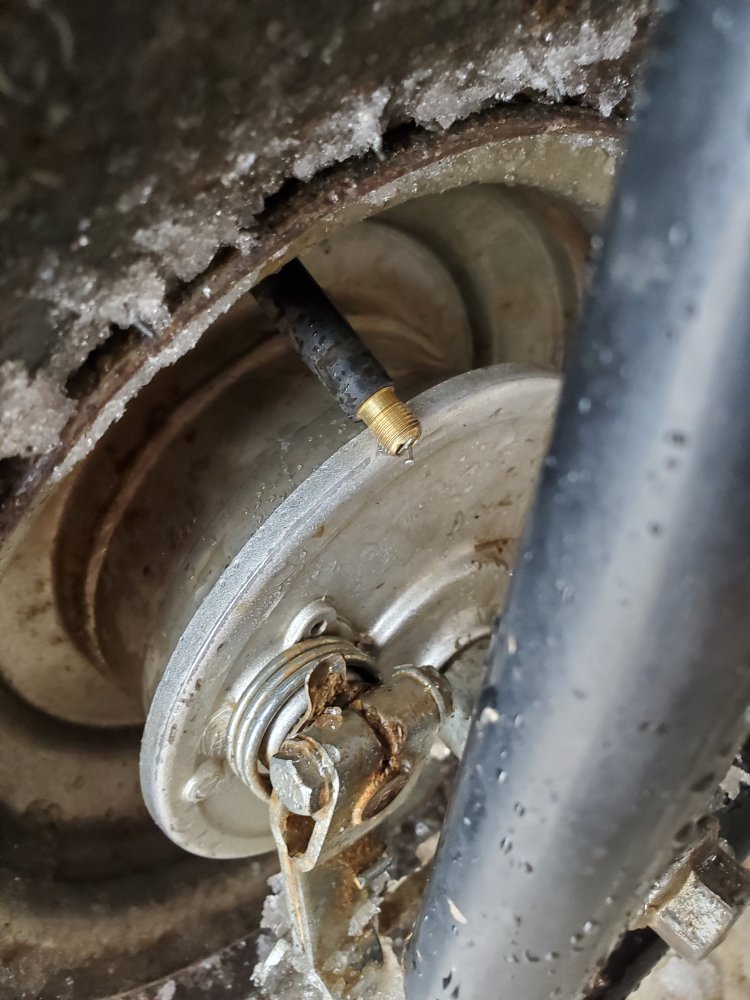

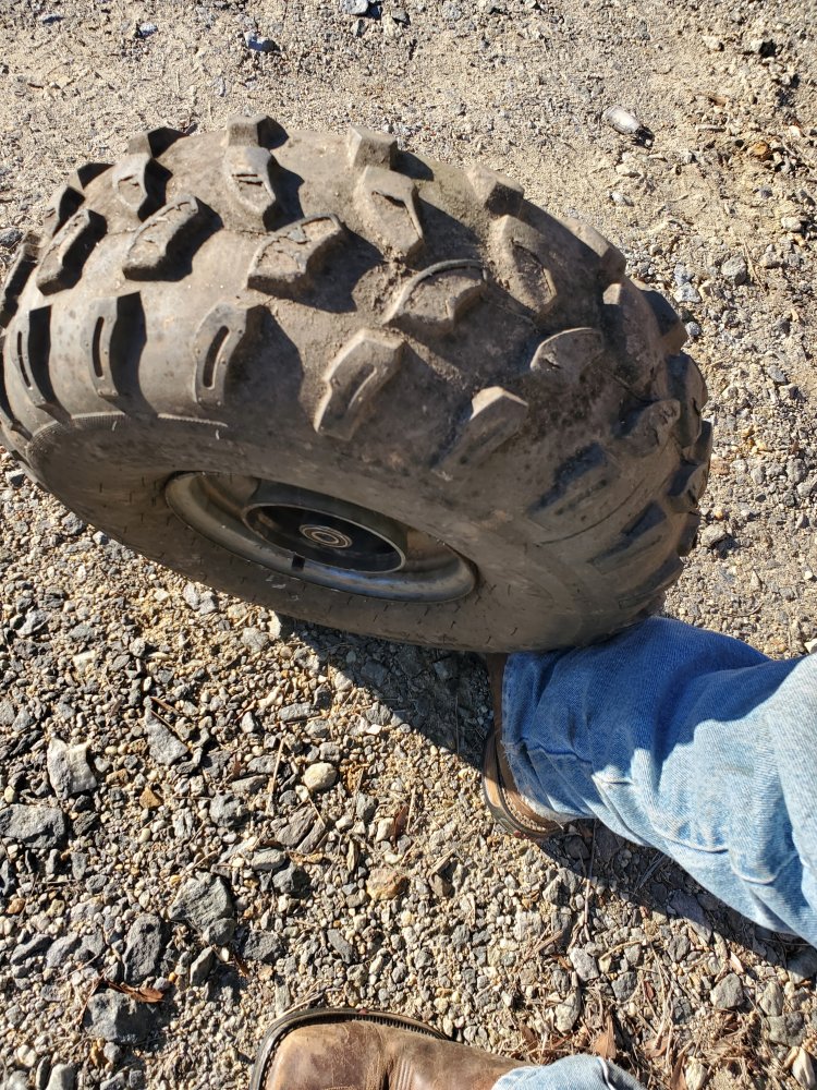

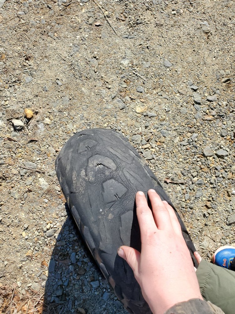

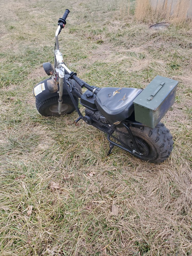

Out with the old slick tire that won't hold air, and in with a new to me atv tire. Its an inch taller, but should fit.
Edit: new tire looks great on the bike.

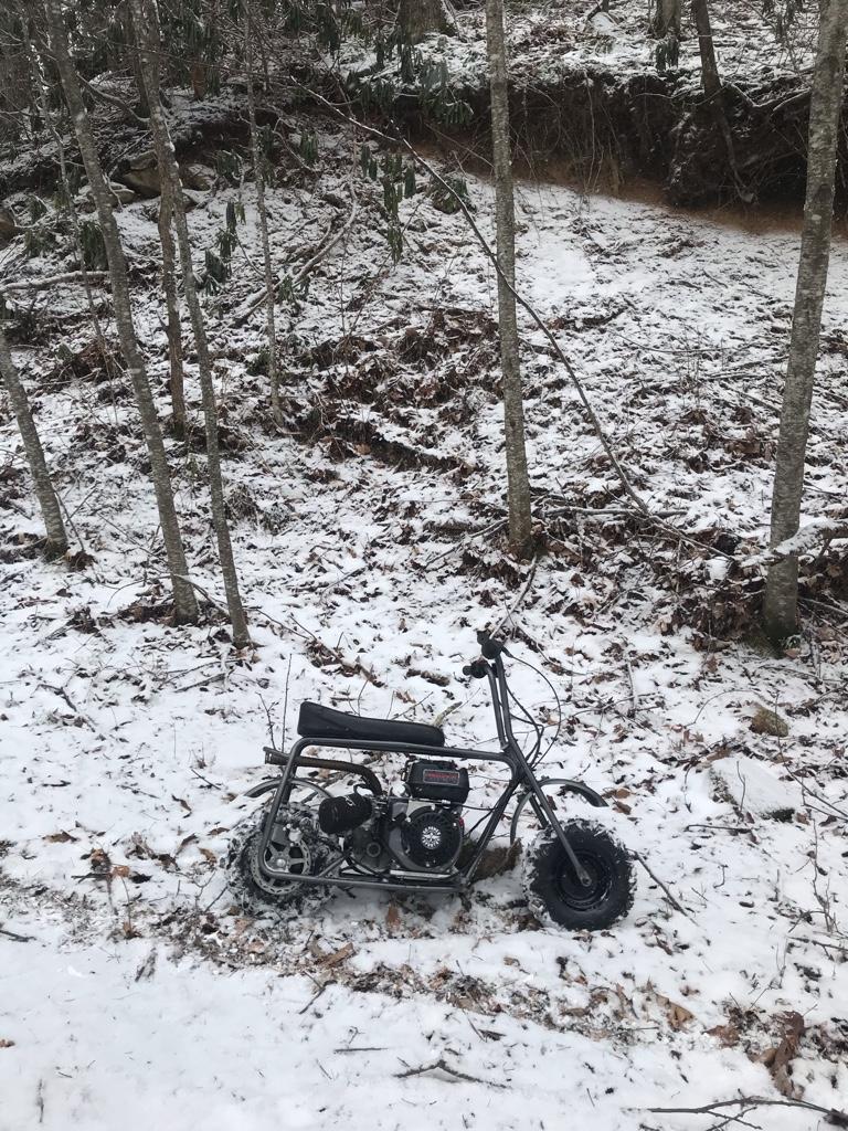

Anybody else out ripping around in this mess?

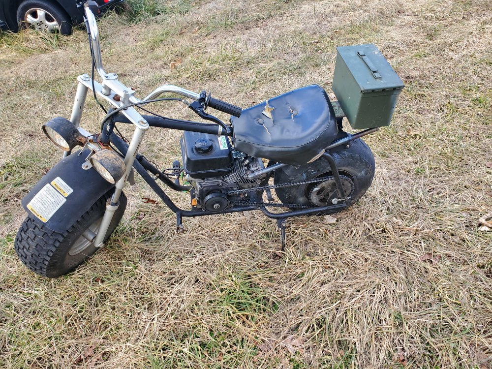

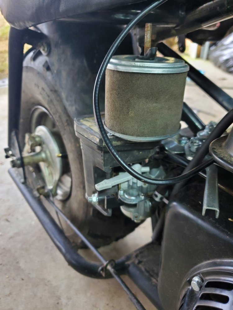

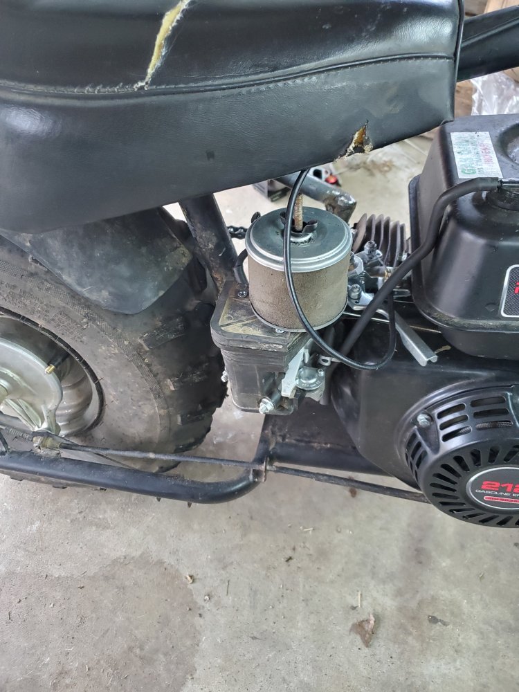

Lunch break mod. I hated the air box. Does it perform better? Probably no. Does it LOOK better? Absolutely.

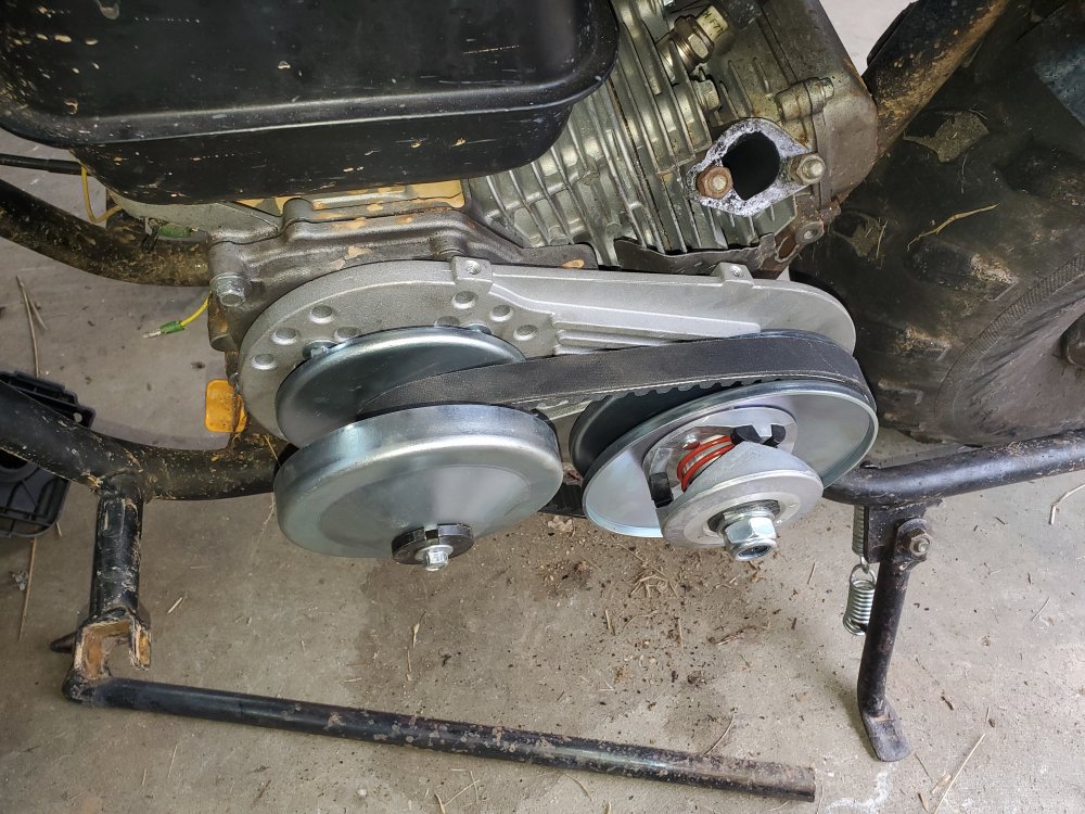

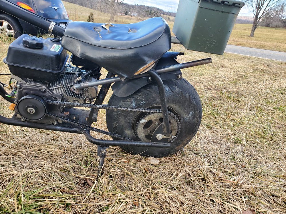

Just ordered a torque converter from Amazon to go on the bike, and to test out for the scrambler. Everyone says they're the bees knees, so we will see.
So.... TAV..... These things are freaking awesome. Unfortunately, mine flew apart almost immediately. Not sure why, but the bolt came loose and driver parts went everywhere. Note to self, locktite and impact the next one. Replacement is on the way already.
Anyway, for anyone with a bike similar to mine, you will need to clearance the backing plate substantially to get it to fit. I also had to use some spacers and move the whole assembly out 1/4" to clear my wide back tire.
Before it disintegrated, this thing was a beast. Would pick the front wheel up several inches and pulled up a couple hills that the bike wouldn't do with a clutch.
