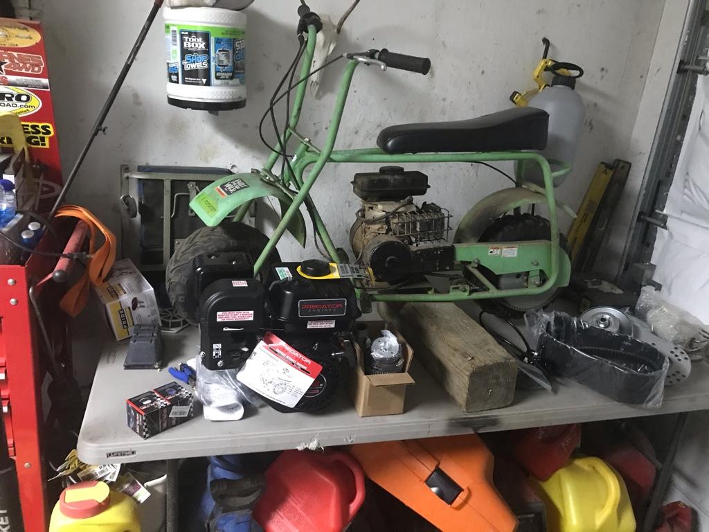

Mini bike is on the table!
Got it all stripped down and started on the 212. Anyone install the 8 degree advance? Also the exhaust I got won’t work as well as the filter for breather and tank.
I need to install the new valve springs and remove the governor and motor will be ready.

My flywheel had 8* advance built into it. Go ahead and delete the low oil switch also. Mine would cut off whilst dragging knees in the twistys before i bypassed it.
planned on doing that when i pull the governor out of it. did you get a different flywheel or the factory one? they send me a new key to replace that was suppose to advance timing.
I put an ARC billet flywheel in mine. My go-kart racing buddy said if you turn the stock flywheel too hard it will sling the magnet. I put an 8* key in another guys mini and he has not had any issues. I took the side cover off, pulled the governor and all associated gears out and then the level sensor itself (it displaces a few ounces of oil). I drilled and tapped the holes and used bolts to seal them. I did not realize at the time the throttle linkage used the governor rod for a pivot point to pull the butterfly on the carb. I ended up buying an aftermarket linkage the bolted to the blower housing. I cut the flange off of my exhaust ground it smooth. That way I could rotate and trim the pipe to make it route anywhere I wanted it to go and then just finish welded and wrapped.
Guess I’ll run the stock flywheel till she blows. I’ll look for the linkage since I’ll probably need that.

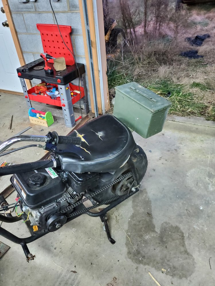

Did some work on the mini bike tonight. New clutch since the get together killed mine, and some storage.
Easily removable for when I need to open up a can of whoopass on yall :flipoff2:

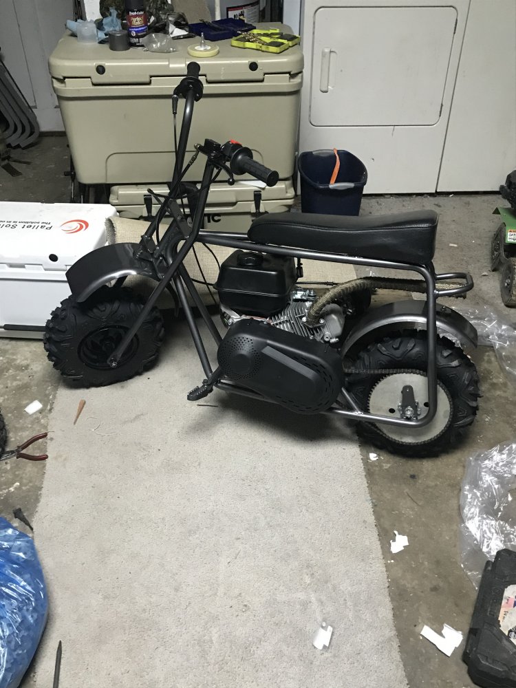

Finished mine up today. The cvt is worth it, remember how nicks was it is a way smoother transition from start to power. I twisted it out as much as I could on my short road and never hit the rev limiter, no clue how fast I was going but it got there pretty quick. It will also pull the front tire while moving.
But will it stop? 😳
