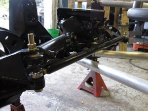

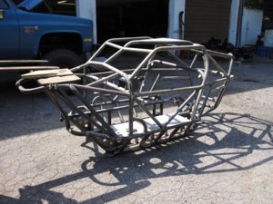

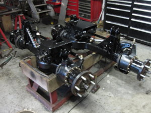

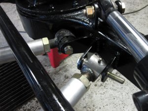

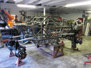

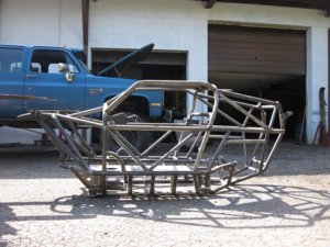

getting things put back together. finished welding the chassis. bolt axles back under. i am going to leave chassis bare metal for know. i plan to get it running and moving to make sure everything in good before i tear it down for paint.

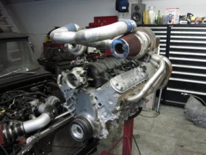

I read the article like four times, and I'm still baffled and amazed at that kind of potential.
Did they have to tune the fuel flow ignition and injector pulses along the way to get those types of numbers?
oh yeah. 75 pnd. injectors, and a tune fow boost. i am running 90 pnd. injectors in my setup. you need lots of fuel, being lean with boost is a very bad thing.
dumb quesiton... is that chassis sitting a full droop?
edit: reason being it looks like your JJ is limited on the lower link.
One day Firetoy will figure out how to mount his joints the right direction :flipoff2:
But really, I never realized how wild the shape/dimensions of this chassis were until seeing it disassembled. Nice job doing something different, just don't bump your head!

Thats a hell of a toolbox... Awesome.
