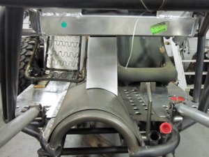

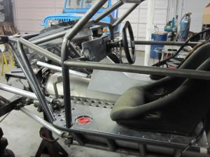

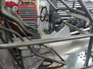

update

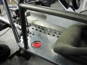

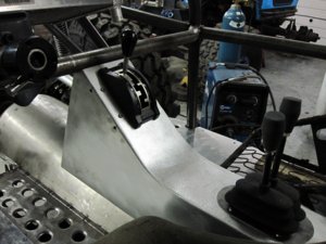

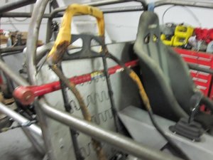

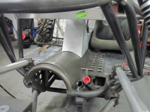

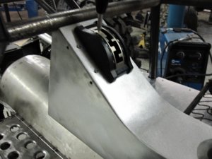

got floor and center counsil figured out. floor unbolts to access all the goods. tranny and tcase will be pulled from the inside.
couple more.
as you can see had alittle seat fire.:shaking: but i am going to recover the seats anyway.
I like the single pedal. . . I am sure its not the brake one either. . . Tim looks great. I may try to come and check it out soon. . .

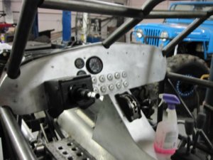

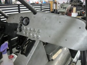

dash
was able to get dash done. the dimpled part will be where the switches will be.
almost. no just trying to get all the other projects around here finished up. hopefully this weekend i will have some progress.
yours is looking awesome.
