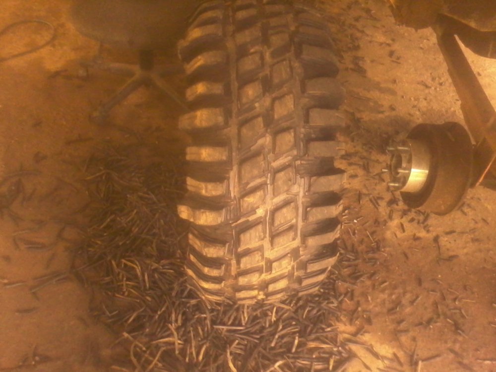

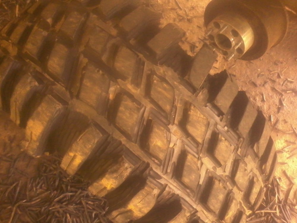

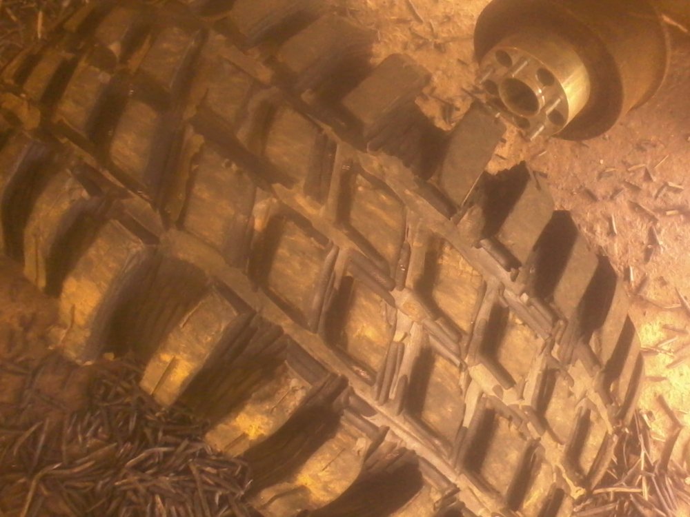

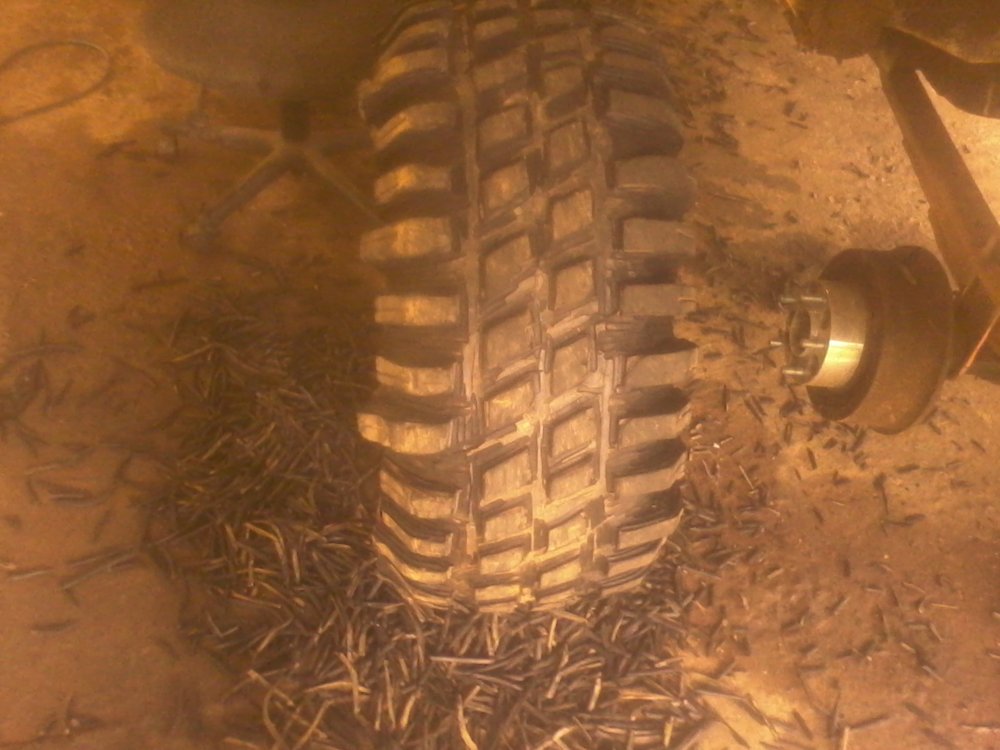

well i got my second tire done and boy am i ready to go...2 down, 2 to go. "bring on the rain next trip lol"

You saving all that Rubber ? You could probably melt it down and cast yourself a new spare,lol. Looks like they are gonna grab for sure !
LOL, i actually use it for mulch in certain areas around the shop and i've used tons of it to fill in the drain pipe ditches (if that makes sense). I'm really curious to know how they will do on some rocky stuff like that Rock Ledge part that everyone tells me is the only place i'd probably have to winch. the thornbird isn't the softest compound but seems softer than tsl when cutting it and now these lugs are really soft and flex pretty good so i'm hoping i won't struggle on the rocks as much as last time. dirt in their old cut form was awesome but the rocks were still a little troublesome so now I'm hoping to have better grip on those as well. (I still don't like rocks as wheeling preference but it grew on me last trip a little. I mostly don't like how they tear up your tires when you have to get on it)
