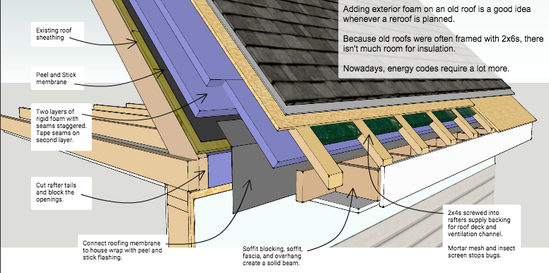

That's what I had always heard, your roof sheathing would rot out if there is insulation up against it due to sweating.Roof sheathing rot due to vapor drive becomes an issue, but if you have an air handler and/or ductwork in the attic, it's a no brainer.
