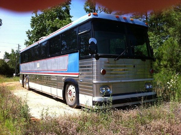

1983 MCI MC-9 and yes it has been already converted to an RV

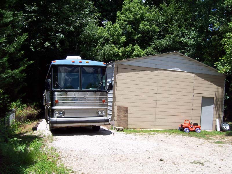

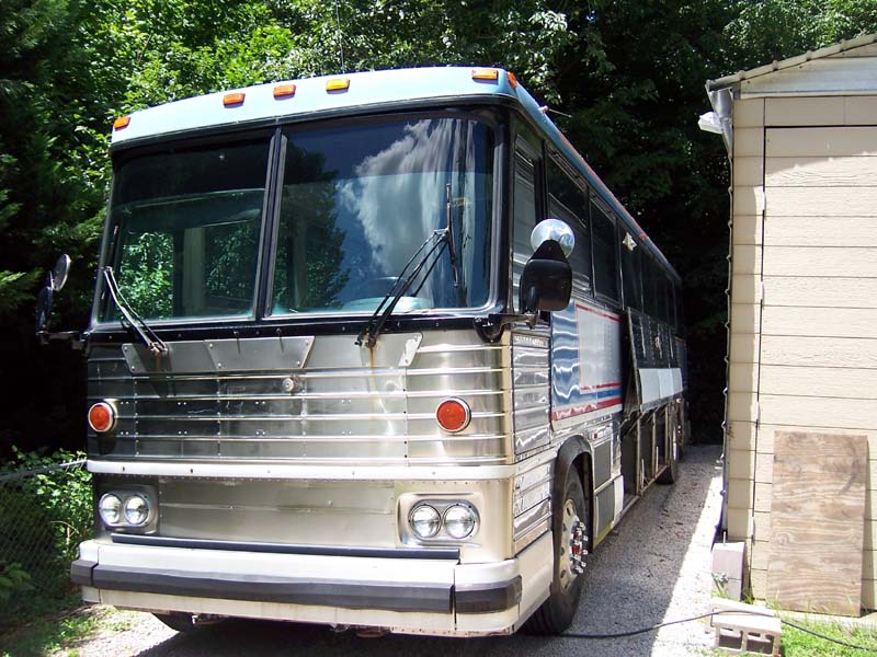

here is how I first saw the bus

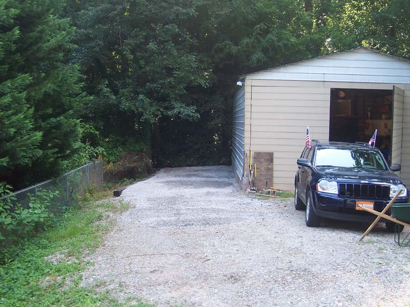

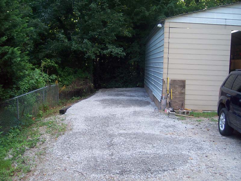

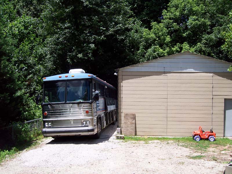

had to build a parking area

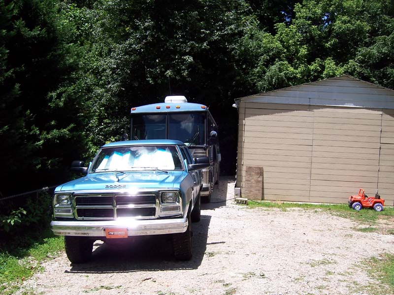

and I drove it home today and got it into its new parking space in 1 try :) that was some luck..
and with dodge in front of it for good measure..
oh and my shop does look very small now :)

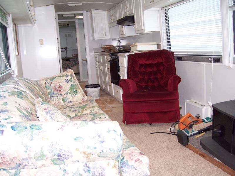

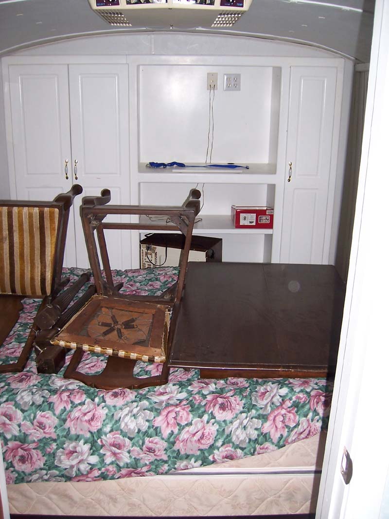

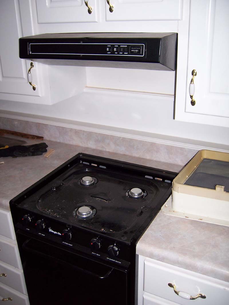

here are some interior pics

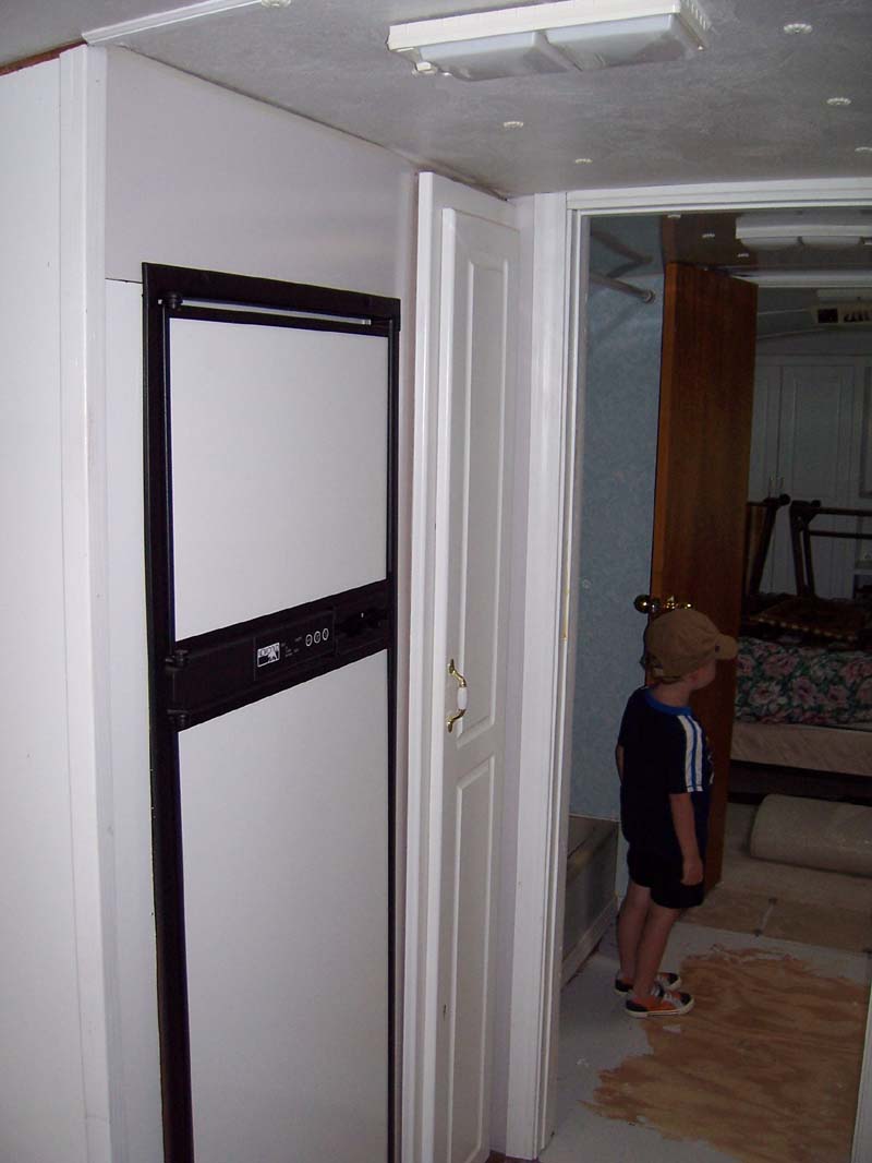

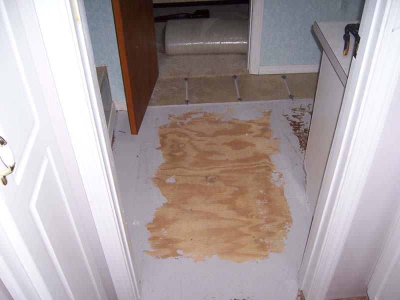

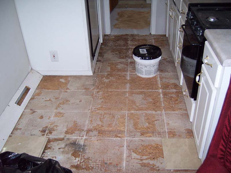

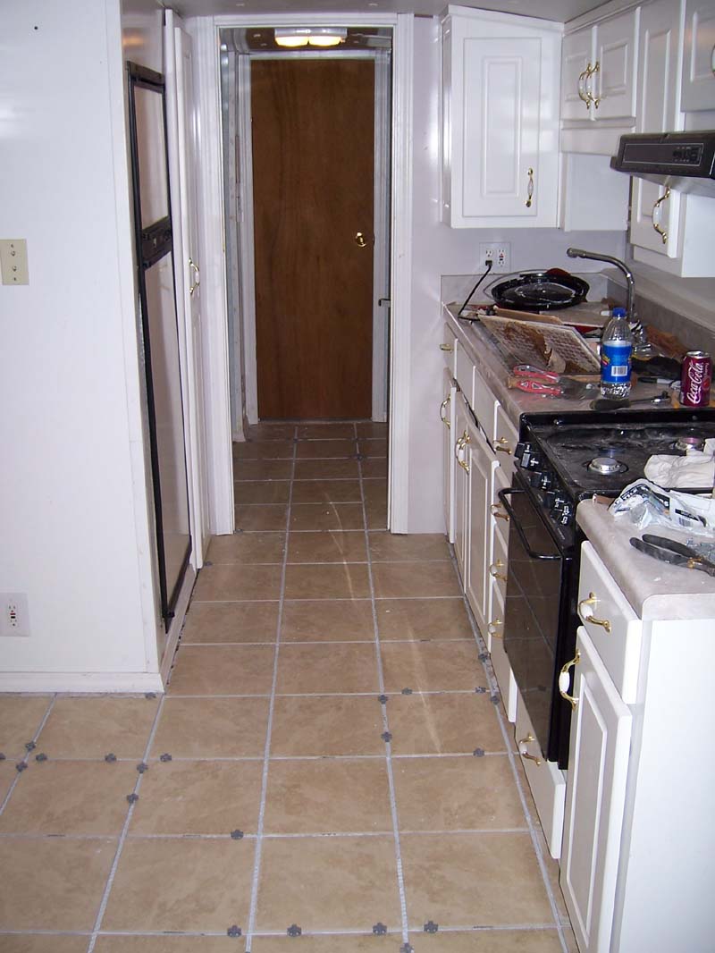

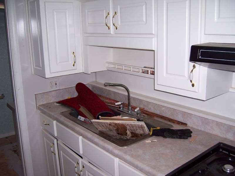

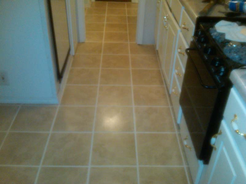

ripped up tile floor due to it being soft and found bad wood so replaced it and I am now laying new tile
It looks so nice parked in the driveway.
Check the water-hose gasket going to the icemaker, Probably screws into a plastic 12v valve. they have a tendacy to leak and slowly drips down at the back of fridge and creeps in time through the subfloor and is under the tile and not noticed till the floor gets soft under the tile. Happened to two of mine and several of my friends. I don'y check it anymore, I replace it every year now. Hope this helps Ken.

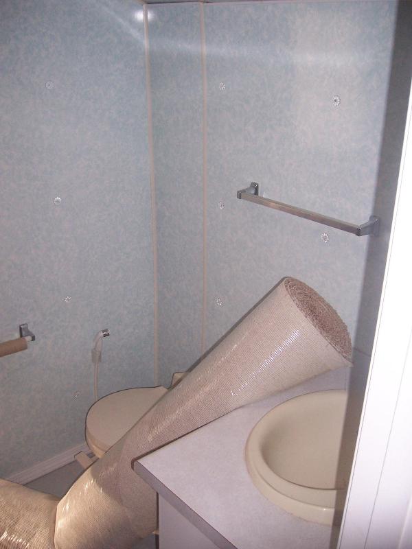

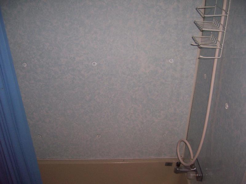

here is best pic of bathroom.. toilet and seat on one side and then fullsize tube on other side with shower

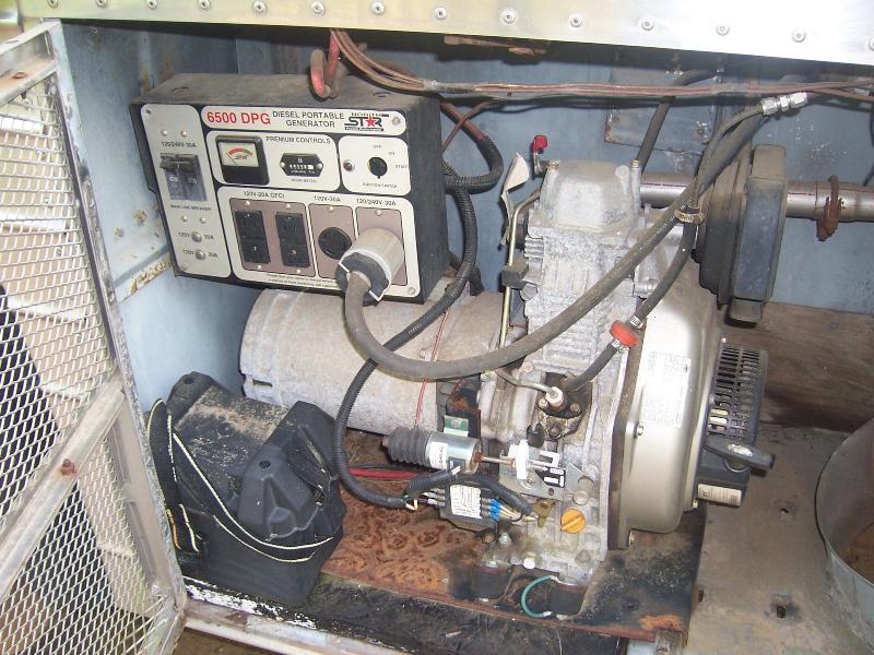

6500 diesel gen

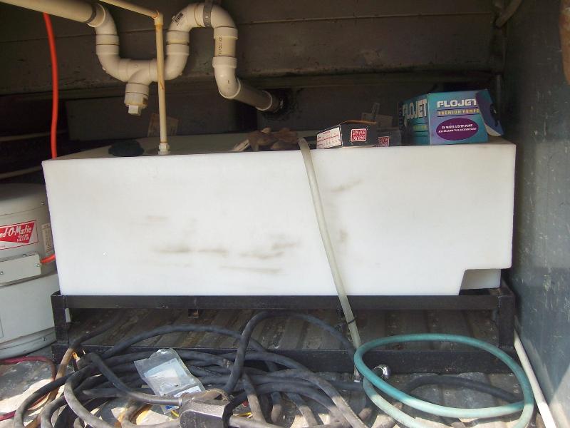

fresh water tank

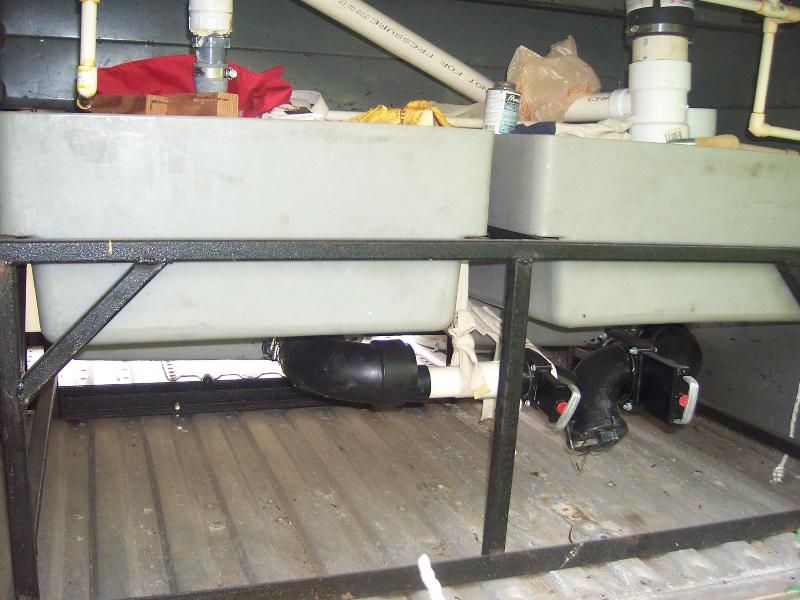

gray and black tanks

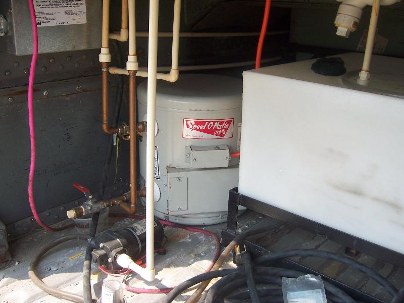

water heater with pump

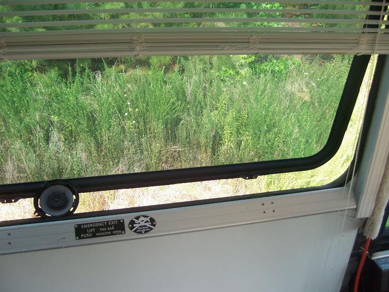

all windows can open for emergency exits

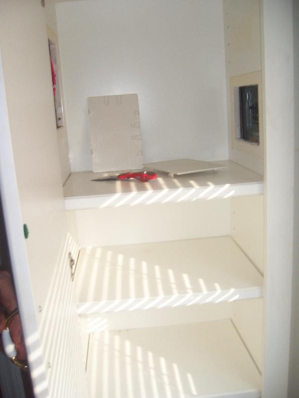

back shelving in back bedroom where breaker box and 12 volt panel and convertor are located

well no new pics but we replaced both roof top A/C today and thank goodness we now have a nice cool inside... only big item to work on is the generator..
Wow, fullsize tub...tile kitchen floor...oven...recliner... Are you kidding me? Awesome. Looking at the pictures, the thing seems to have been built pretty well originally, which is always nice.
