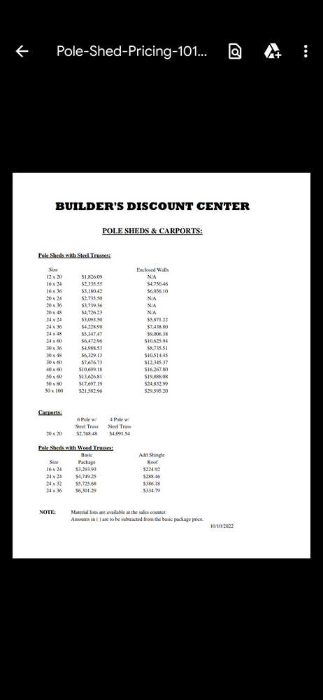

@ghost Here is a Builder's Discount pole barn price sheet from May 22 and the current one. I've been watching prices all year, hoping to build a 40x60 myself eventually. Prices have definitely came down. The 40x60 I've been looking at has dropped from $18,9xx to $16,2xx.
