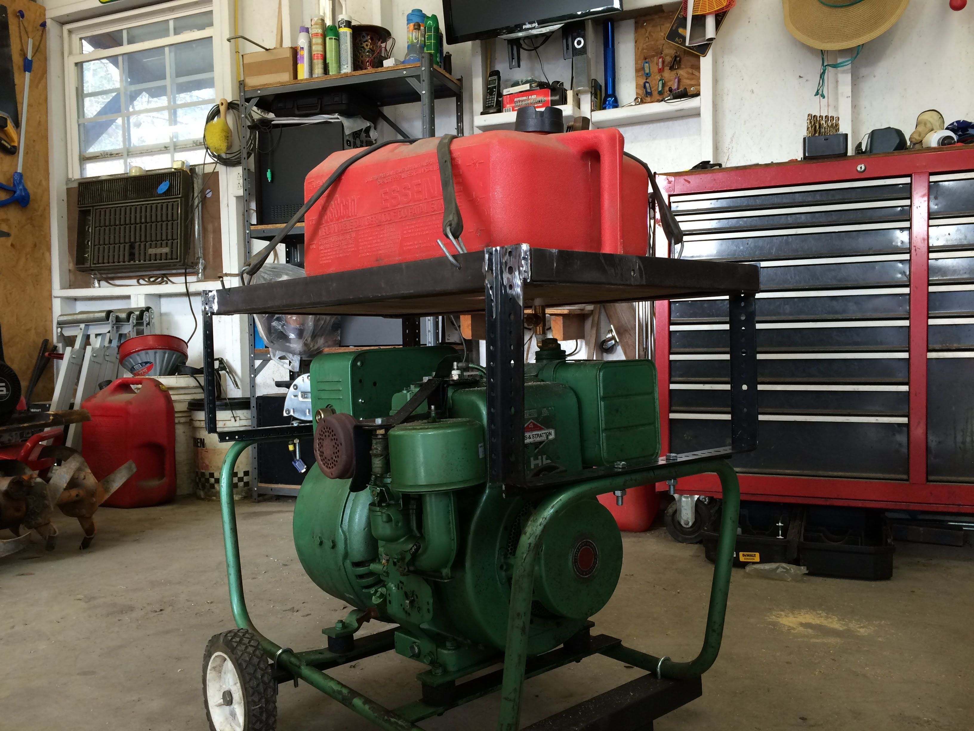

@Ron I recently pick up a generac g2600 for a song. The fuel tank is in pretty bad shape inside. I put some new fuel lines on it with an extra filter right out of the tank and flushed the tank with atf/brake cleaner and it runs great. I cant seem to find a replacement tank for it. For now, I just have extra filters but I would like to put a new tank on it. Should I just rig up a plastic tank or is there a more stock option that would fit inside the frame rails?

You got a welder, right?

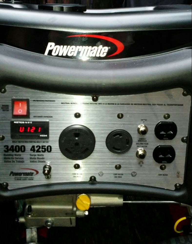

Did a test run/break-in run for 15 mins. Put the oil in it and pulled it slowly a few times, it fired up on the third pull, smoked a bit until I took the choke off and then it hummed. No knocking and not as loud (no load) as I thought it would be. On the back deck I can barely hear it in the den, in the bedroom it's quiet enough hum her asleep. We have a glass sunroom w a sliding door and I'm thinking I can park it right at the door and point the exhaust out the door if I need to run it when it's raining.
