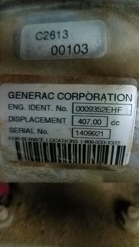

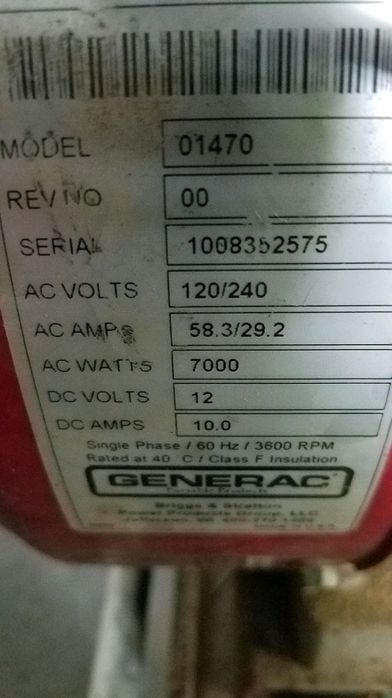

@Ron .Or anyone with knowledge. Looking for carb kit.
Not mine but a friend in need. Don't expect to find it local.

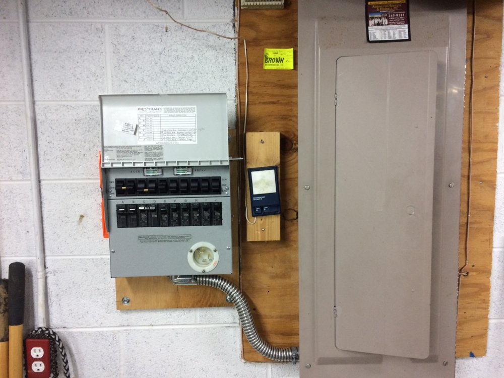

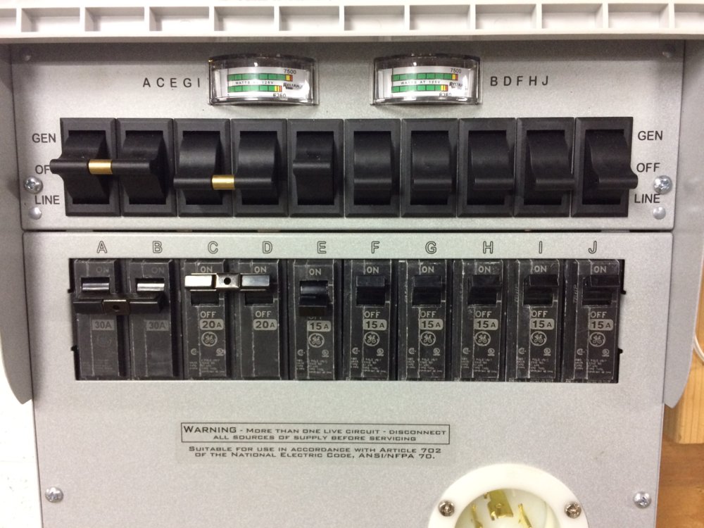

When we first moved here it seems like the power went out all the time. I was finishing out the barn and getting prepared to build a shop and decided to buy a generator. I only used it sparingly but it was a life saver a couple times a year. I back fed the panel once and usually used extension cords dragged through the house. I found a Reliance manual switch on the Internet. I held out till I could find a 10 circuit switch because I thought 6 wouldn’t be enough. After working through the installation and switching everything I though “should” be backed up, I had a couple spaces left over. I backed up the main fridge, garage fridge and freezer circuit, my entire finished basement since it seemed like that is where we generally went, the living room so the wood stove blower would work, and the water heater. The transfer switch wasn’t necessary but it made me feel better that my wife could hook up the generator if I happened to be gone when something happened.
