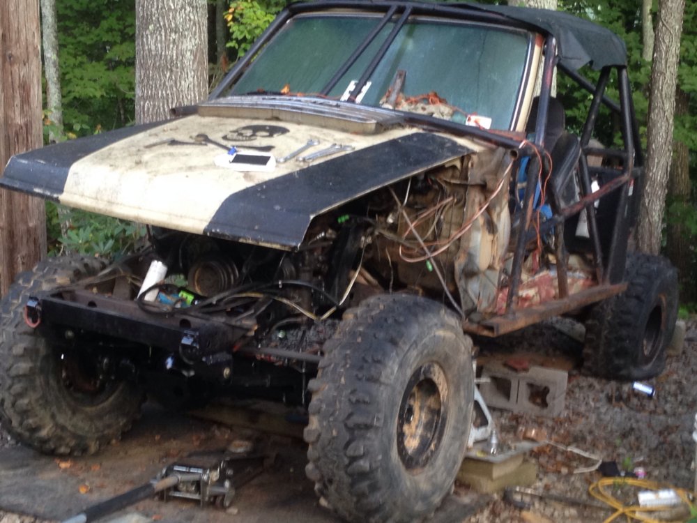

Between mowing, Daddy daycare, and a pool party w a 3 yr old in the front yard but I did get some progress. Got all of the complicated maffises figured on. Factory is set a 4 degrees. I'm thinking that I may be at 6. I'm worried that at full droop my springs may contact the drag link. Will probably go 6 with just a tack and assemble one side to check clearance. I've already installed and remove the axle 15 times... Why on one more to make sure it's right?!?

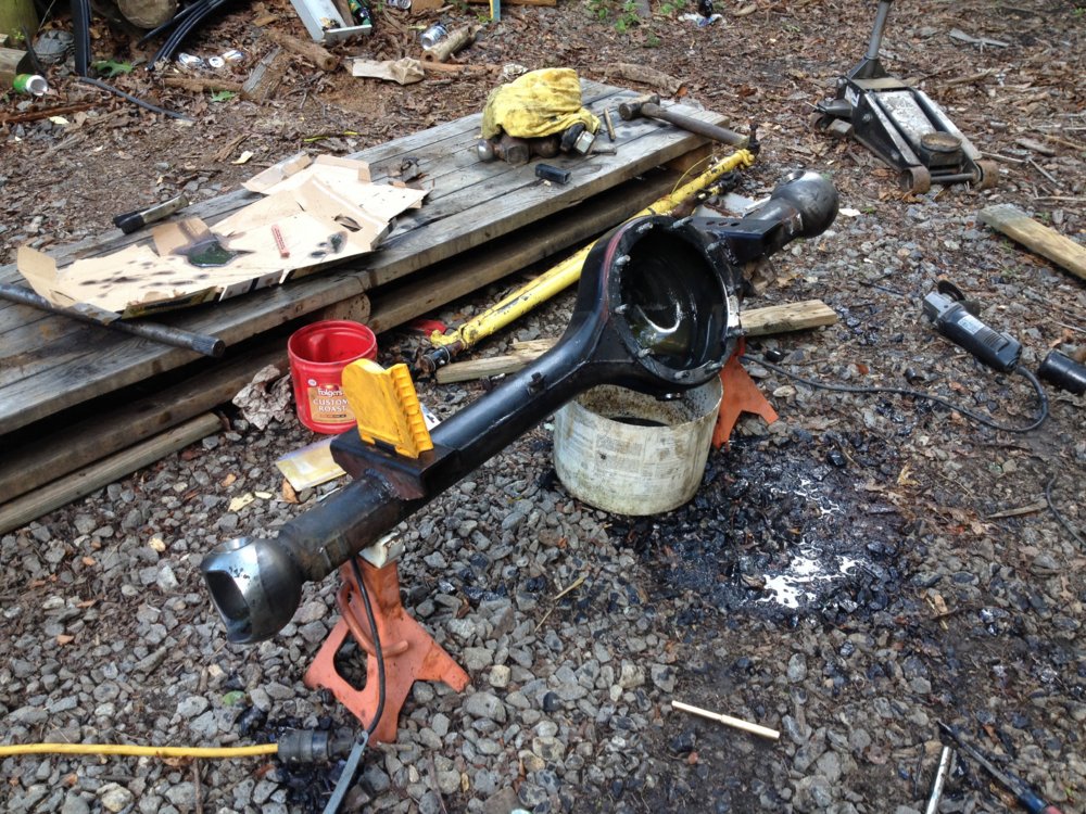

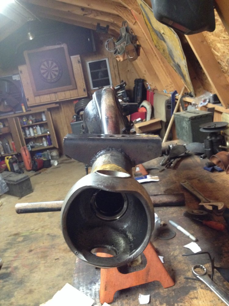

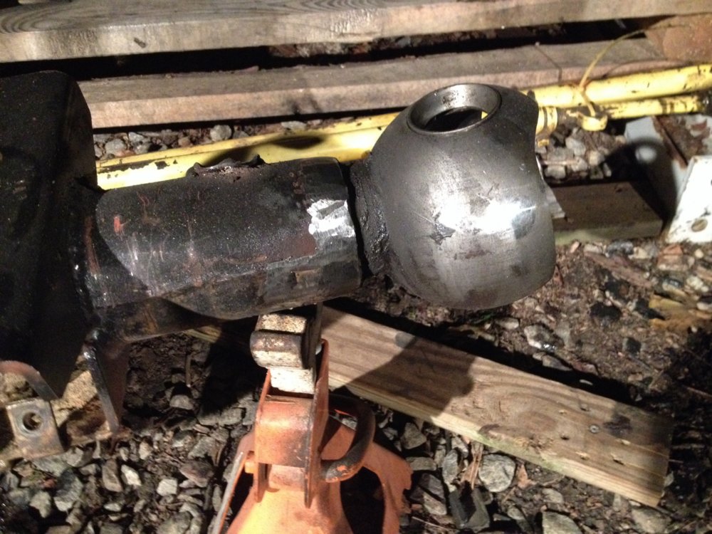

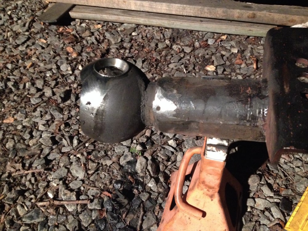

Well I cut on the knuckles Sunday and beat the snot out of the knuckle and could not get it to move. Very frustrated I just walked away and played with the kids in the yard.
Did some more research Sunday night and determined that I cut too far out on the axle, maybe. Monday night I cut again 1/4" further in. Proceeded to flail on the turn again. So I watched a WWII documentary and sipped on a frosty cold down easy.
Tuesday morning I called my friend Chris Ellis (@novacayne75 ) of Buckeye Performance and he told me no problem drop it off. A big thanks to Chris for knocking it out for me. Apparently I was too much of a wuss to cut deep enough o_O.

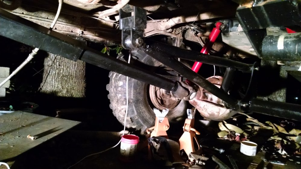

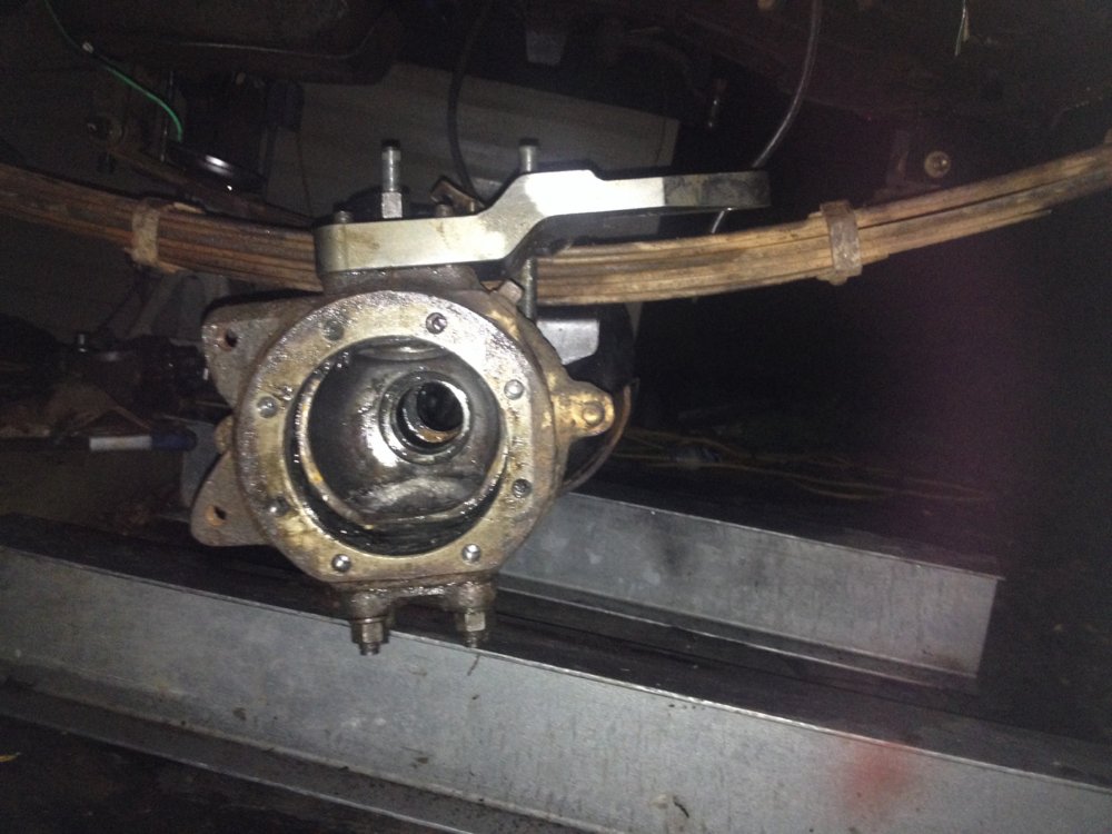

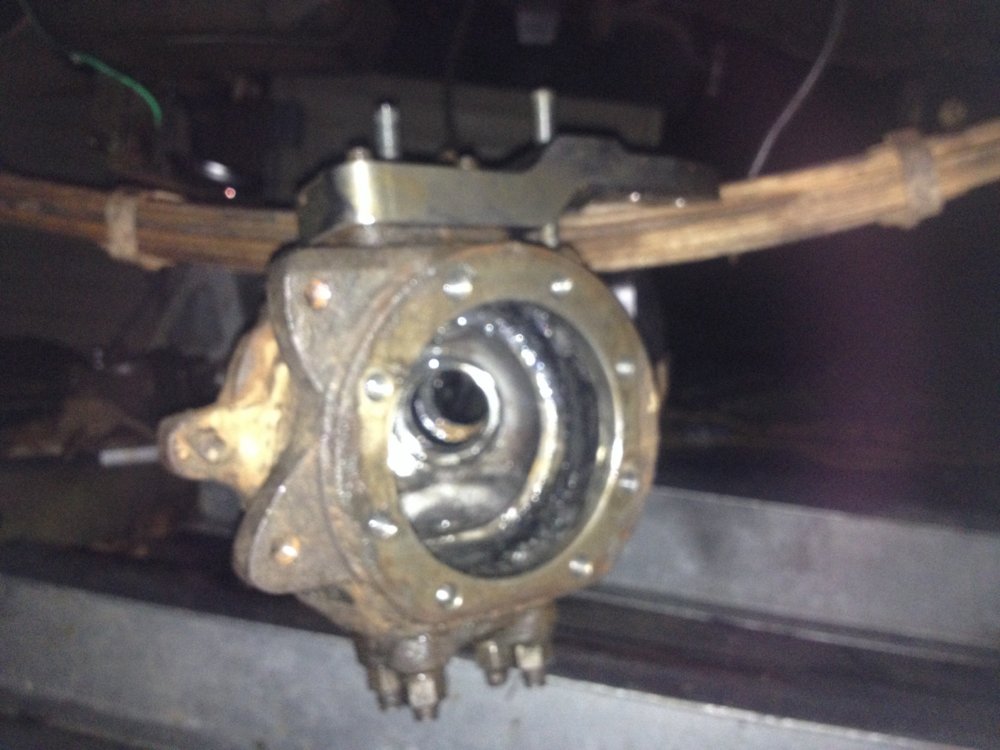

Chris turned the knuckle to my requested +6 degree castor and tacked them in place so I could change it if I needed. Logged some time last night and assembled the passenger knuckle with the bling Marlin high steer arm and checked clearances.

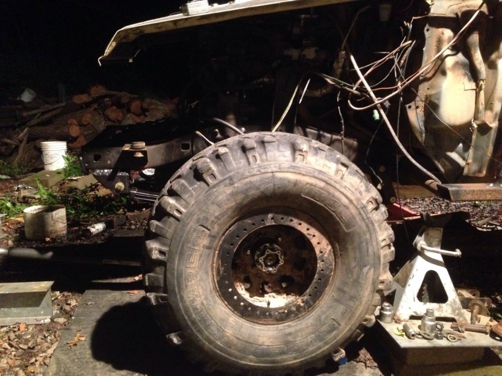

The leaves are hanging with a bare axle housing so I am anticipating more drop with guts in the housing and especially when being forced downward by articulation. Just sighting across the top of the leaf spring I have about 1/2 clearance from bottom of steering arm to top of spring. If turning hard driver it looks to be about 1/4" from the top of arm to spring. I'm no expert but it looks like this is what I should have. Very excited to have this step behind me. I want to clean everything up and paint while it's all apart. Also need to fortify the front axle armor. May fab up a truss too.

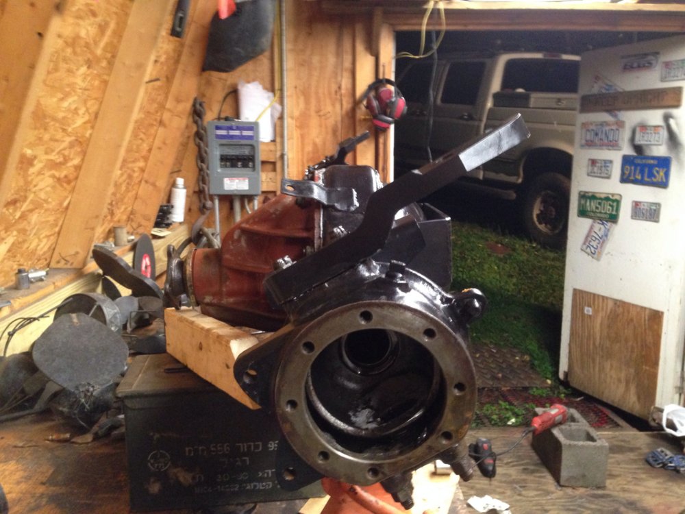

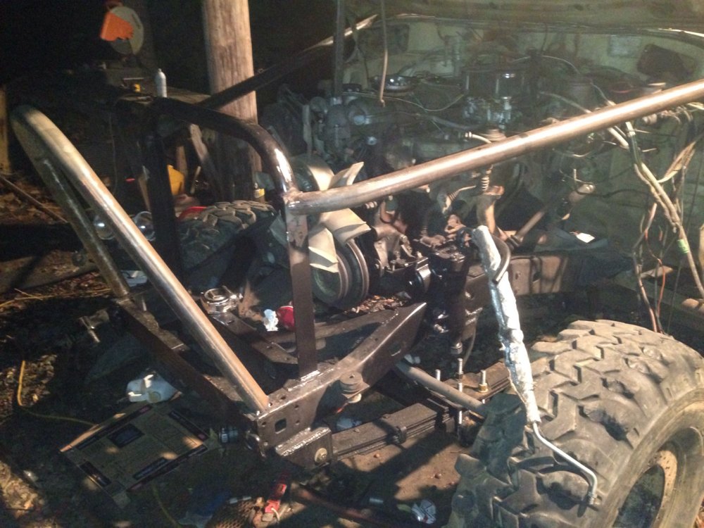

Had some time to make a bracket to hold the jeep Saginaw power steering pump, but got distracted.

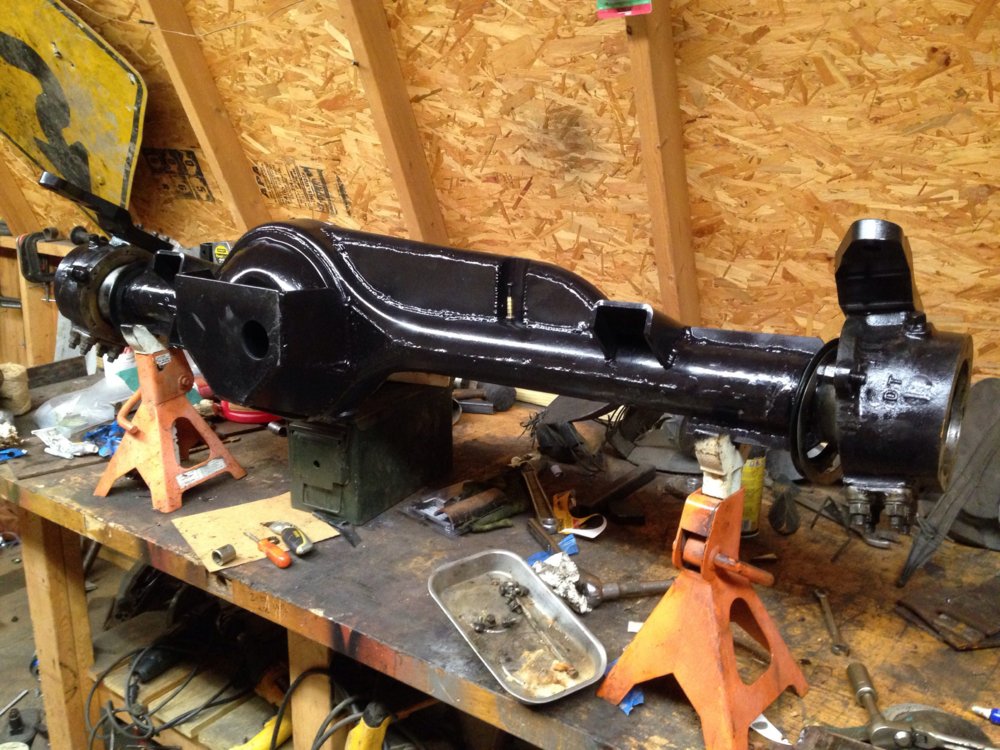

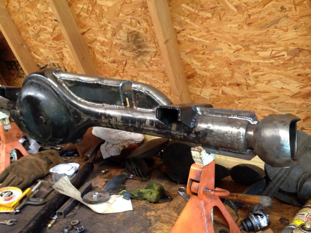

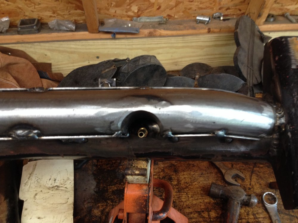

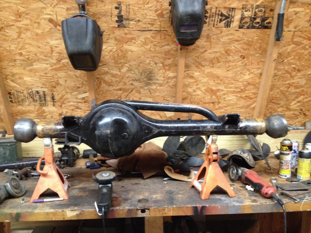

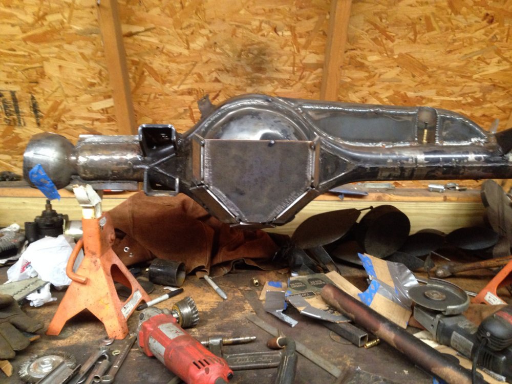

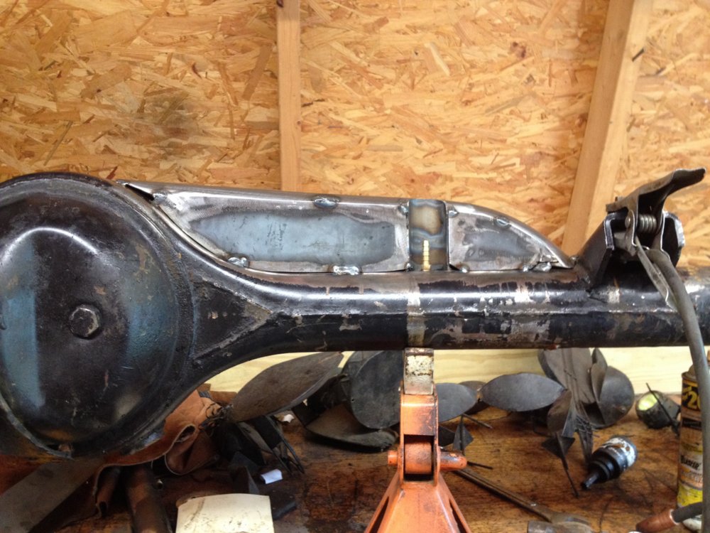

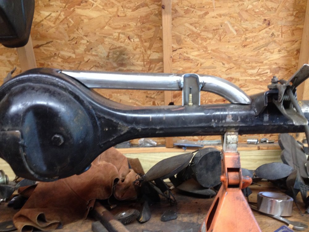

Bare front housing has been taunting me for some time. Did enough head scratching to truss the front. Can't do a typical off the shelf Yota truss because I want to keep the force as vertical as possible and with the C&T it would be at a serious angle. I entered a staring contest with a scrap off the front cage I removed. It'll work!

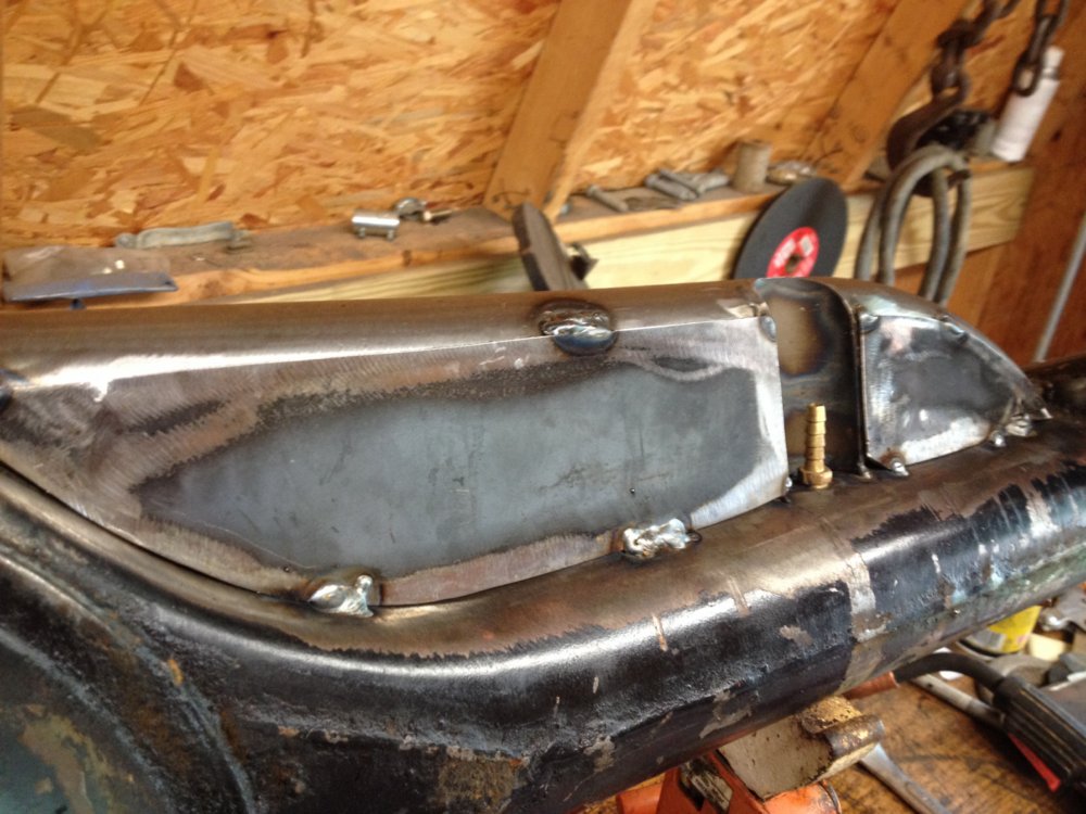

Got some free time today when my daughter had a play date at the house. I have been struggling with the axle vent tube in relation to the truss.
It hit me today and this is what I got.

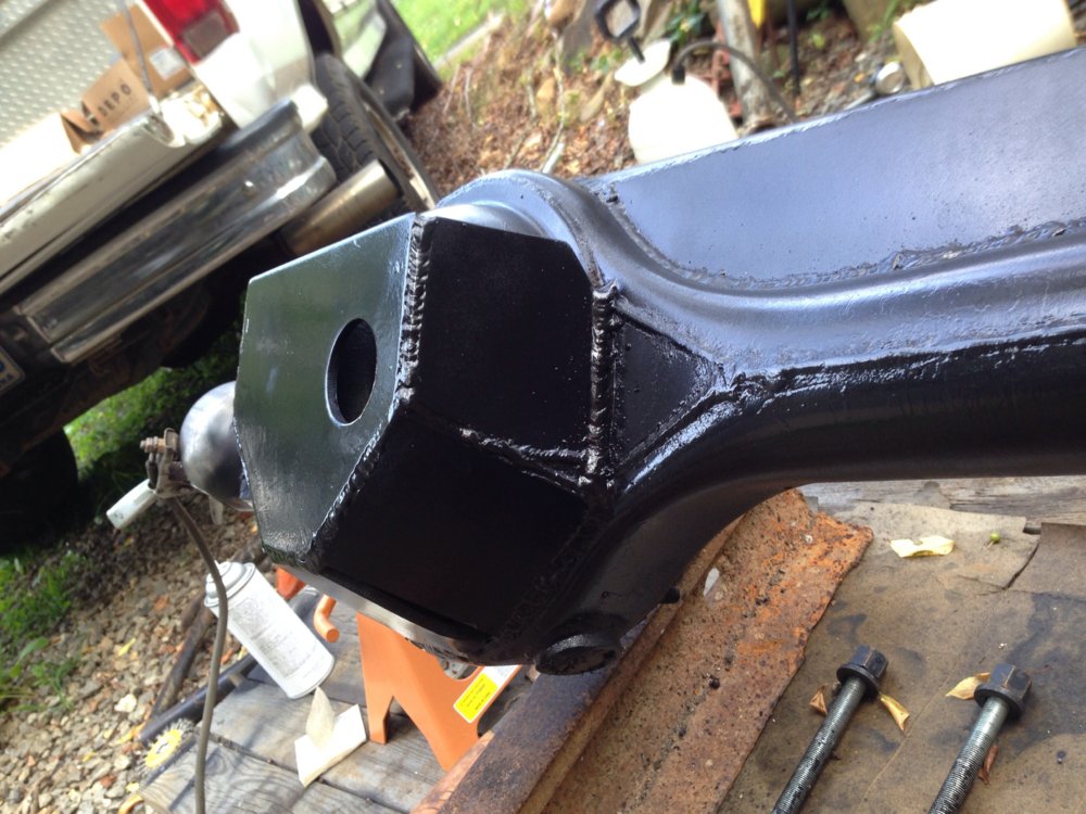

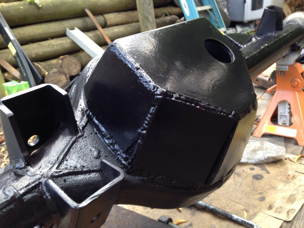

Happy Independence Day everyone! Just got my 3/8" knuckle gussets welded up during nap time! Time to clean up and get ready for some festivities.

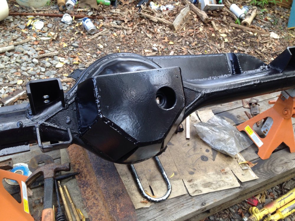

Anytime. You know where the pile is. I cussed at cardboard for a couple hours tonight trying to whop together some better front diff armor so I can reassemble the front axle sometime soon.

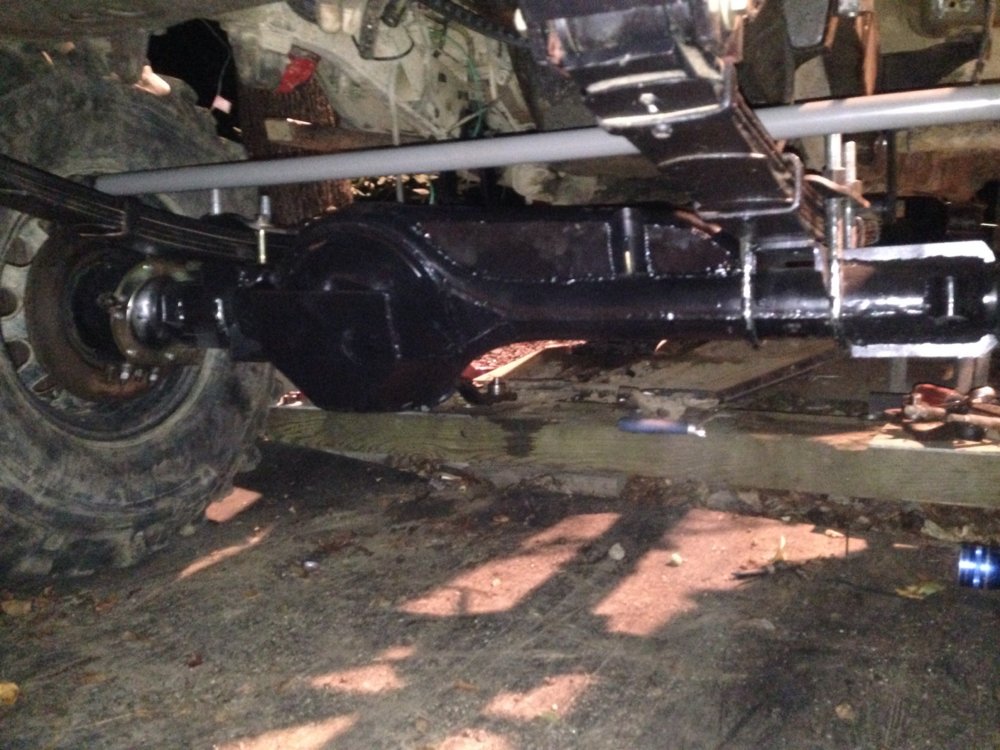

Been kicking the shop till 11 since the weekend. I can say that I utterly hate cleaning the old paper gaskets on ancient Toyota parts. Grey RTV for the win!

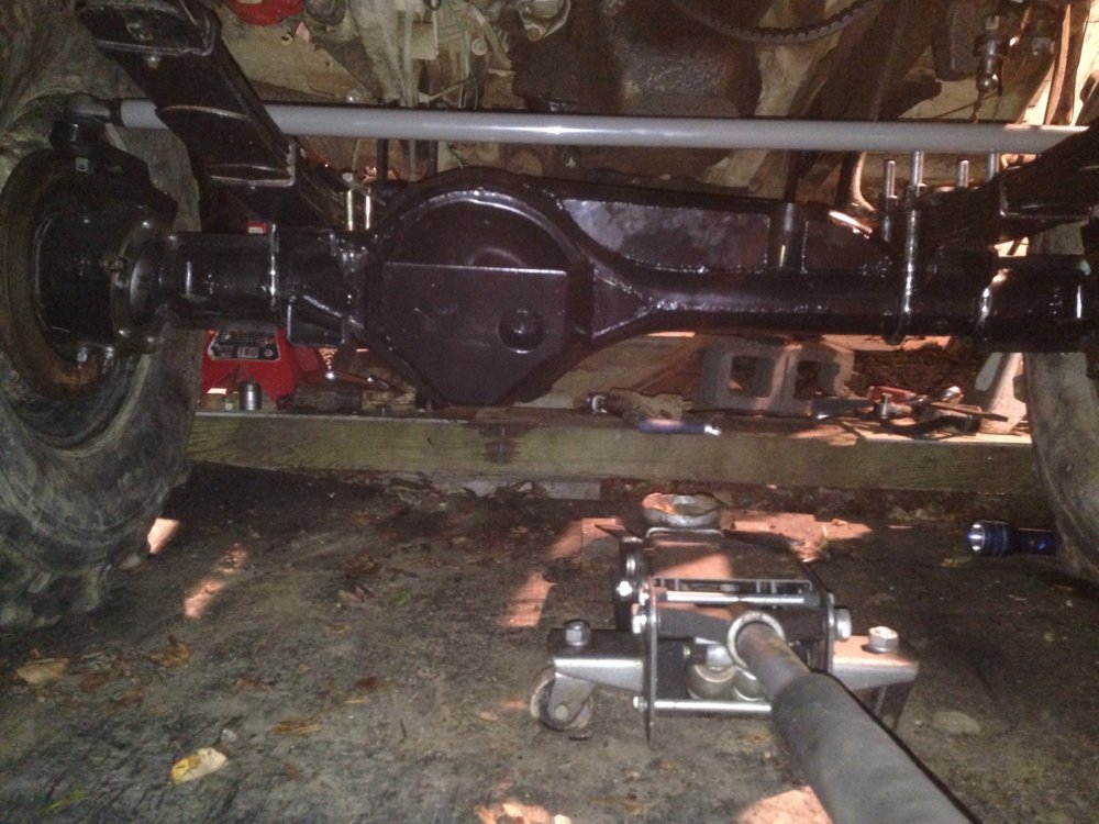

Got the knuckles strapped on and even though I haven't checked the bolts with a torque wrench yet the preload on the knuckles seems good.
