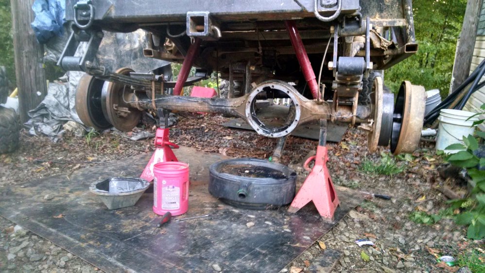

So could I use the 60 yoke on the 60 pinion in the 80 third?
I'm 99.99999% sure, yes.

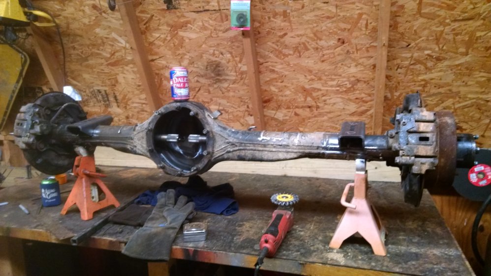

I plan to utilize the 80 caarier in welded form, so I'm not concerned about the axles shaft splines working from the 60.

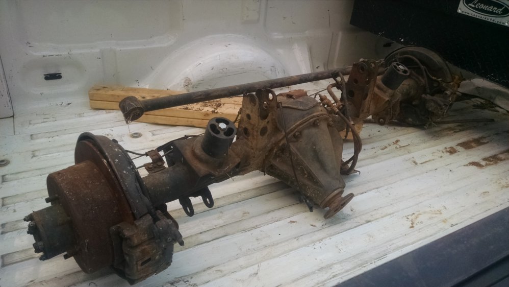

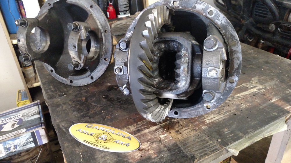

Just brought home my next upgrade: full float disc brake FJ80 rear! Thanks again @Pless

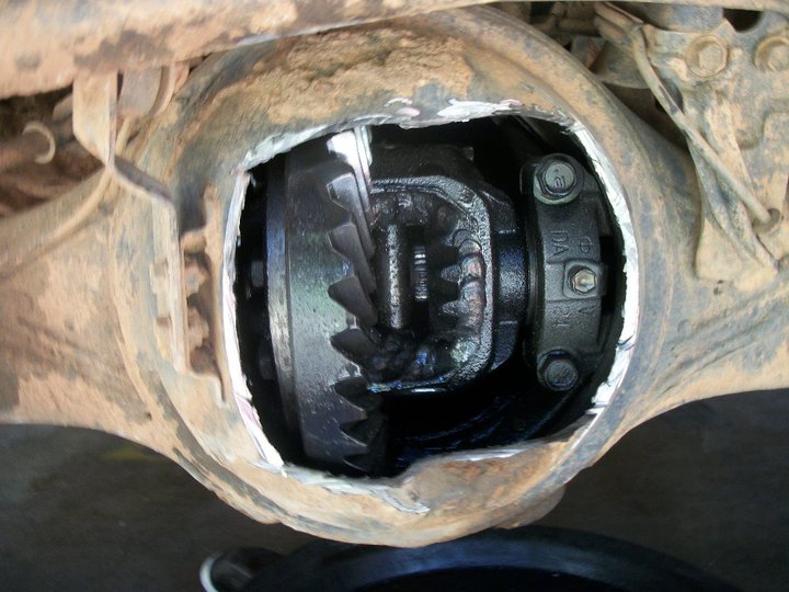

no.broke an axle shaft and that was only way to get it out.Yes. I'd say it's the same axle. I have not torn it down yet. So what's the deal with it?
Did you cut it open to weld it instead of taking it apart?
What was it under when it broke? I'm thinking that it probably won't break under mine, but if it does it will be chromo time. This will be the last axle for the piggy bank aka Becky.

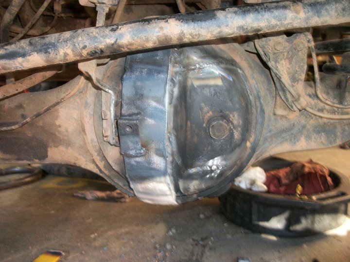

I'm probably going to run my BTF cover from the 60 welded on. Now you've got me second guessing, I may make it bolt on.

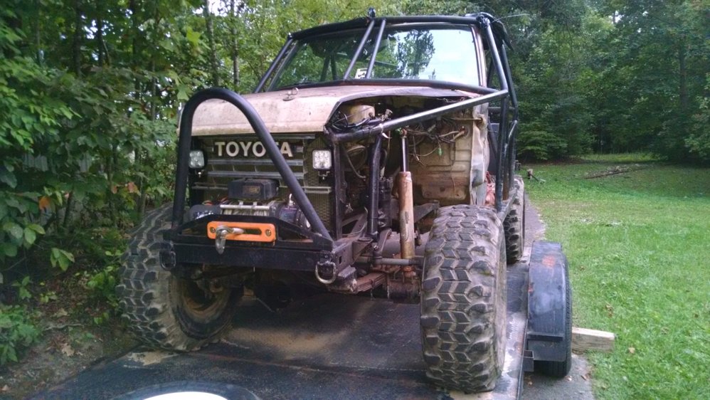

Got a pic of that beast?97 fj80 with 39 michelins. Axle should be geared 5.29
