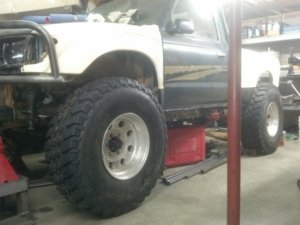

No big updates, I worked on the truck a little today, mounted the BFG Baja's on the aluminum wheels I got from Galloways awhile back. These are 37's off a Hummer, so they are 16.5" wheels. I doubt I will use the for any racing or hard offroading, as the 16.5's are bad about losing a bead. Probably going to get some 17" wheels and Krawlers or something for racing. The 37" krawler spare I have is about 1" taller than these Baja's.
ai1120.photobucket.com_albums_l482_Michael_Bowen_Racing_20Taco87513daf30c31a7514ed3bca54a5bb74.jpg
Here's a front picture, wish it were actually sitting on the tires and not the jackstands...
ai1120.photobucket.com_albums_l482_Michael_Bowen_Racing_20Taco2030ee180de68a91e6c9206be146a398.jpg
Looks like I will need to shorten the suspension links some to bring the axle back. This is probably going to cause some really close clearances with the oilpan, maybe require some fender tubbing as well. I just don't like the 'look' of the tires being nowhere close to centered in the fenderwell.
ai1120.photobucket.com_albums_l482_Michael_Bowen_Racing_20Taco7baaf2590b7fa95e55e3357b3687b4c0.jpg
I put two spares in the back, and bounced on the back some to help settle the springs a little. Right now it is 20" frame height at the rear leaf spring hanger, I will be moving the shackle hangers some to raise the rear up some probably. I really like the low frame height, but I think the front is going to end up a few inches higher than the rear if I don't move the shackle.
ai1120.photobucket.com_albums_l482_Michael_Bowen_Racing_20Taco87585da075d26d7a59c1282bc063261c.jpg
Looks good but why not use recentered H1's. From the looks those frt fenders will need reworking even if you move the axle back.
I could, but I don't want the weight of the H1's. Plus, no matter what wheels I were to use, the Baja's would probably never perform off-road anywhere close to that of a Krawler, KRT, or even an IROK for that matter. I will use the Baja's for trips where I want to drive to/from the trail, as spares, for mallcrawlin, etc.
I am sure the fender will need to be trimmed some, that's not a big deal, as it sits, that should be fairly close to full bump, but the tires turning/suspension flexing will likely cause things to rub.
