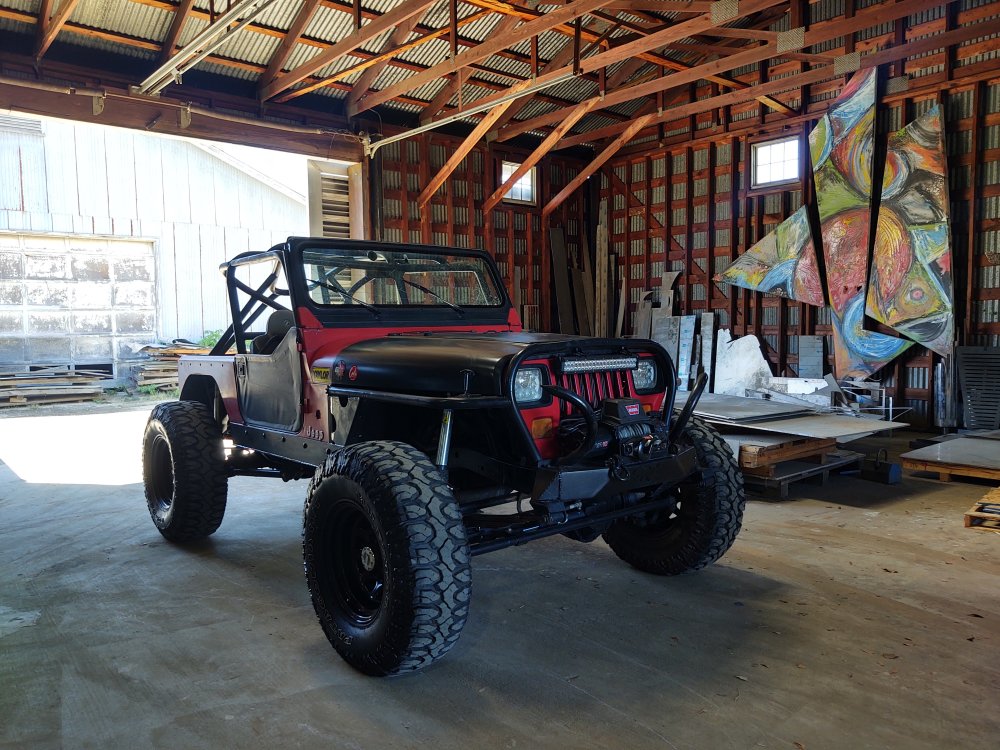

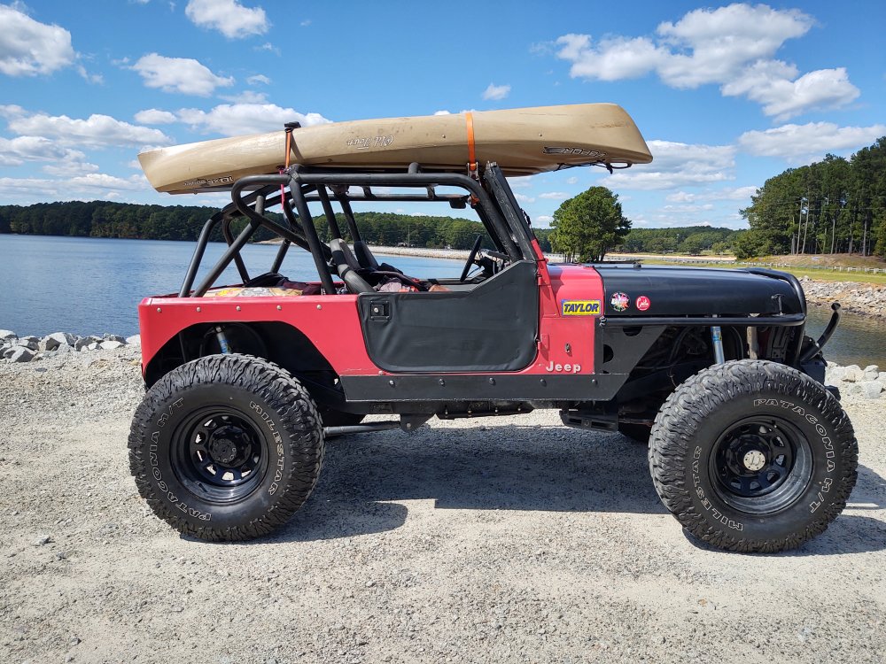

One is tires. For $1042 shipped through Amazon, I got a cherry set of Patagonia MTs. 37x12.50x17. They're a new player in the big rubber game with a large hype of following. I mounted these on a set of 17x9 D window steel wheels (for simplicity) in my backyard nearly a year ago. I used approximately 2500 .12 gram airsoft BBs per tire. Notice the price tag. They are CHEAP and work.
My intentions were, and still are, to have an ultimate in universal wheeling tires that double as everyday highway tires. The Patagonia MT delivers flawlessly. They are freakishly quiet, smooth, and they bite into dirt like there's no tomorrow! I strongly recommend them. I really need to rotate these at some point. The rears are a lot lower in tread than the front. 70% rear and 92% front...for comparison purposes. Or I could just quit driving like a dip shit. I'll get these rotated by this weekend.

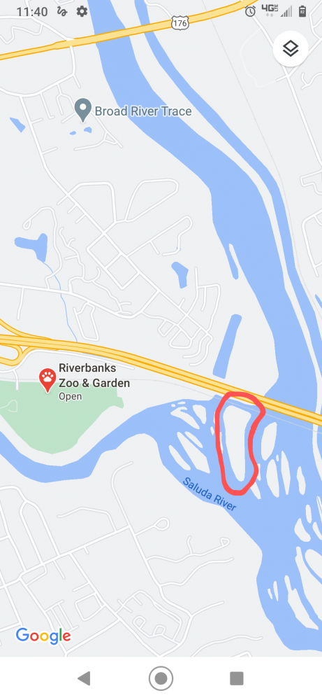

Just a few things we've been doing at work. Boyd plaza at the Art museum in downtown Columbia that we completed last year was a huge success. It's certainly a focal point for the local art scene. Now, the Boyd foundation has now included an island to their collection. This island in particular is located adjacent to Riverbanks zoo where the Saluda and Broad meet to form the Congaree. Highlighted here is it's exact location.

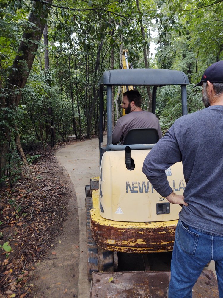

The only access to the island (accessible by zoo property), besides by boat or kayak/canoe is by bridge. We were contracted to build park amenities for the public to enjoy. This is still in Phase 1 for us. This list includes stonework and hardscaping, along with flood-proof seating and picnic tables. All outdoor furniture was CAD drawn, Waterjet cut, welded, sandblasted, powdercoated and installed by us here at Stuyck Company. To make the install happen, we had to think a little out of the box. We employed our New Holland EC35 mini-ex and a custom built pull-behind trailer to move the finished products and hardscaping materials out to the island for install. It is quite awesome. I'll let the pics tell the rest of the story.

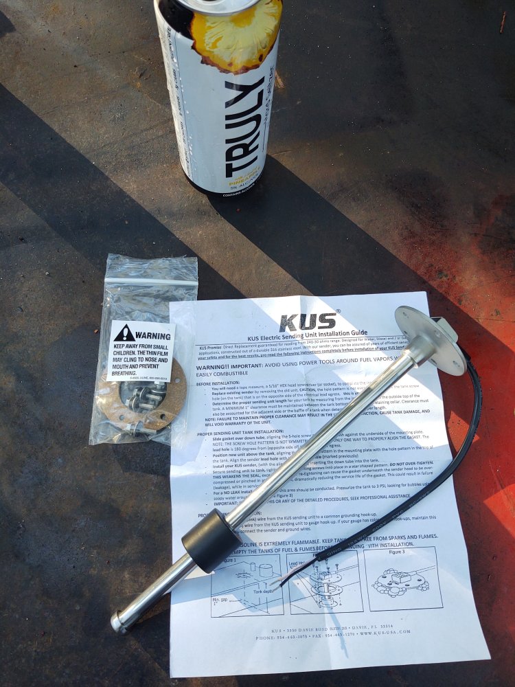

I wish lol. The stock TJ FLSU quit a while back. I'm still holding off for a full custom stainless cell I'm planning on starting soon. Already got a price on Argon. Literally, the only thing I'm missing is some 308L filler and a tank of Argon from being able to build it right here at the house. I'll be using this FLSU in it, which is compatible with the ohm reading for the guage, and is the right depth for what my finished cell dimensions will be.
New dimensions will be 12"x12"x35". I haven't calculated the gallon capacity yet but it's better than what I currently have.

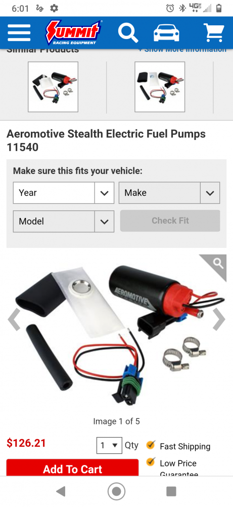

I've also since ditched the Walbro 255 for an Aeromotive, which has proven to be a far more reliable pump. I have no issue at all with an in-tank pump.

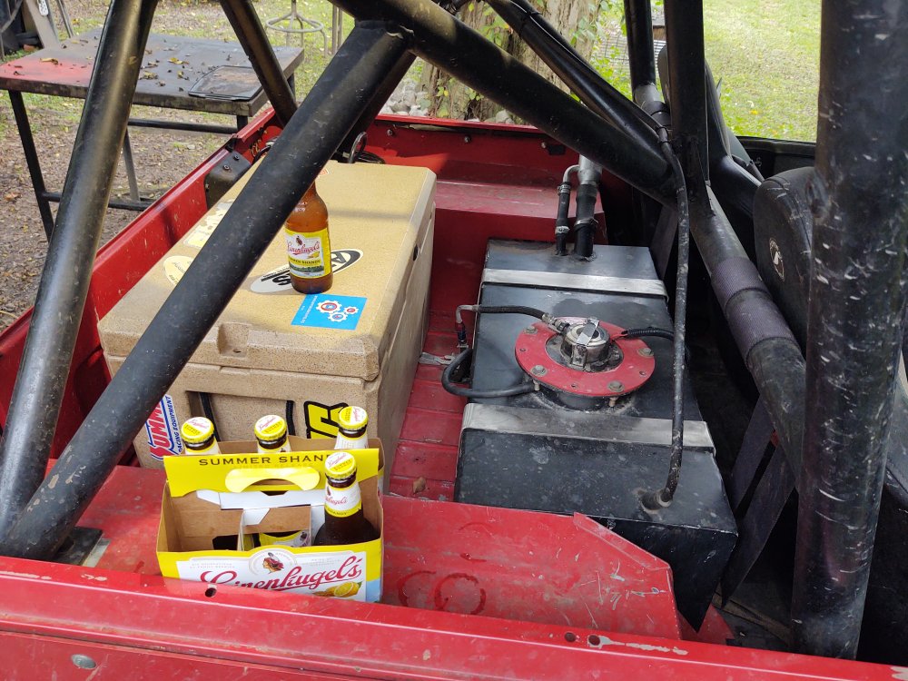

I've also since ditched the Walbro 255 for an Aeromotive, which has proven to be a far more reliable pump. I have no issue at all with an in-tank pump. View attachment 327282View attachment 327283
That’s roughly 20 gallons if my math was correct! ;)
