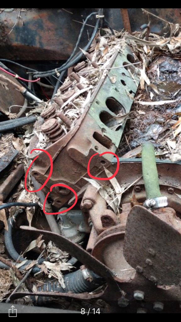

that Velle is 100% mine, just a matter of getting it drug to my house. As far as what's in it I'd like to keep the powerglide, if that turns out to be what it is. As far as identifying an engine by looking at it, I'd spend more time on Google than I would pulling it. Since I know you have the capability, knowledge and recources to do something with it, I'd make it more than worth your time to drive down and pick it up. Just give me a few days for it the end up in my driveway. I can photo verify anything you need to see on it.

;) I might know a thing or two, if that is a factory engine for the car. If it is in fact a 72, chances are pretty good that it's a 396 or a true 402. I was going to say it looks like a Chevy II to me, but couldn't quite tell from the pics. Could quite possibly be backed by a 'glide as well. The shape on the end of the cylinder head points to a 396, but the only way to really tell is by the casting number on the back of the block on the drivers side next to the distributor hole. You could also find a stamping on the head deck on the front passenger side (that exposed area of the head deck in front of the cylinder head). Those heads, I can tell you, are the large oval port, not the truck "peanut port" that was widely used on truck 454s. You could make a nice strong mill easily with what sits in there with so much as a valvetrain and intake swap.

Nova’s are not my cup of tea but I believe 73 was the introduction of the Hatchback. So it’s not a 72. Factory motors would have been 6cyl, 307 or 350.
Would be the last year of the power glide so that’s a possibility.
From the pic and accessory bolt hole orientation or whatever there called looks like a 87< smallblock or could be a 66< big block. Good luck
