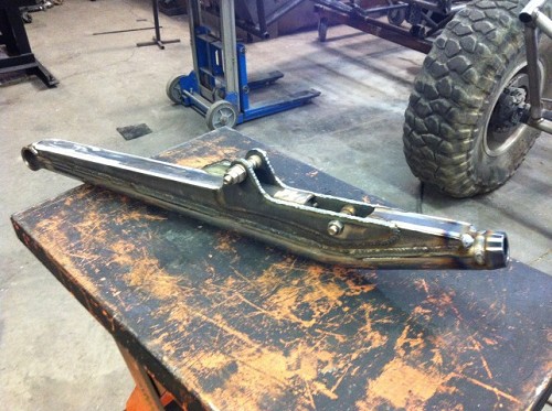

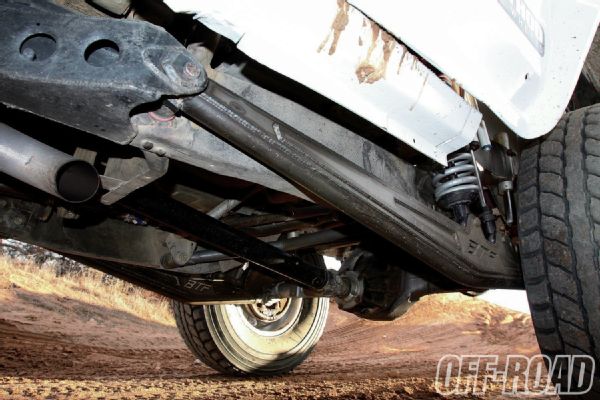

you can build trailing arms for approx the same cost as your lowers. They are just typically straight or only slightly triangulated. While a fabricated arm might be best, you can also just use tubing. You can put a bend in the tube where the shock will be, so that the lower shock bolt is below the link centerline, or you can keep the control arm straight with tabs welded on top, and use bushings or wobble stoppers on the shock to keep it from rotating. Then run a bushing on the frame side of the control arm.
Here are the different options:
use wobble stopper on shock eye for this:
Bent bar with a brace like these:
btf-trailing-arms-installed

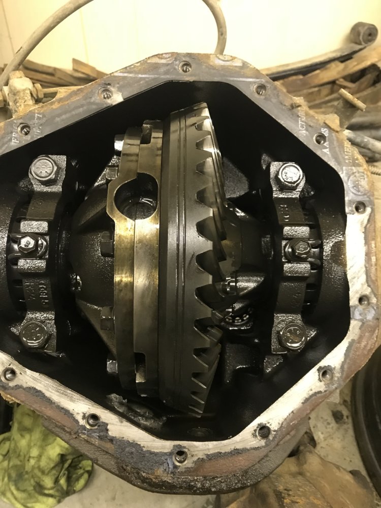

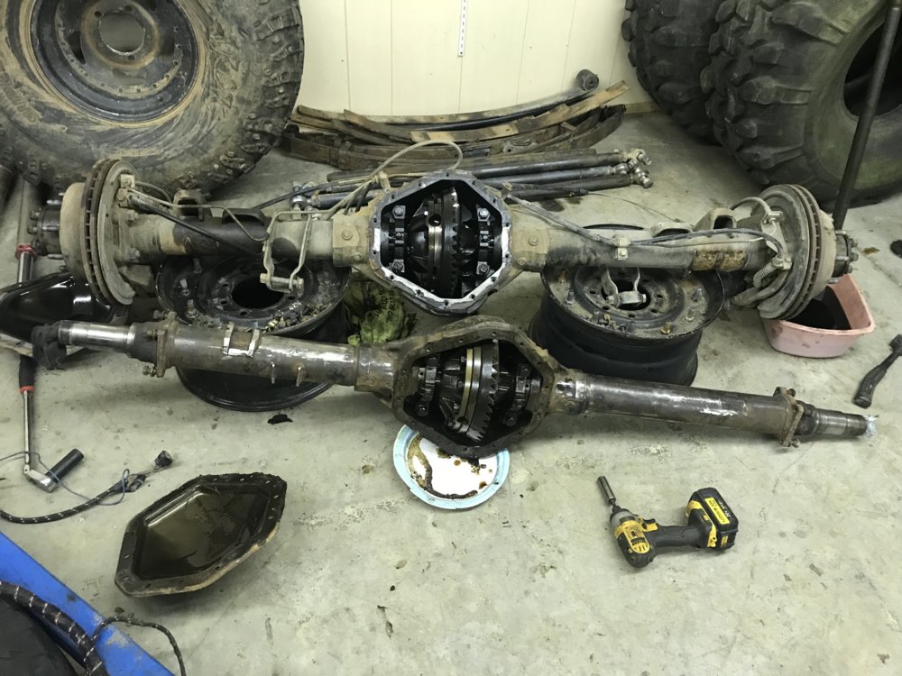

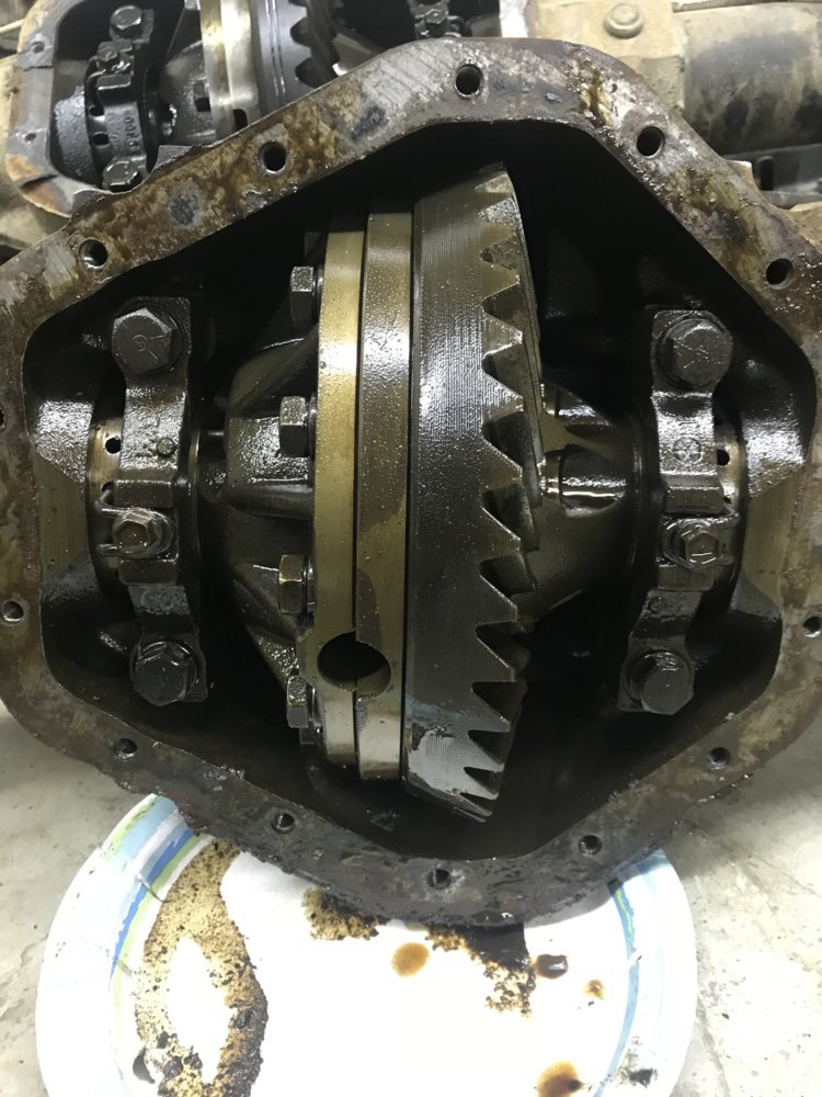

Picked up a 2005 14 Bolt with factory disc brakes, e brake, and 4.10’s, but didn’t think to check if it was a gov lock carrier.
It was.
I thought, no big deal, I’ll just use my ‘78 rear end...
Well, it’s a gov lock as well apparently.
I learned the hard way.
I guess I’m looking for a spool or open carrier now...
just curious what's wrong with a gov lock?
You can weld them from what I’ve read but,
In their stock form they only lock when the wheels slips at a high speed so they tend to explode.

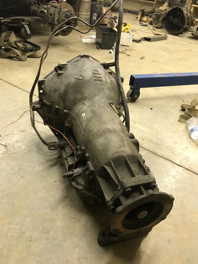

Decided to go auto. So I picked up a TH400 from @S4Cruiser bolted to an old 6.2 boat anchor.
I’ve never messed with auto’s before but look forward to learning.

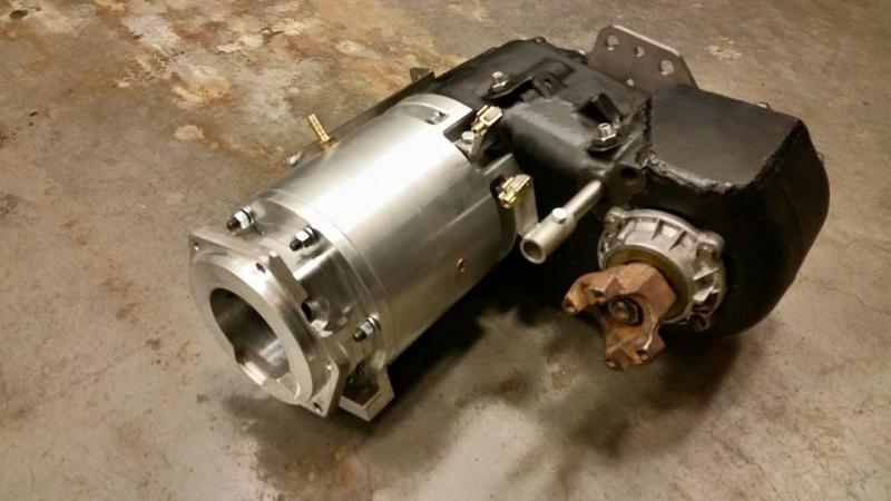

See pic.
This is what I’m going with. Not mine, just google image.

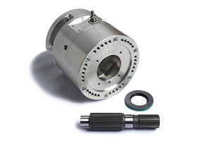

Sold 2 trannies yesterday so I’ve got some more $$.
Eco box should be ordered this week.
Going to call NWF to talk to them and make sure I have everything figured right.
It’s my understanding that the eco box will bolt to my stock transfer case adapter on the TH400.
NP205 should Bolt to that.

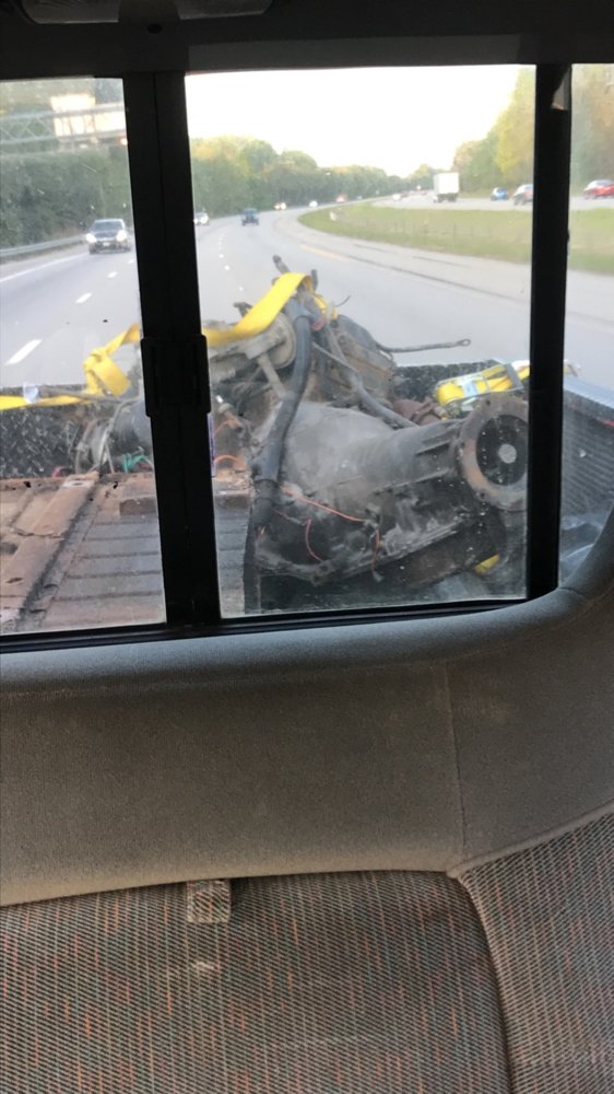

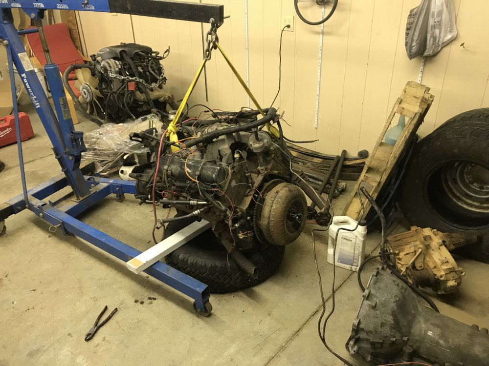

Got the 6.2/400 unloaded and separated.
I’m nervous about the auto.
Not sure what I need to do to it, but that’s what the internet is for I guess.

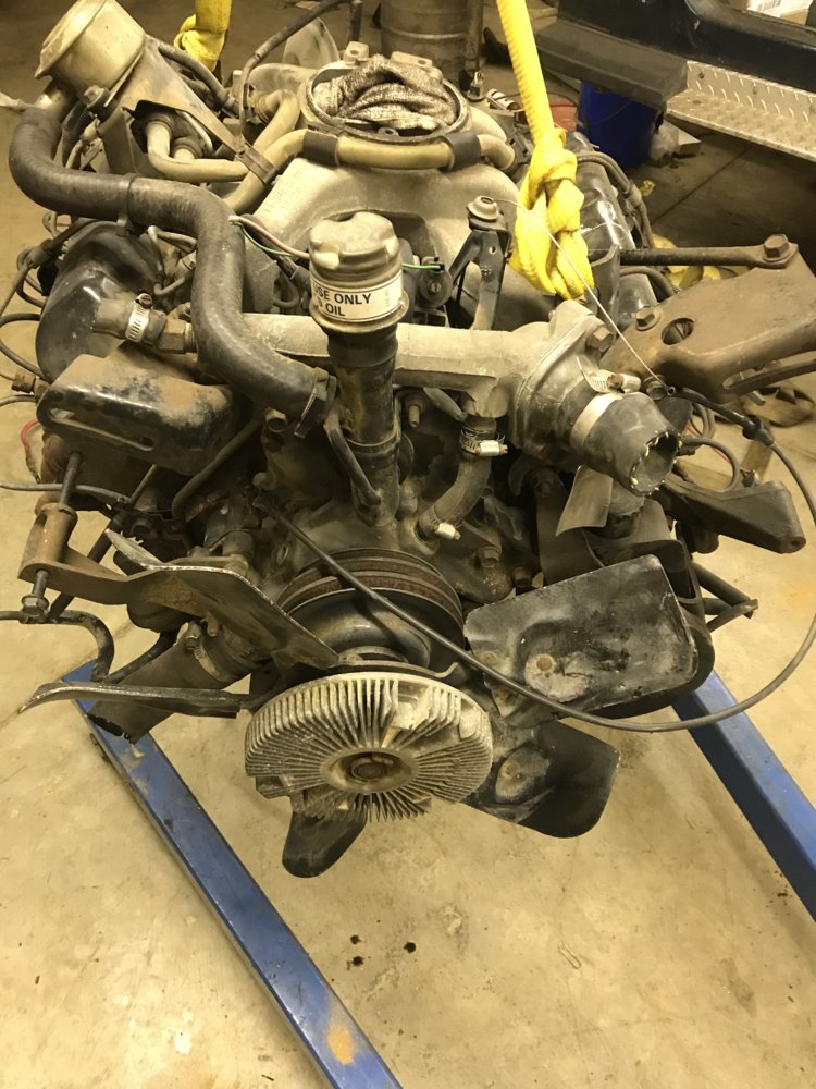

Is there anything I can use off this 6.2 before I sell/scrap it?
Torque converter, flywheel, sensors,etc??

I have no experience with this, but I would think the torque converter would be different from a diesel engine to gas engine. I would go with a new torque converter.
6.2 Chevy engine? I’ll take the whole thing if you’re scrapping
Yep, I’m gonna try to recoup a little $ from what I paid for the combo, so I’m gonna throw it on Craigslist. If it doesn’t sell, I’ll sell it to you for scrap price.
