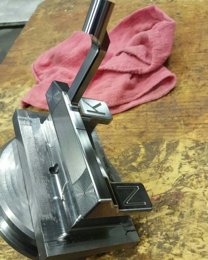

For you guys who don't use politicalbook and instascam I posted this video to show this sweet little tool I made to shape simple tabs I weld on chassis to hold wires and plumbing. They form a V with holes in the ends to run zip ties through.

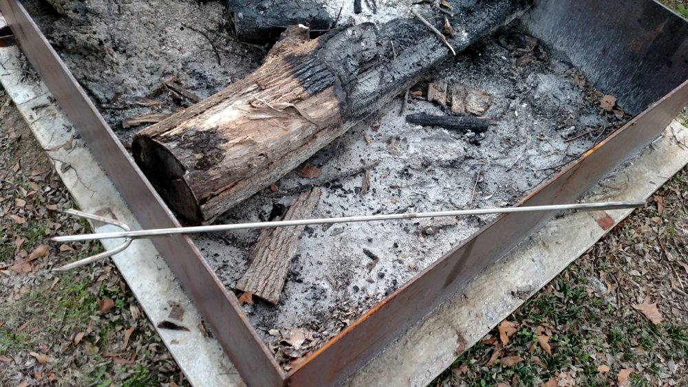

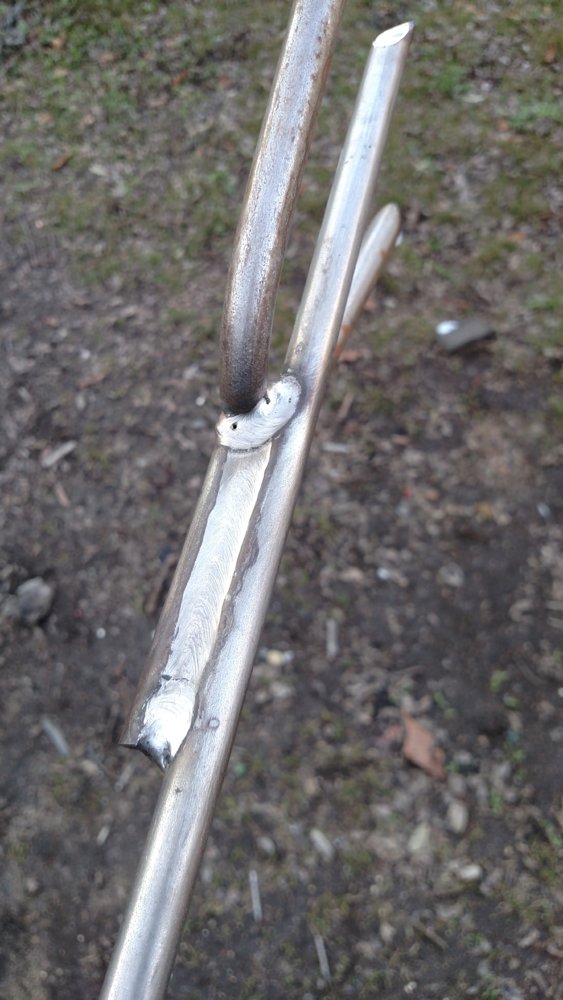

Pretty random, but I wanted to make a long handle fork to go along with the fire pit project in the backyard. Something sturdy enough to flip an entire rack of ribs without getting the eyebrows singed off. Stainless it is.

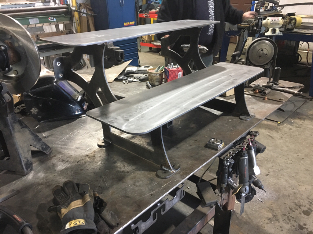

Hm I think depending on price and if the legs can come off to make it easier to get in an out of places. You might even be able to do it as a DIY kit for some people.

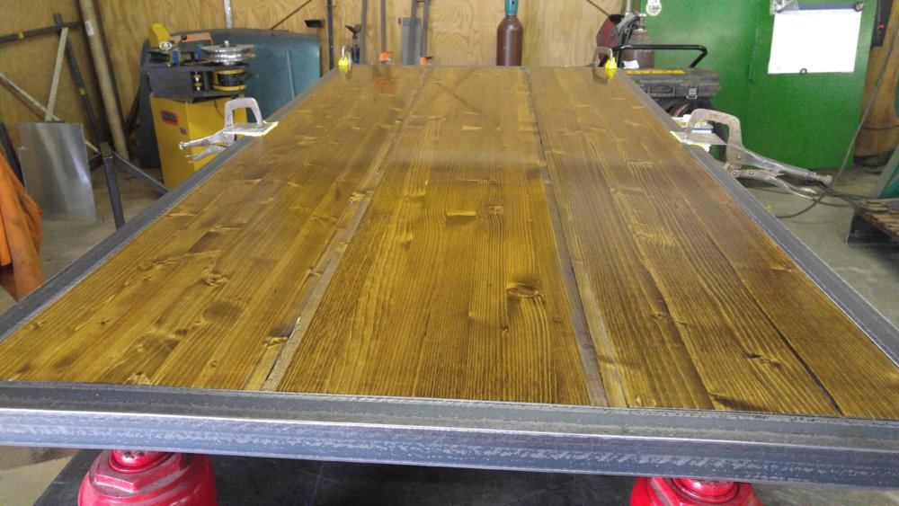

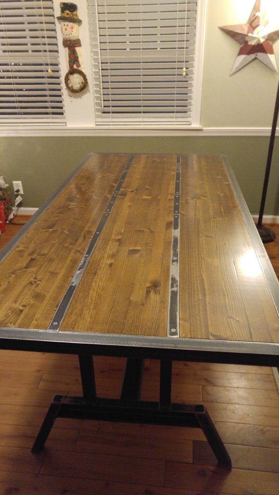

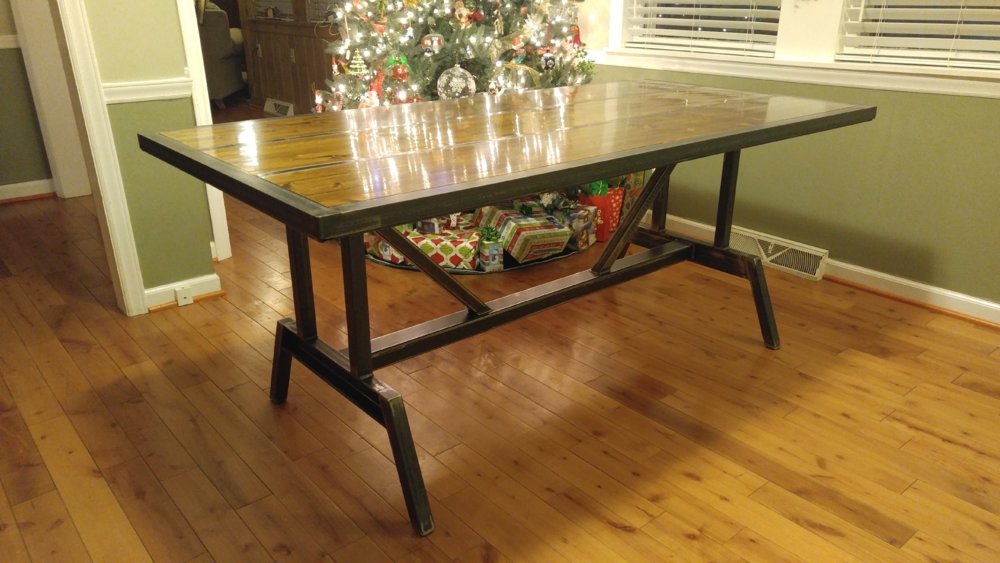

@WARRIORWELDING How did you fasten/capture the boards in the table? What did you finish it with to keep from rusting?
Top comes off one piece. Bolts on its 36x72.
Underlying frame hidden with the angle frame. Fasteners thread into it, no nuts or exposed thread to poke you. I keep it wiped down with linseed oil and turpentine. Last several months. Used it on other art.. Doesn't change the finish texture or peel like clear coat on varying prep surfaces.
