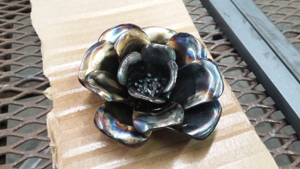

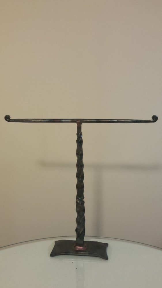

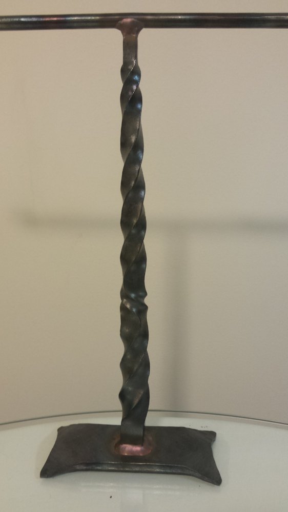

Just finished up another necklace hanger as a Christmas present for my mom. Made a few improvements over the last one.

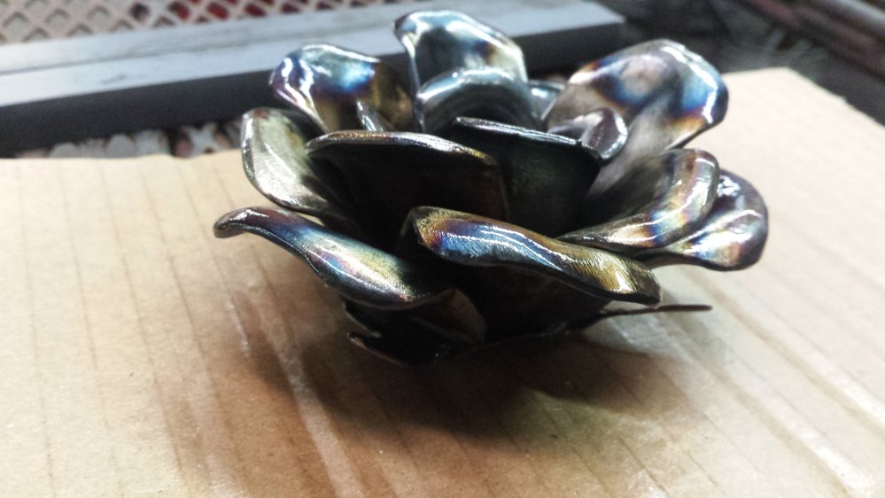

I like that flower! More details.
Thanks!
I used various widths of 1/8" flat bar, then ground them to get a rough pedal shape. The rest of the shaping i did with a small brazing tip and hammer in a bench vise with brass jaws. The center is a small piece of round soild with 3/32 filler rod welded to it, then balled the ends.

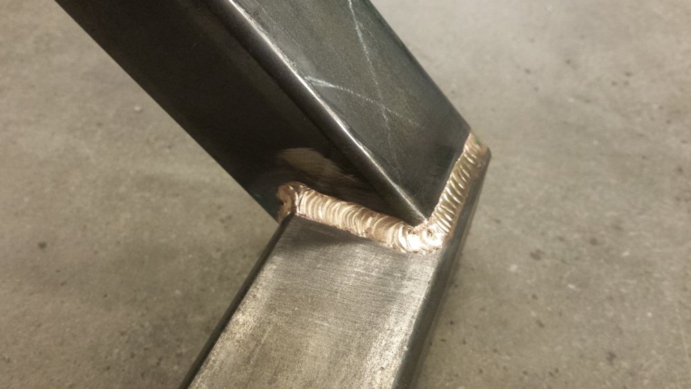

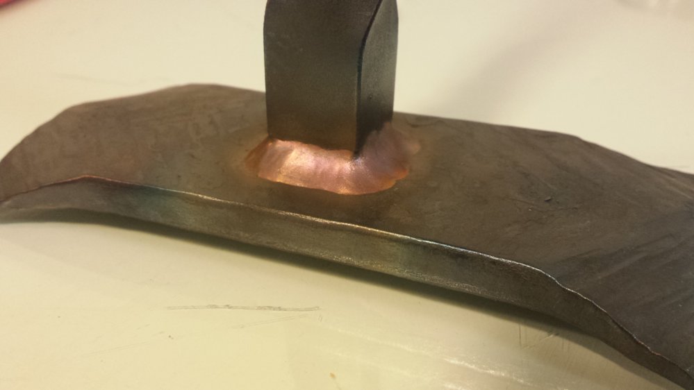

That's kinda dope! I like the design. Your idea? Why the sil-bronze filler? Just for contrast and reduced HAZ?
Yep, thanks!
And yeah the bronze is just for the contrast.

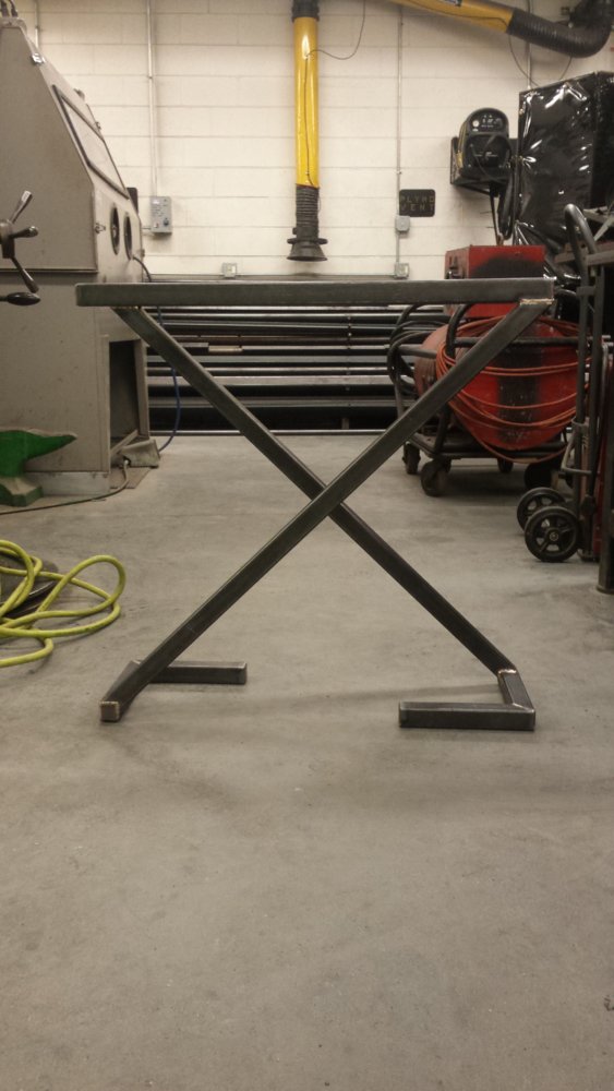

This was also kind of used as a test piece. we have a customer wanting a run of tables made out of the same materal using the bronze filler.

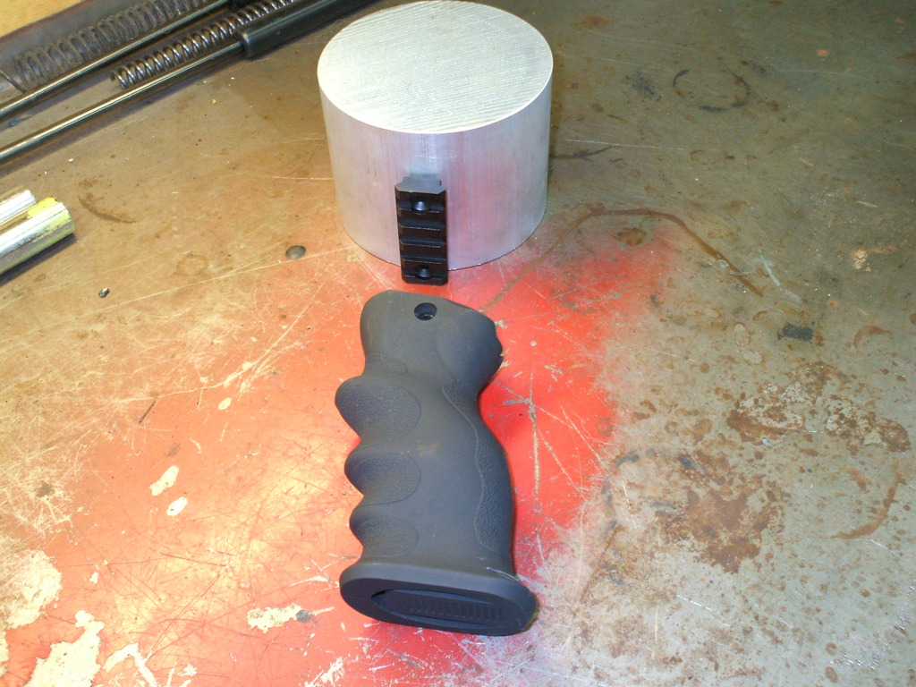

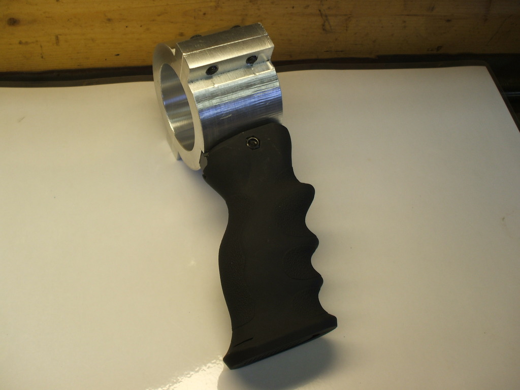

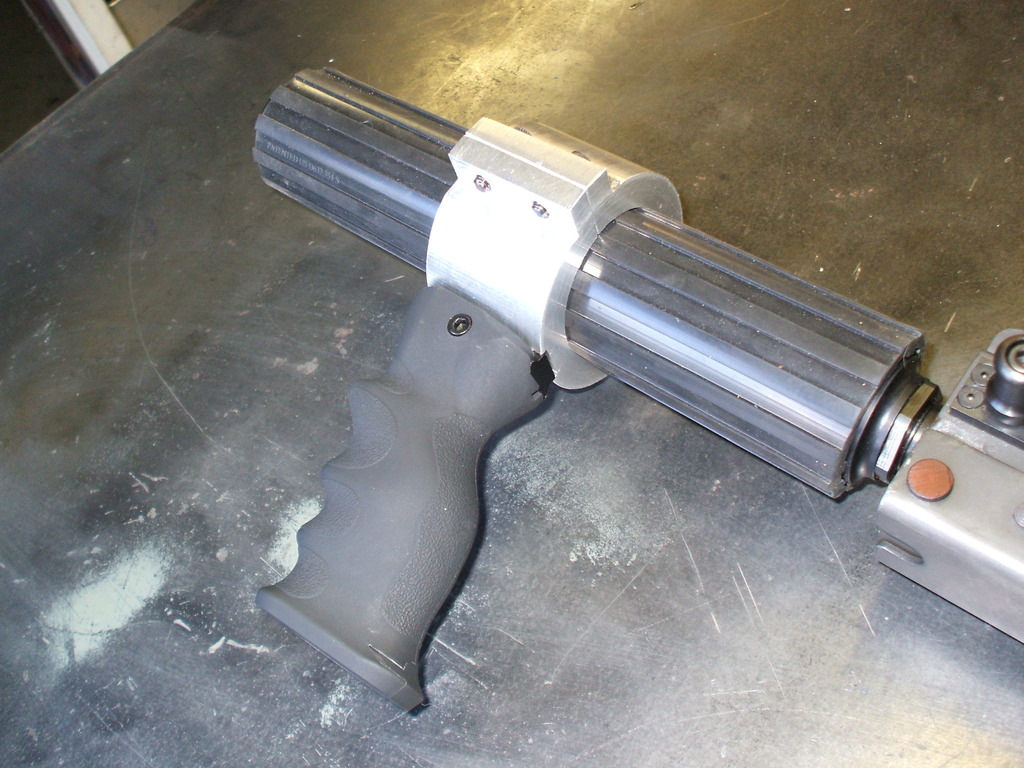

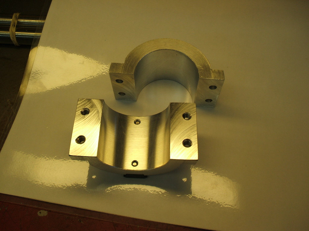

why in the world would you want to hold a can (barrel)?
