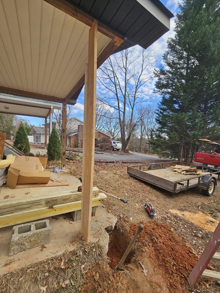

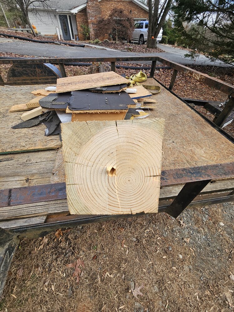

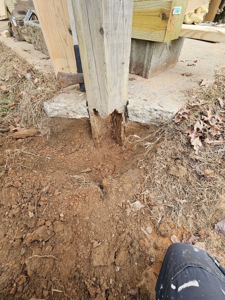

Is that PT?
Pretty sure what's left is PTIs that PT?
It looks like it was. I try to explain to people why I will not build with wood in the ground but they just don't get it. I have rotten ceder and creosote poles rotting in the ground here. I've always heard ceder doesn't rot..... Yea so about these fence post falling over....Pretty sure what's left is PT.....the middle, not so much
Here's what the rest of the post looks like......It looks like it was. I try to explain to people why I will not build with wood in the ground but they just don't get it. I have rotten ceder and creosote poles rotting in the ground here. I've always heard ceder doesn't rot..... Yea so about these fence post falling over....
Cover it back up
Just needs more cement!Cover it back up
I'm no expert but to me it looks like the PT either wore off if that is a thing or didn't penetrate well.
