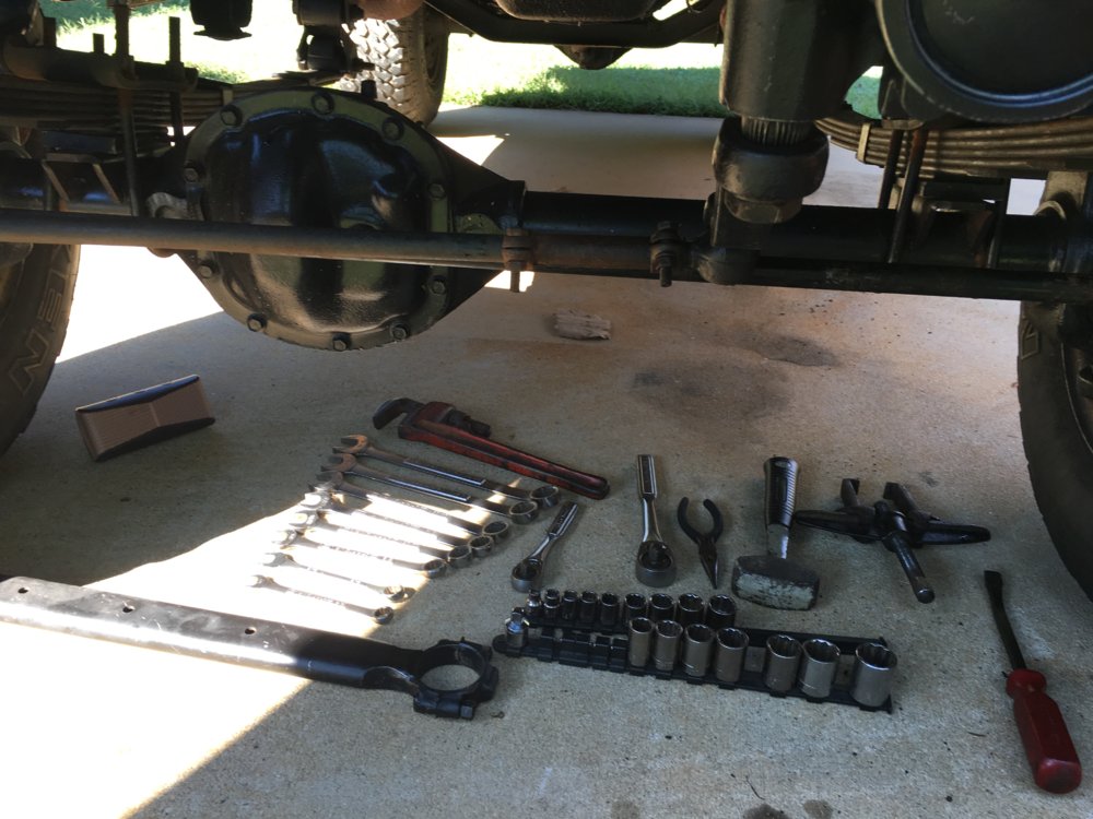

Your not too OCD or you would have replaced the 3/8- 9/16 sockets missing off the front socket holder.View attachment 228881 Finished installing a new steering gear box and realized I'm starting to get a little OCD about my tools as I get older.

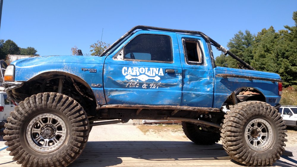

Actually both rear lowers are designed with the bend in them for clearance. Due to their length, they would be susceptible to bending. So they were made by sleeving .250" inside of .375 DOM and then heating and bending them.Would that be considered a positive arch on your rear lower link??
You reinforced them, but now they're definitely easier to bend because you've already put a bend in them. You've pre-buckled your lowers...![]()
Yep and I'll accept that in the name of better clearance with such long control arms.
Can't win 'em all!
Can't win 'em all!
Going from memory here, but pretty closeFor the sake of science; How long are your links, both front and rear?

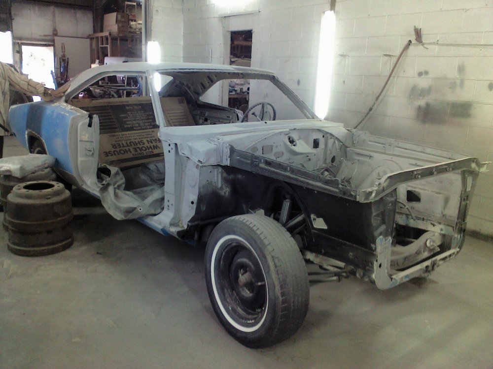

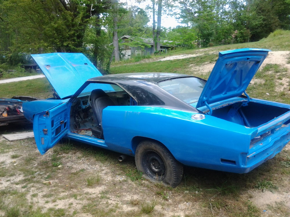

....(whisper) already have the doors, front fenders, hood....still searching bed sides....That's what @mcutler 's Comanche is going to look like in a year or so from now. But that guy will hunt all over the southeast to find new sheetmetal that's faded just enough to match the originals.![]()
