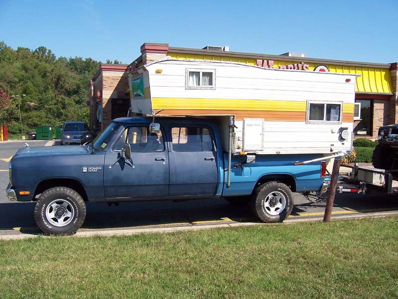

Well after using my camper for a few years, it was time to fix the rooted wood areas.
My camper is a 1974 Cascade.
I got this camper for free.. I helped a buddy put an engine in his CJ and he gave me this.. It has worked great so far.. but it has seriously needed some work for a while.. so here goes.
This will be on going for a few weeks until I finish it.

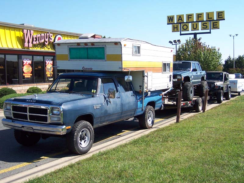

Here are pics of it being used for wheeling trips in the past.

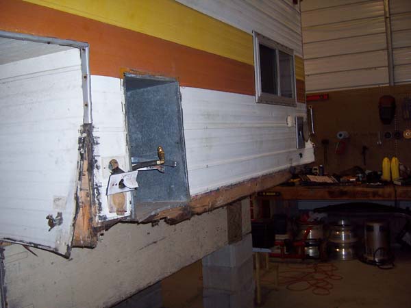

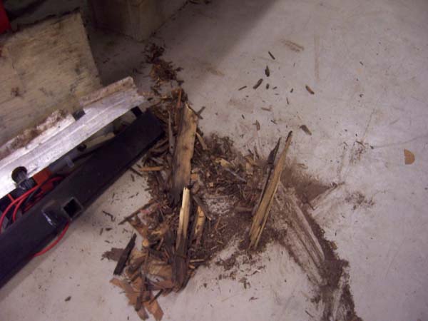

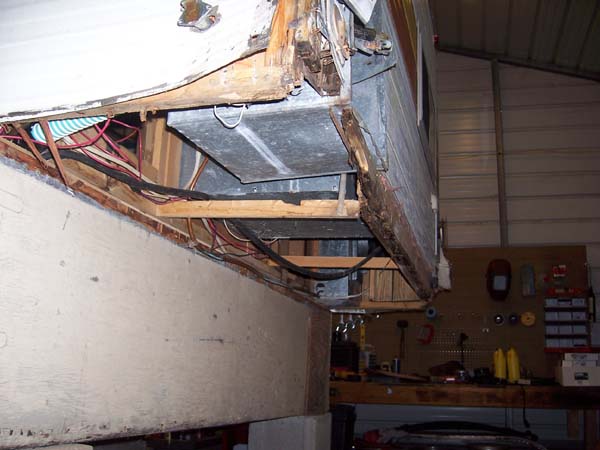

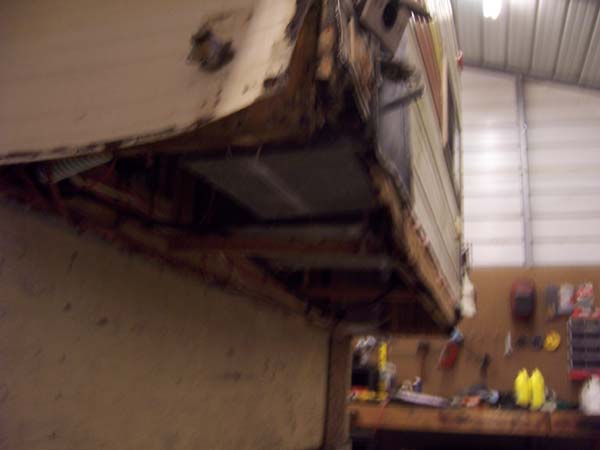

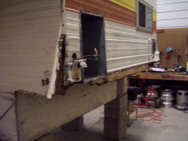

The main problem areas are where the jacks were mounted.. over the years water has gotten in and rotted the wood..
pics showing some of root

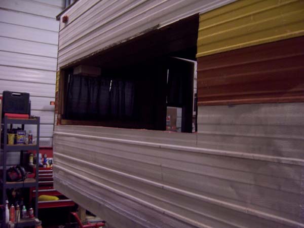

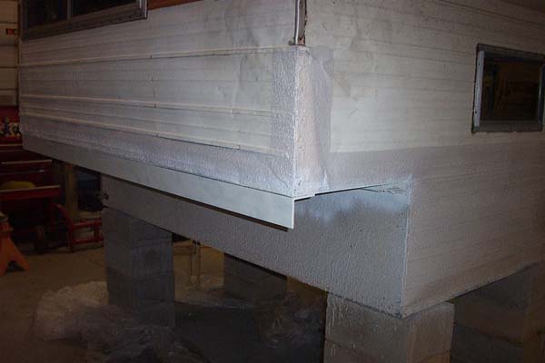

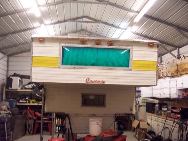

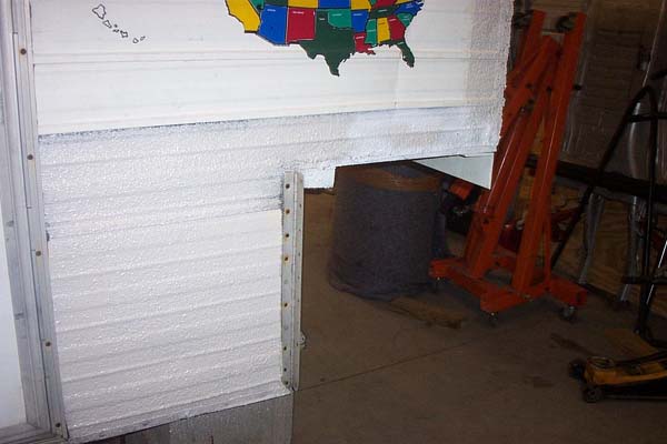

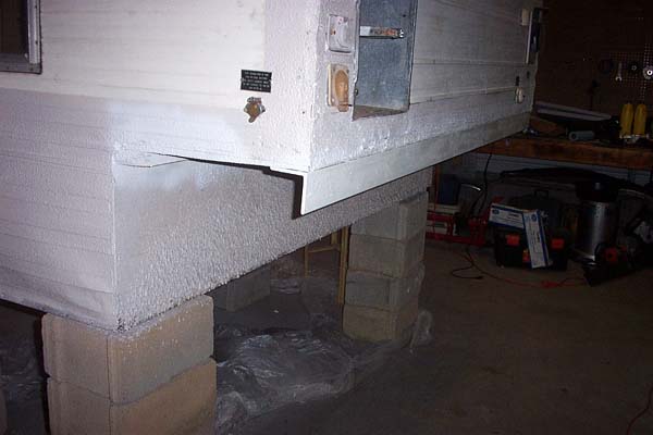

After I ripped apart both sides I replaced the 1x2 and 1x3 main supports then layed the plywood up in place and braced it.. once that was all done I put all the exterior paneling back on.

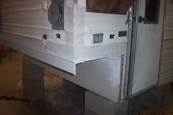

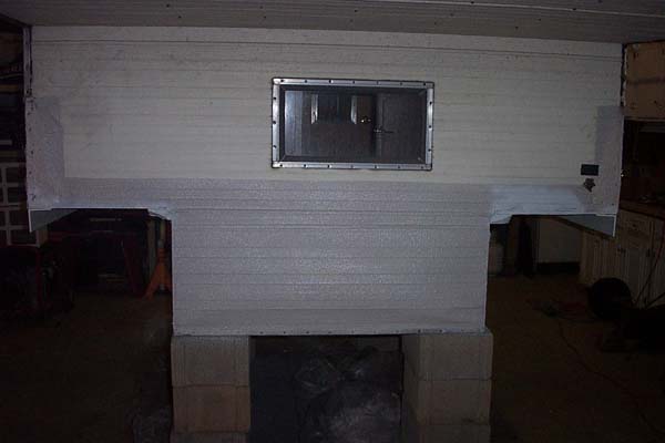

and I have been trying to figure out the best way to seal the wood and new stuff.. I contacted Blaze and got some Al's Liner.. ( I got white)..So I taped off the top of camper and sprayed all the new wood and about a 4" strip around the sides.
After that I took some angle iron cut it to lenght, then Drilled holes in it so I could attach it to the new wood. I am trying to make better supports for the jacks and by running the angle iron it will spread the load along the entire camper.. not just the corners.
YOu can see the difference from bedliner vs not

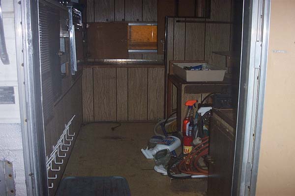

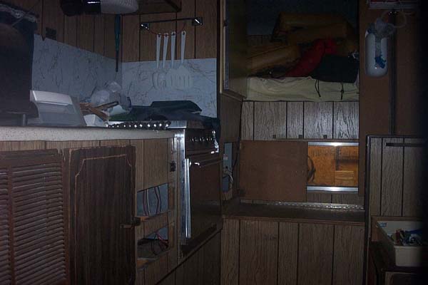

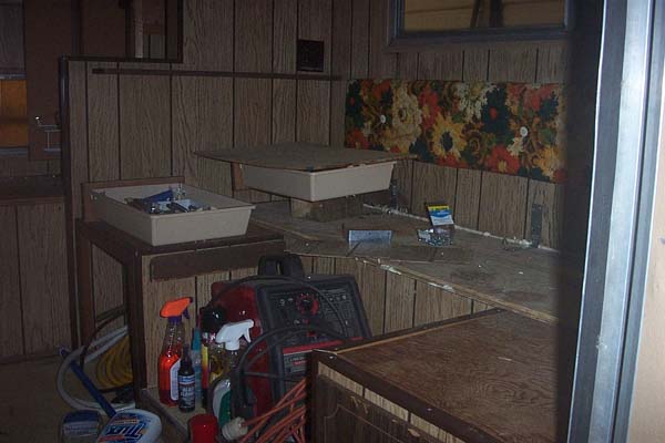

next is to get the jacks mounted back up.. then attack the inside.. it is time to update the inside.. needs some paint, some new wood, new floor, etc...

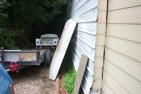

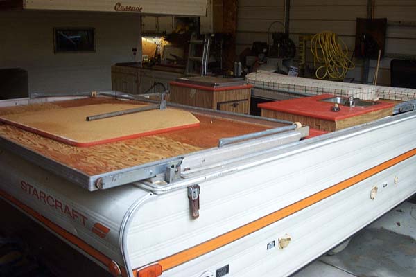

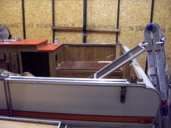

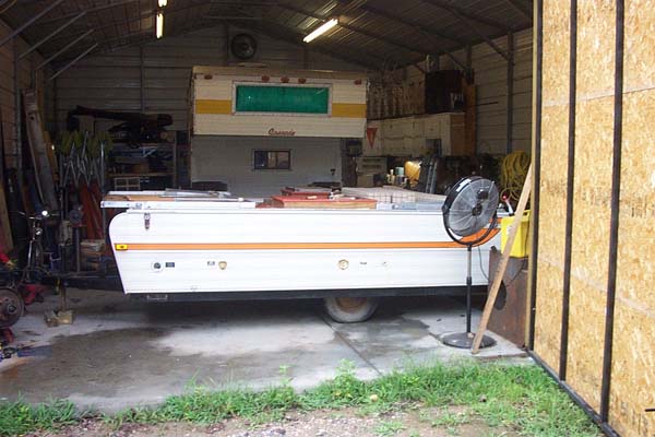

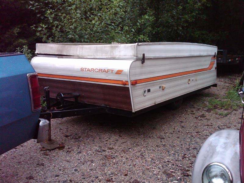

Well I found a cheap parts camper on CL.. so I brought it home today and put it in the garage.. soon these two will become one :)
1976 Starcraft
Camper in garage
roof was destroyed so I took it off
Roof next to the garage

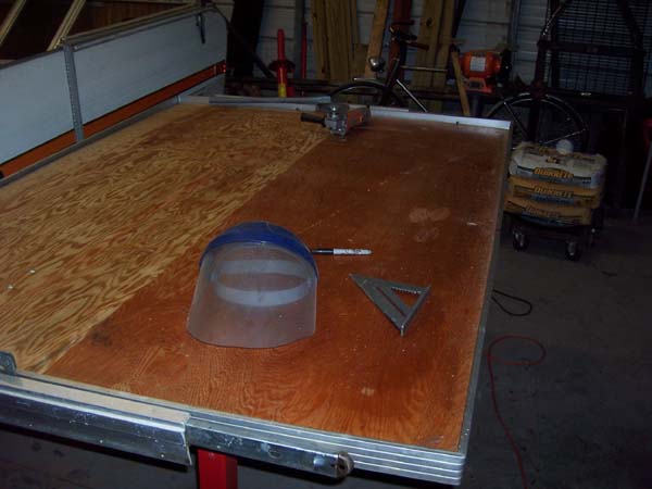

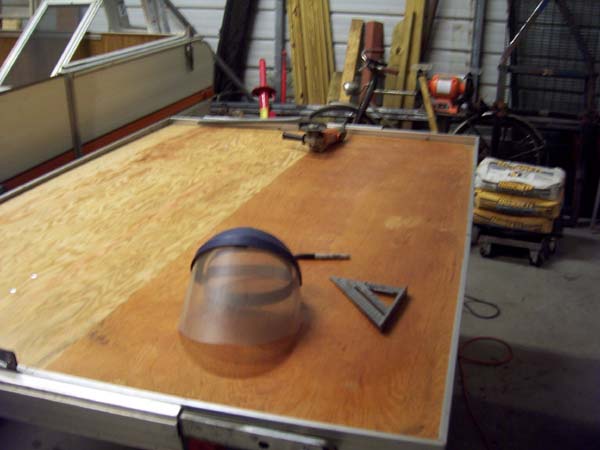

well took some measurements last night of pop up slide and then interior of bed camper.. and it will work.. but I need to shorten the slide to fit and keep the bed camper strenght.. so tonight we start cutting and fitting :)
BRUISER
silent.. but deadly
Moderator
Mar 17, 2005
Raleigh

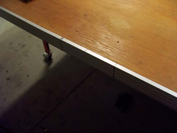

Well Jph0913 came over to give me a hand and make sure the camper did not fall apart on me :)
we tore apart the pop up and took the slide off, then took a bunch of measurements and cut it up to make it a little smaller :)
