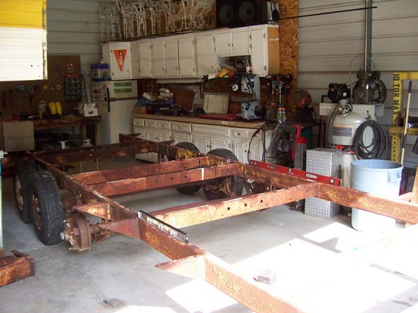

here is axle with weird pattern.. it says Dexter on them.. and was told they are either 5000 or 6000lb axles
[/QUOTE]
I think those are camper axles,used in the 70s I think,try looking at an RV dealership.Maybe they can help you get some info on them.

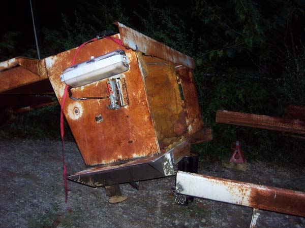

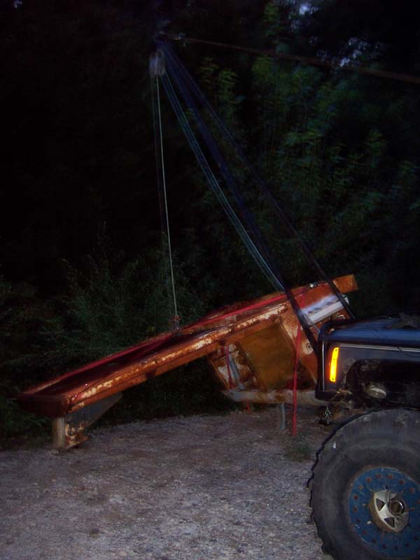

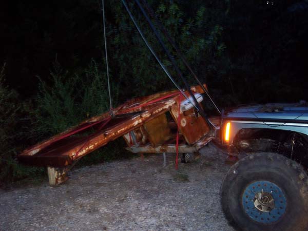

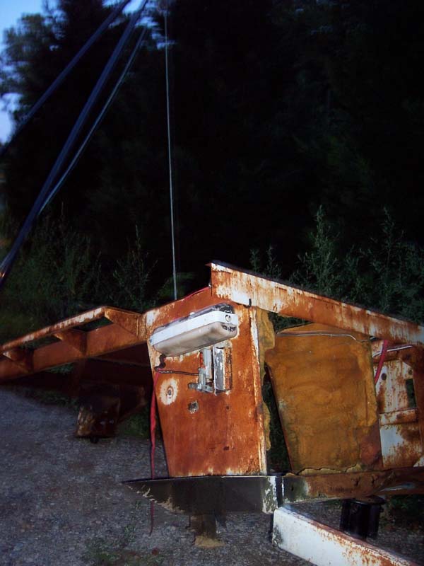

it came with a 5th wheel hitch.. and we found a bunch of cracks in steel.. so it is easier just to cut it off and build new.. So I am building a gooseneck setup.

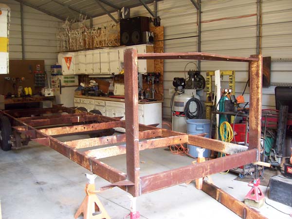

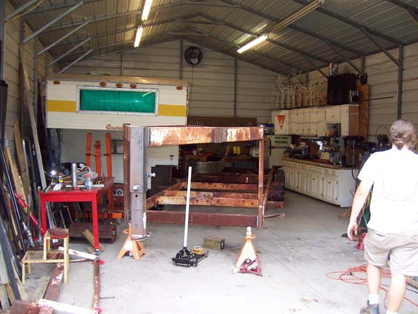

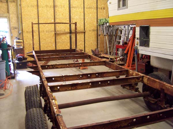

Well got trailer into garage.. ( that was a pain)
and started on gooseneck

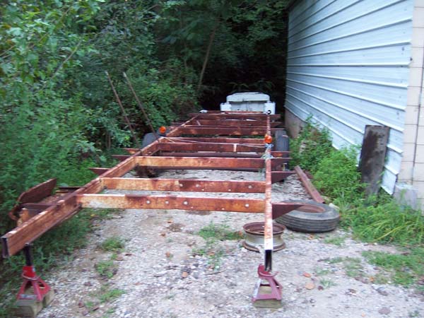

trailer on side of garage with front and rear cut off
trailer in garage

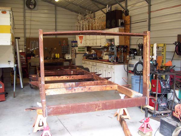

front started
tomorrow I start on horizontal bars and gooseneck coupler

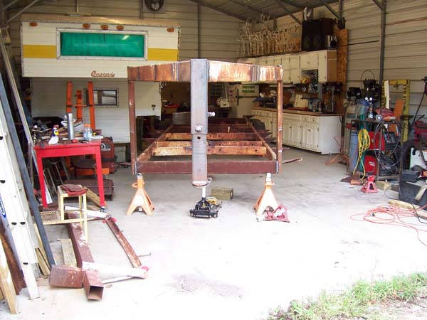

Well great news..
we got the front all welded up and on.. so I could actually move the trailer with my truck right now if i need to.
everything is level and true :)
we also backed truck up and set height of gooseneck coupler. Next is to get front jack mounted so I can raise the trailer without floor jack. then start on extra supports and deck

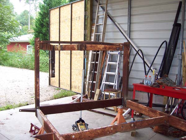

well I had to modify the support bar, then I washed the old canvas(still needs more washing) and then got it up and tested it to see how it will fit..
It is not perfect but to me it is not worth the money to have it cut down to fit perfect.. maybe down the road if it works out good in the long run.
